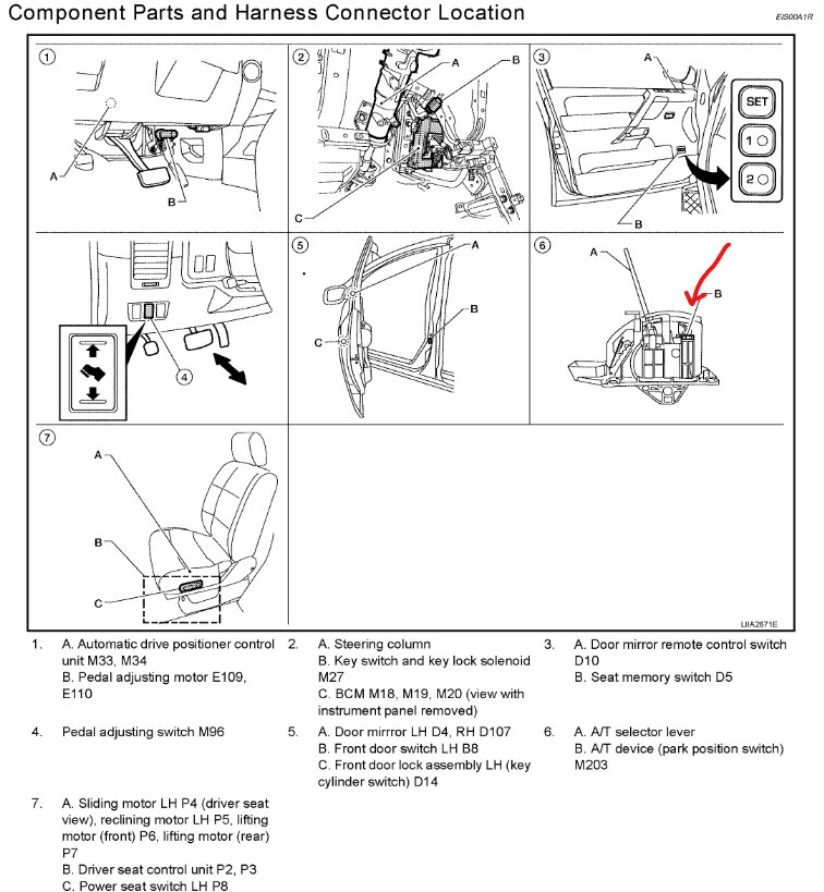

The P1707 code refers to the Park/Neutral Position (PNP) Switch Malfunction. So this will cause the transmission to have issues. I don't see the turbine sensor code which is:
P0715 - Input/Turbine Speed Sensor Circuit Malfunction
P0716 - Input/Turbine Speed Sensor Circuit Range/Performance Problem
P0717 - Input/Turbine Speed Sensor Circuit No Signal
P0720 - Output Speed Sensor Circuit Malfunction (sometimes mistaken for input sensor issues)

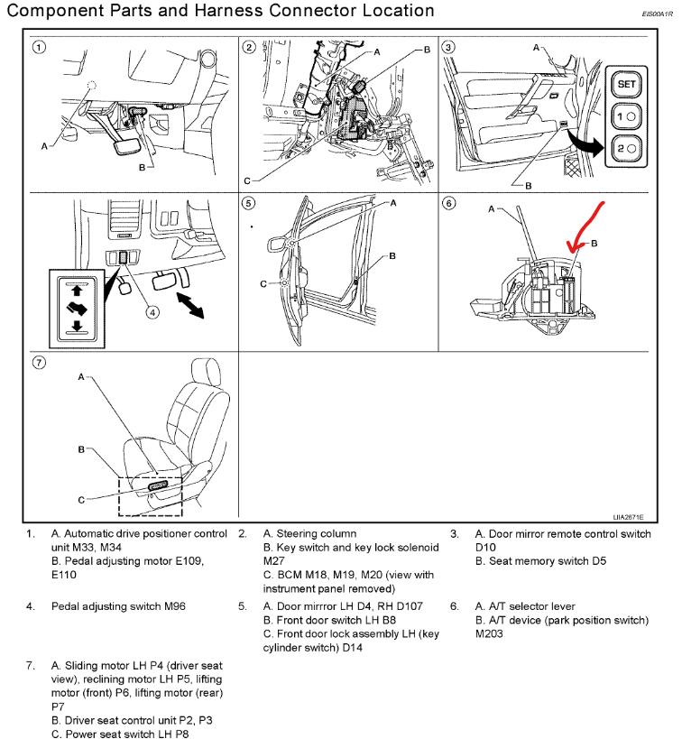

Here is how to change out the gear range sensor (Park/Neutral) which is inside the gear shifter. Clear the codes once the job is completed. Check out the images (below).
