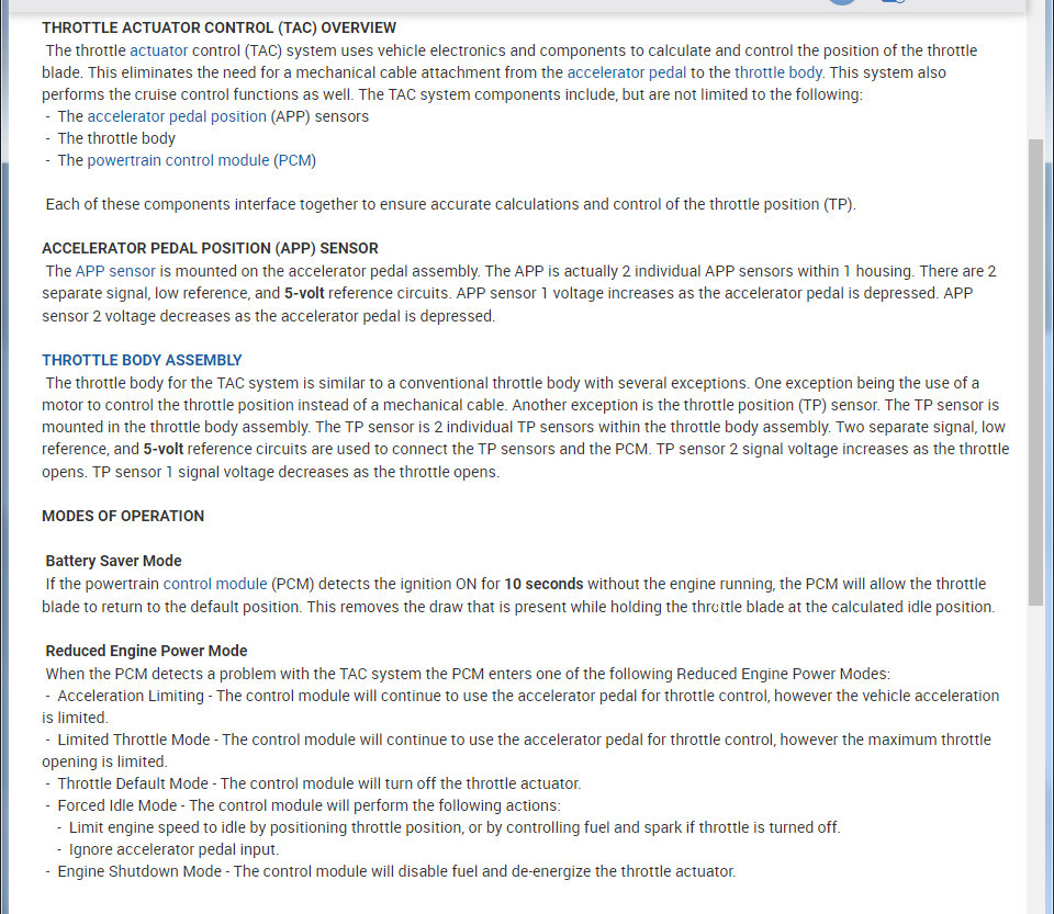

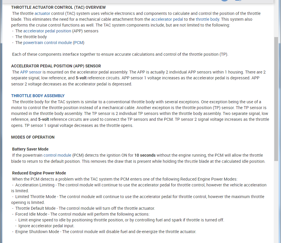

If not then I suspect we have an issue with this part. The accelerator pedal position switch is part of the assembly so it is likely that we have an issue with this system. If you notice in the attachment you will see where it can cause reduced power mode.
I would get this part exchanged if this started afterwards as it may be causing your reduced power.

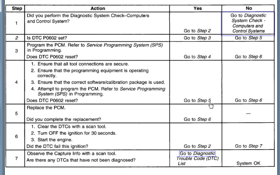

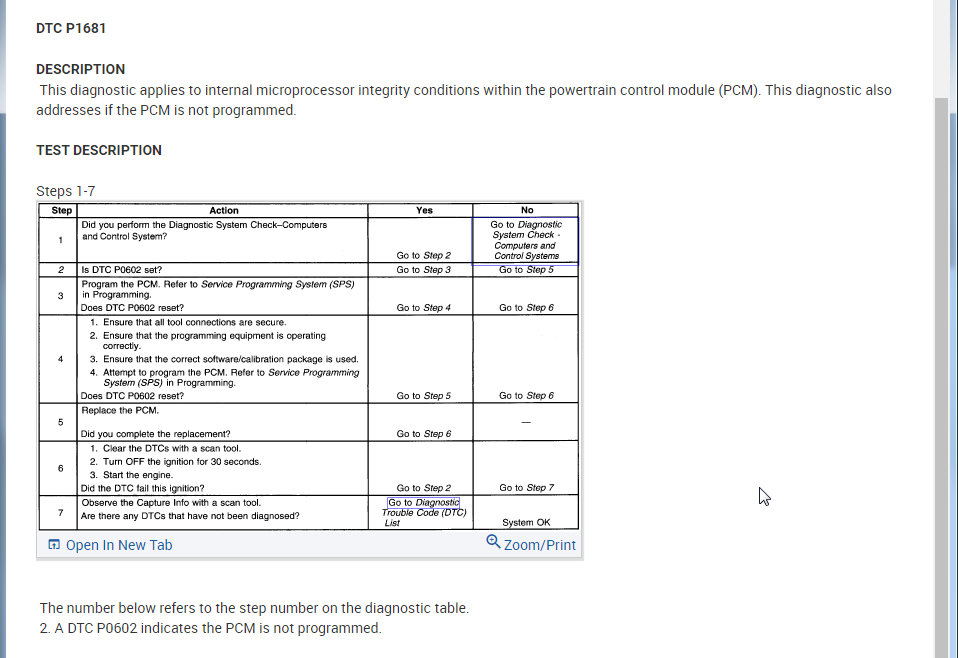

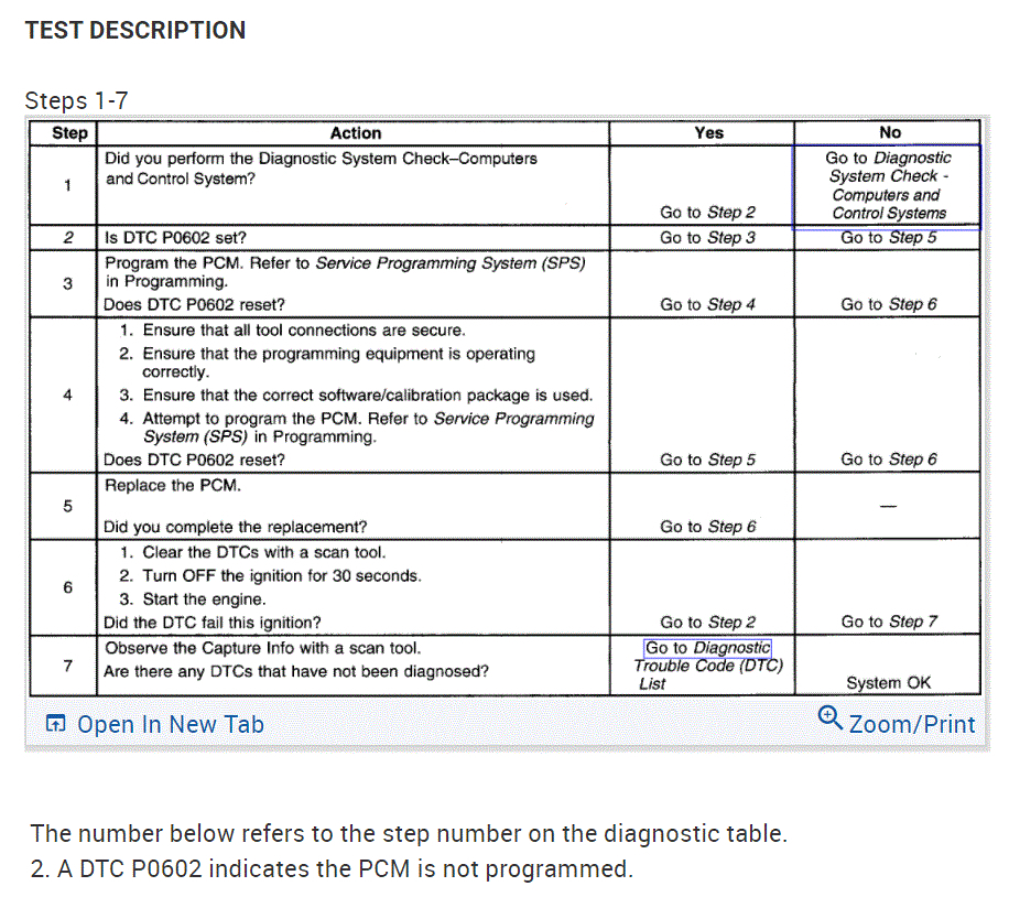

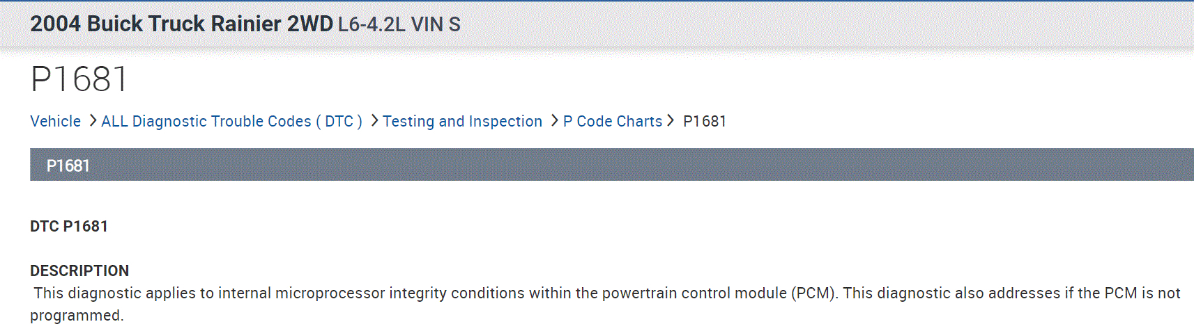

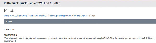

However, if this is the only code that you have then that is an internal PCM failure which would need to be replaced. Please see the attached info below for the detail on this code.
