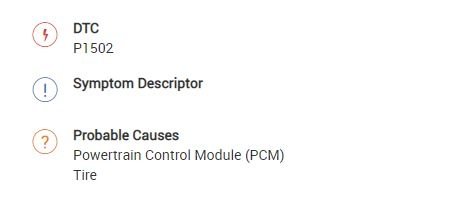

I keep getting a p1502 code, I've changed all wheel speed and vehicle speed sensors. i'm at a loss. checked a little for broken wires. Feels like transmission is having hard time deciding when to shift uphill between 45-55. Really jerks the truck.

Is the ABS light on as well as the check engine light? If it is not, then you need a ECM. The code is for both systems.

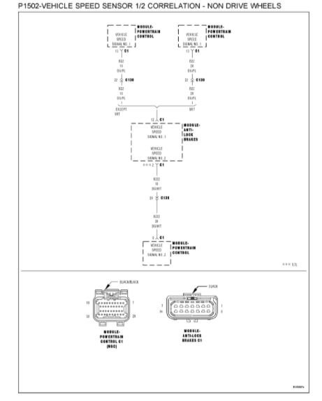

P1502-VEHICLE SPEED SENSOR 1/2 CORRELATION - NON DRIVE WHEELS
P1502 - Vehicle Speed Sensor 1/2 Correlation - Non Drive Wheels
WHEN MONITORED
Ignition on and vehicle moving. Cruise is learned and customer is trying to use the Cruise.
SET CONDITION
The PCM recognizes rear wheel speed is greater than front wheel speed.
POSSIBLE CAUSES
Vehicle speed signal circuits shorted to voltage
Vehicle speed signal circuits shorted to ground

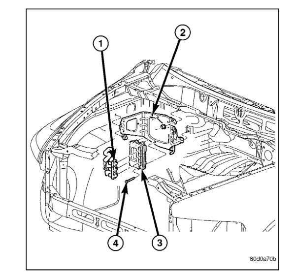

Certain ABS systems rely on having the Powertrain Control Module (PCM) broadcast the Vehicle Identification Number (VIN) over the bus network. To prevent problems of DTCs and other items related to the VIN broadcast, it is recommend that you disconnect the ABS CAB (controller) temporarily when replacing the PCM. Once the PCM is replaced, write the VIN to the PCM using the DRB scan tool. This is done from the engine main menu. Arrow over to the second page to "1. Miscellaneous". Select "Check VIN" from the choices. Make sure it has the correct VIN entered before continuing. When the VIN is complete, turn off the ignition key and reconnect the ABS module connector. This will prevent the setting of DTCs and other items associated with the lack of a VIN detected when you turn the key ON after replacing the PCM.
Use the DRB scan tool to reprogram the new PCM with the vehicles original identification number (VIN) and the vehicles original mileage. If this step is not done, a Diagnostic Trouble Code (DTC) may be set.
REMOVAL

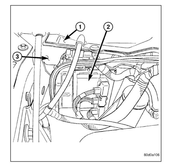

The PCM (1) is located in the engine compartment attached to the dash panel (3).
To avoid possible voltage spike damage to the PCM, ignition key must be off, and negative battery cable must be disconnected before unplugging PCM connectors.
1. Disconnect negative battery cable at battery.
2. Remove cover over electrical connectors. Cover snaps onto PCM.
3. Carefully unplug the three 32-way connectors (four 38-way connectors if equipped with NGC) from PCM (1).
4. Remove three PCM mounting bolts (3) and remove PCM from vehicle.

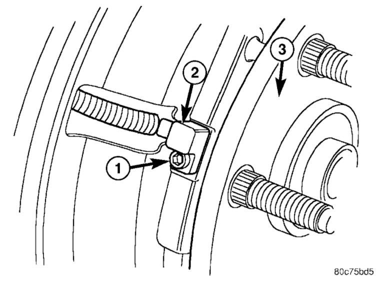

SENSOR- WHEEL SPEED-ABS-FRONT
REMOVAL
1. Remove the front rotor.
2. Remove the wheel speed sensor mounting bolt (1) from the hub (3).
3. Remove the wheel speed sensor (2) from the hub (3).
4. Remove the wiring from the clips and disconnect the electrical connector.
