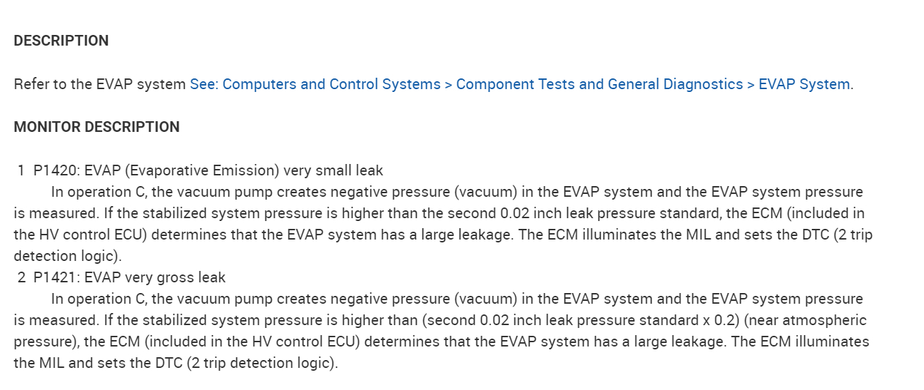

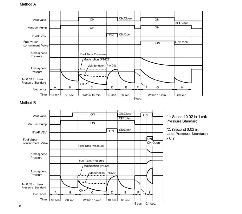

Hi, afternoon. Last weekend in my vehicles check engine light came on dashboard. Yesterday I took it to AutoZone and their scanner showed the Code 'P1420 Evaporative Canister Small Leak'. Anyone else had this issue before?
I don't know much about the cars beyond regular maintenance. Any information will be greatly appreciated.

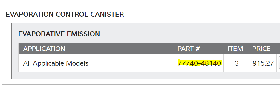

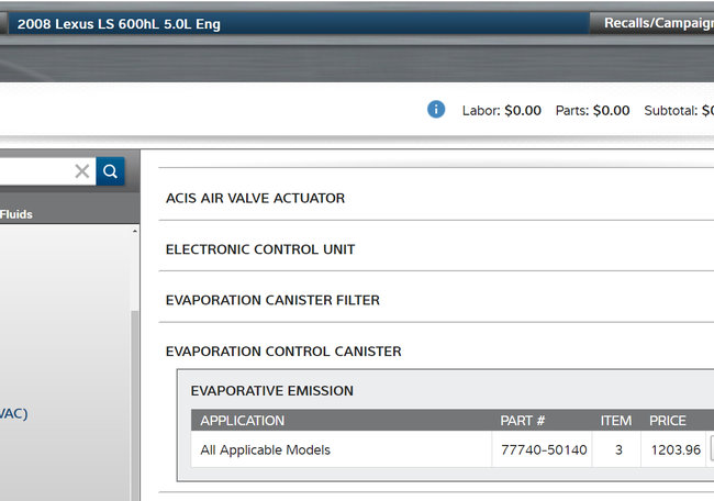

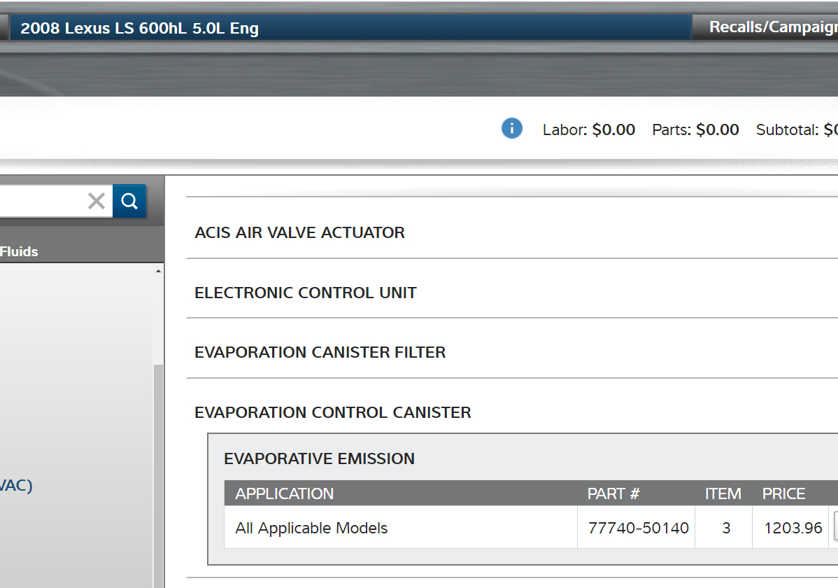

Is this an expensive repair? If charcoal canister damaged it same from lexus LS600hL?
Also, can I drive it with the warning light on for now? Or it is dangerous?
Thank you all in advance.
