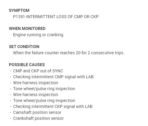

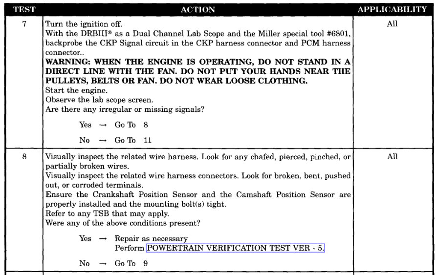

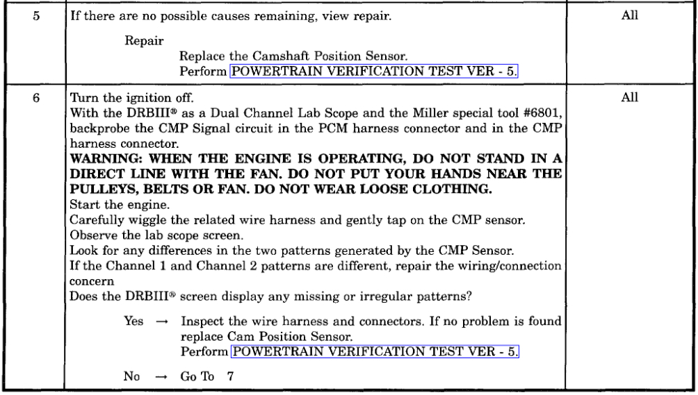

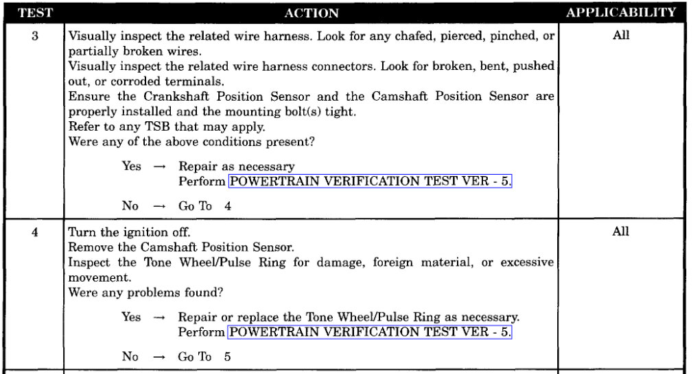

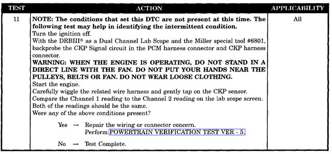

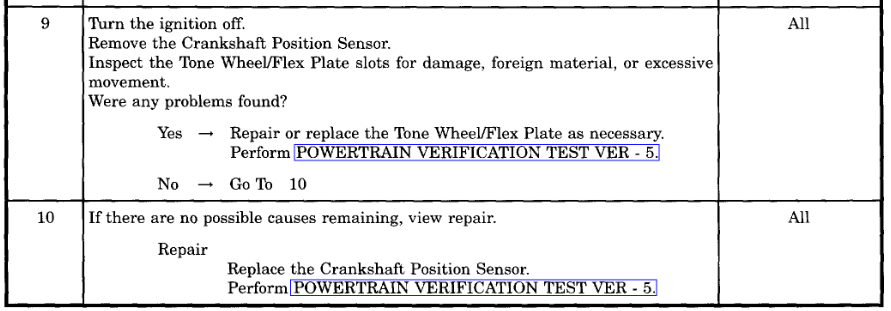

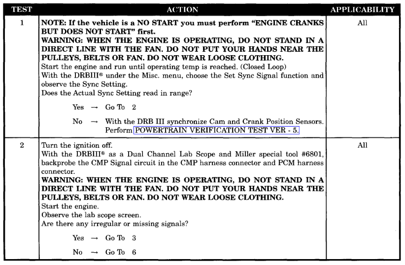

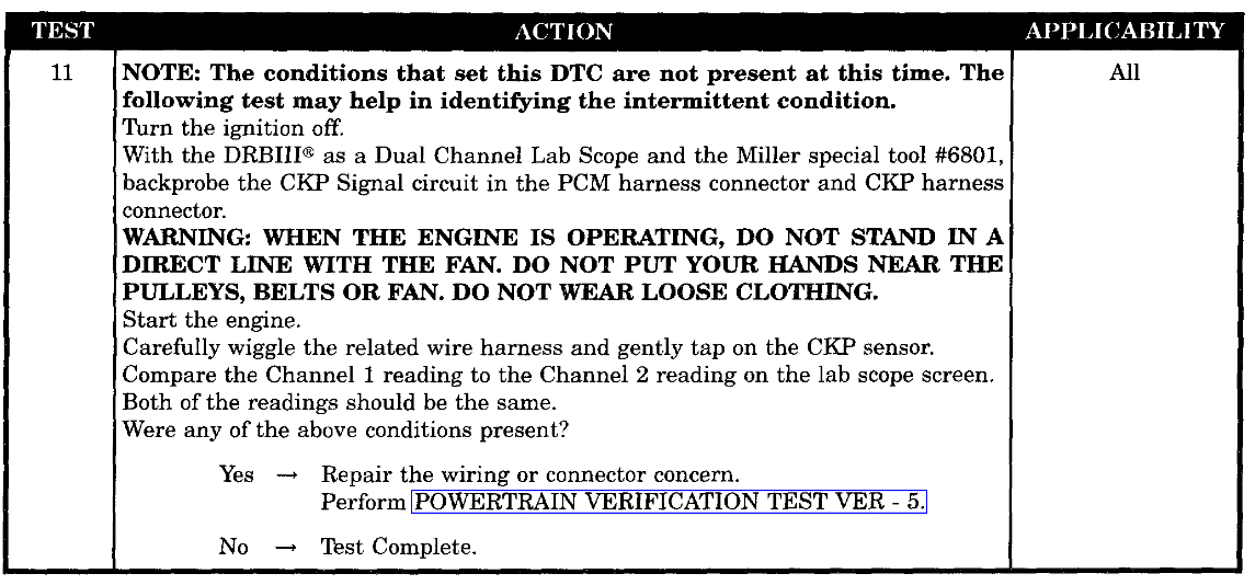

If you look below, I attached the diagnostics for this code. Take a look through them and let me know if you are comfortable performing them.
Let me know what you find.
See pics below.
