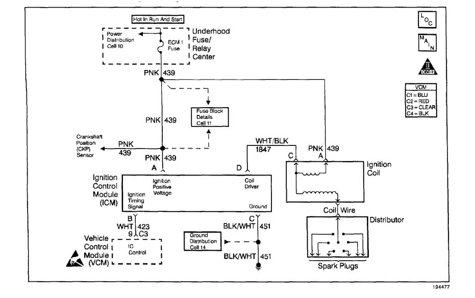

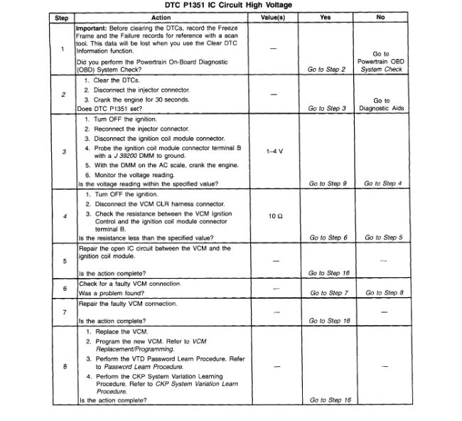

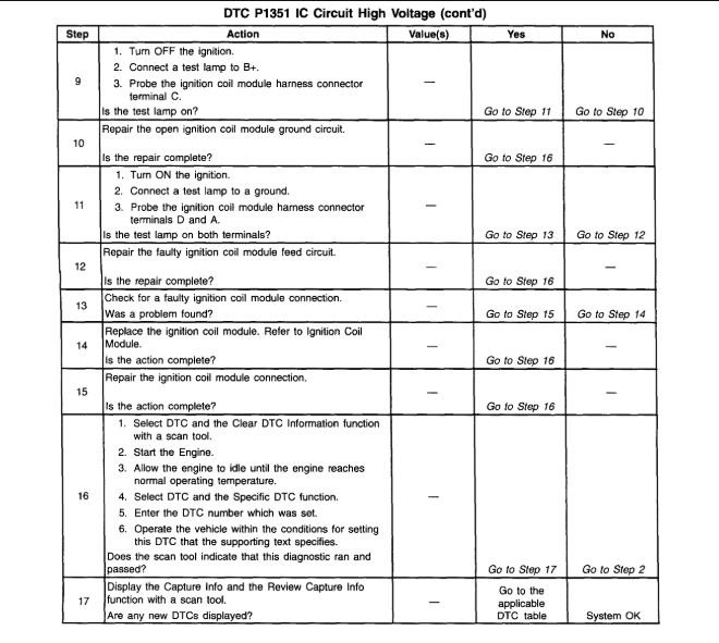

There is a lot to this code. I attached a flow chart for you to follow with the wiring diagram.
Let me know if you have any questions.
CIRCUIT DESCRIPTION
The enhanced ignition system uses the crank sensor in order to provide the timing input to the VCM. The VCM uses this reference pulse in order to determine the individual ignition spark timing for each cylinder.
Once the VCM calculates the ignition timing, the ignition coil module on the IC circuit receives the timing signal. Each timing pulse received by the ignition coil module on the IC circuit triggers the coil module in order to operate the ignition coil. The secondary ignition voltage is induced, and then the secondary ignition voltage is sent to the distributor for distribution to each spark plug.
The IC signal voltage ranges from about 0.5 volt to 4.5 volts.

Intermittent test - If the connections and the harness check OK, monitor a digital voltmeter connected between VCM terminal CLR 9 and BLK 18 while moving related connectors and wiring harness. If the failure is induced, the voltage reading will change. This may help to isolate the location of the malfunction.
TEST DESCRIPTION
The numbers below refer to the step numbers in the diagnostic table.
2. This determines if the DTC is an intermittent.
3. This check determines if the IC signal from the VCM is available at the ignition coil driver.
4. The remaining tests begin to check that the coil driver circuitry is OK.
