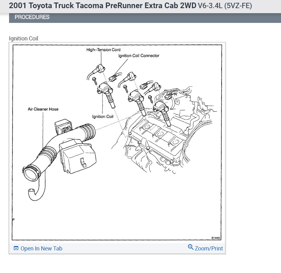

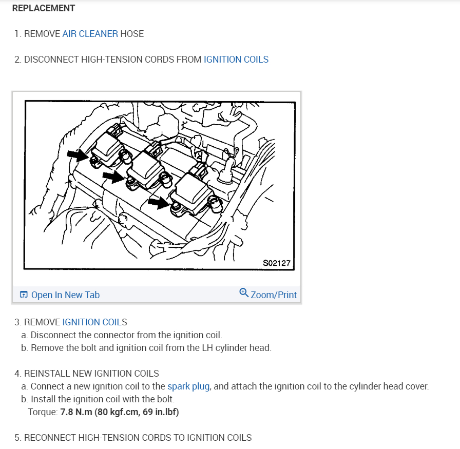

Here is how to replace the coils in the diagrams below and the video as well:
https://youtu.be/rU6uxV5dLoA
Check out the diagrams (below). Please let us know if you need anything else to get the problem fixed.

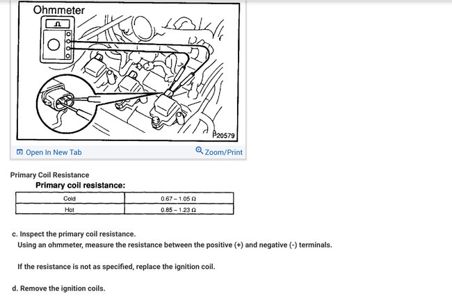

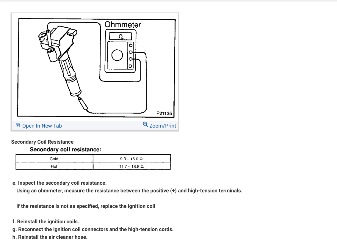

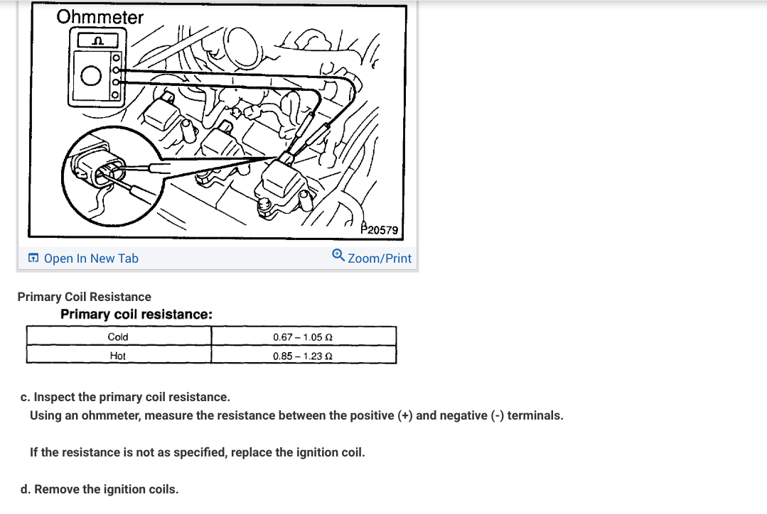

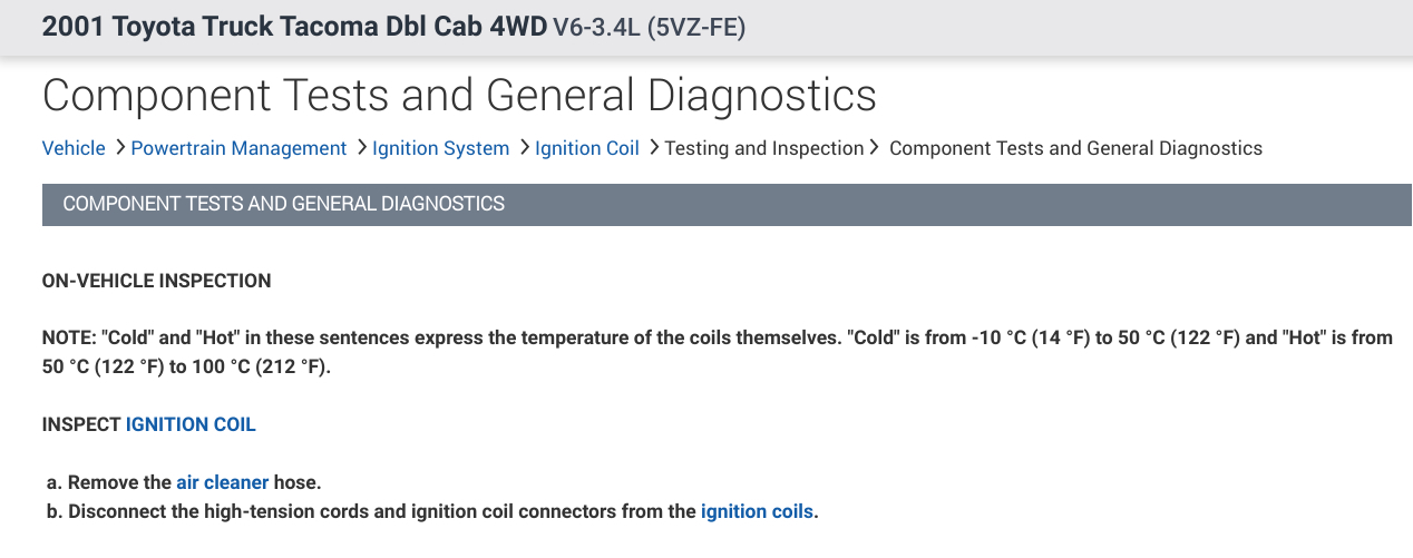

Hello again,
I'm sorry, I forgot to add this guide down below on how to inspect and test your vehicle's ignition coils. Please go through it and get back to us with the results.
Thanks,
Alex
2CarPros
