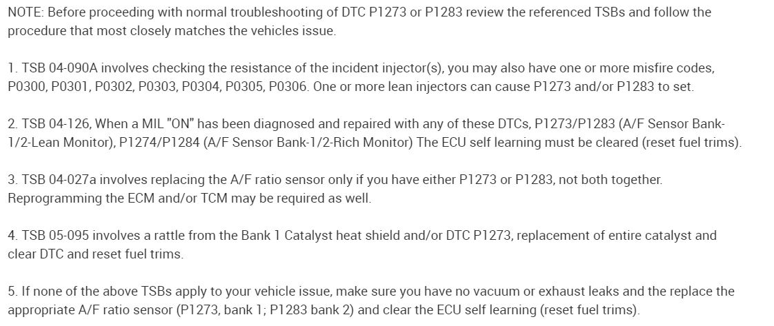

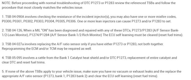

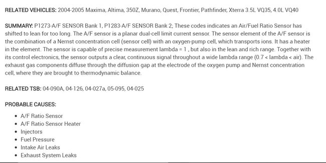

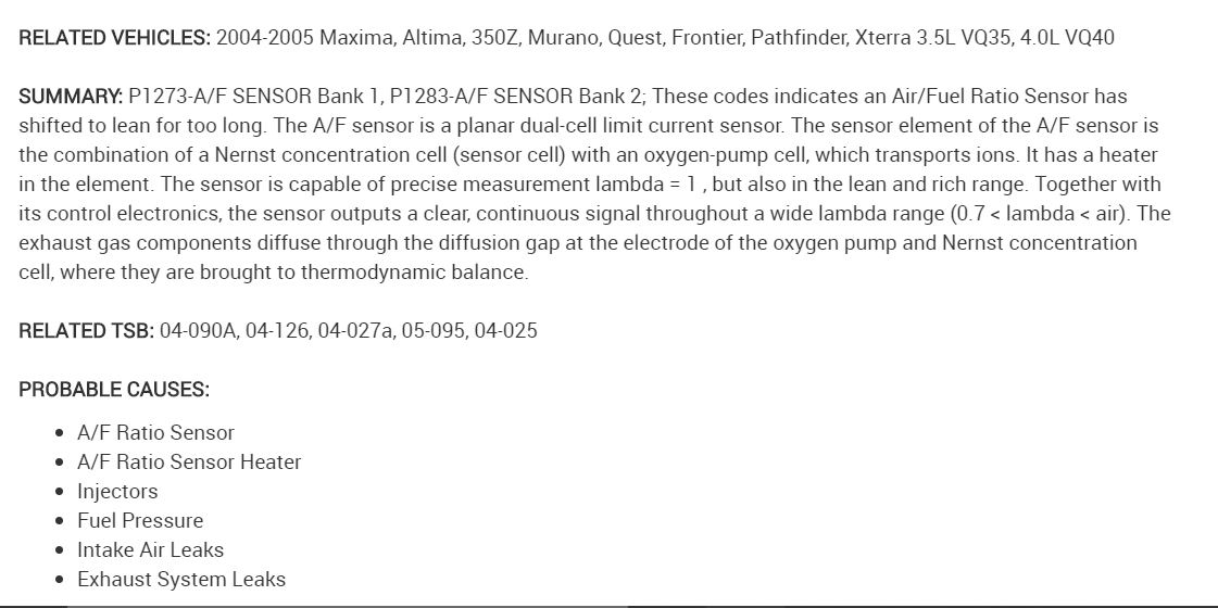

Do you have access to a scan tool that can look at a live data stream? Here is actually a technical service Bulletin on this issue. Also you may have just gotten a bad sensor, maybe try switching the 02's from side to side and see if the code goes to Bank 1 instead of Bank 2. If you get a P1273 that's bank 1.

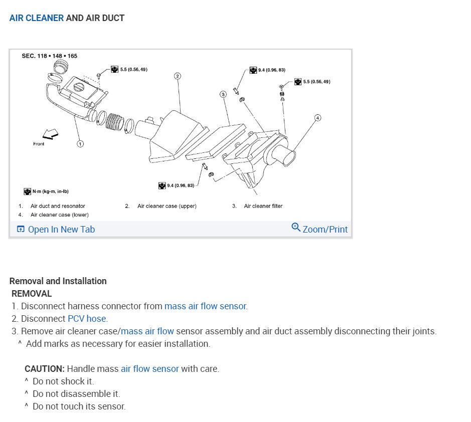

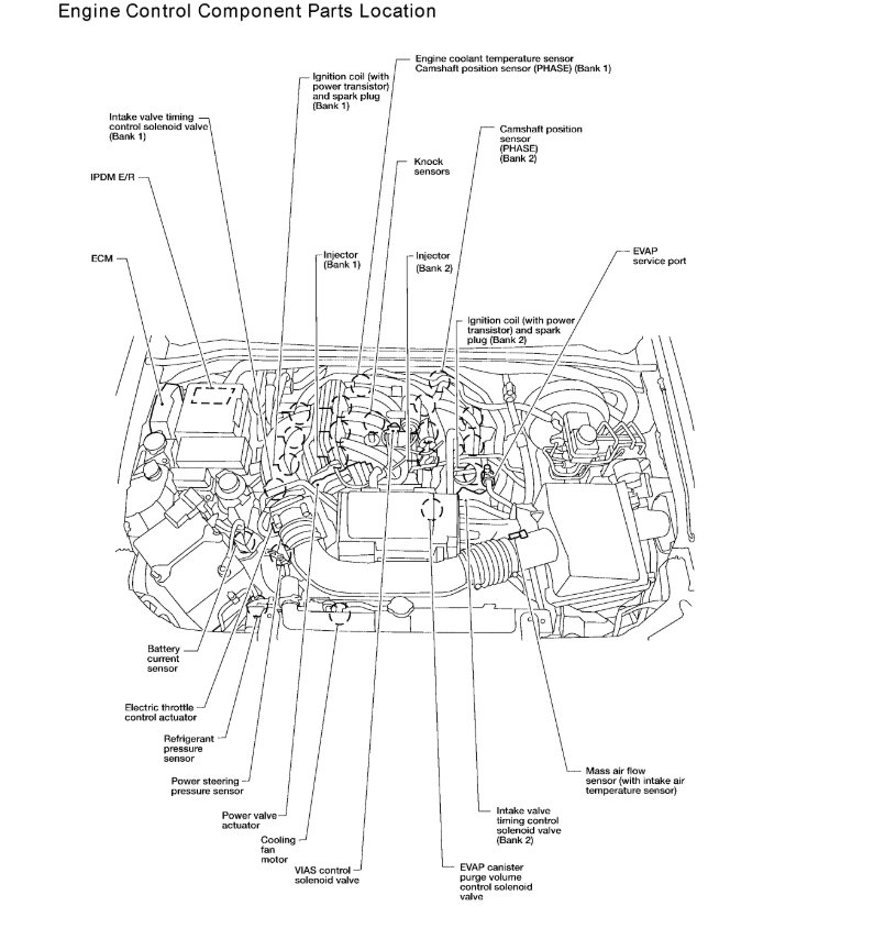

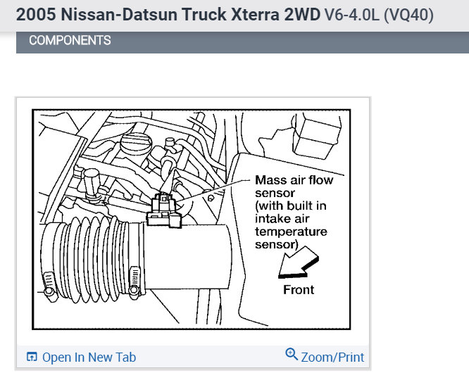

P1283 Nissan Possible Causes. Faulty Air Fuel Ratio (A/F) Sensor 1 Bank 2; Air Fuel Ratio (A/F) Sensor 1 Bank 2 harness is open or shorted. I have seen the MAF sensor cause this issue dues to low readings. I would try a new sensor here is its location. Also please service the throttle body. These guides will help with instructions in the diagrams below on how to change the sensor out:
https://www.2carpros.com/articles/how-to-replace-a-mass-air-flow-sensor-maf
and
Apr 30, 2020 at 10:25 AM
