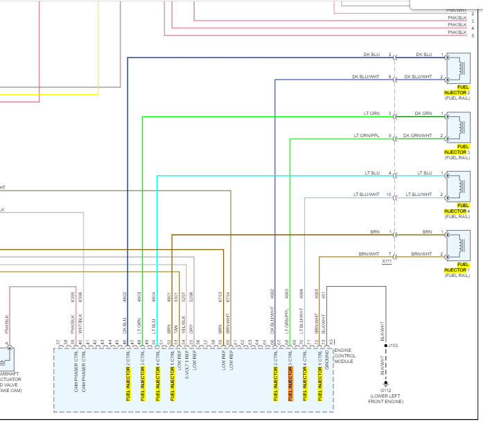

Yes, it would be weird considering the intake gaskets are new. I have it apart again, and everything was connected as it should be, but is there a pin-out for the harness going to the injectors? Maybe I can probe it to check for a short, and go to the junkyard and get one. The code P124A says the circuit shorted to main control, whatever that means.

I am questioning if the number 3 injector is the issue.
As far as the wiring, I attached the fuel injector circuit schematic below for your review.
Let me know what you find.
See pic below.

Well, p124a says it's a positive circuit shorted to the control. Well, that's what happened. I pulled the harness and saw the two wires had broken insulation and were touching. Fixed it up with some electrical tape and we're good to go. How silly!
