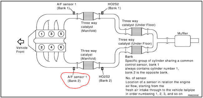

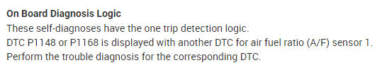

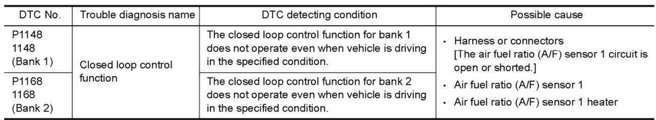

Here is the information you requested. The code you mentioned is a bank 2 sensor 1 heated oxygen sensor code. Here a few tutorials showing how they work and how to replace:
I've attached pictures below relating to the code and the location of the faulty sensor for your Nissan and circled in red. Hope this helps and thanks for using 2CarPros.
