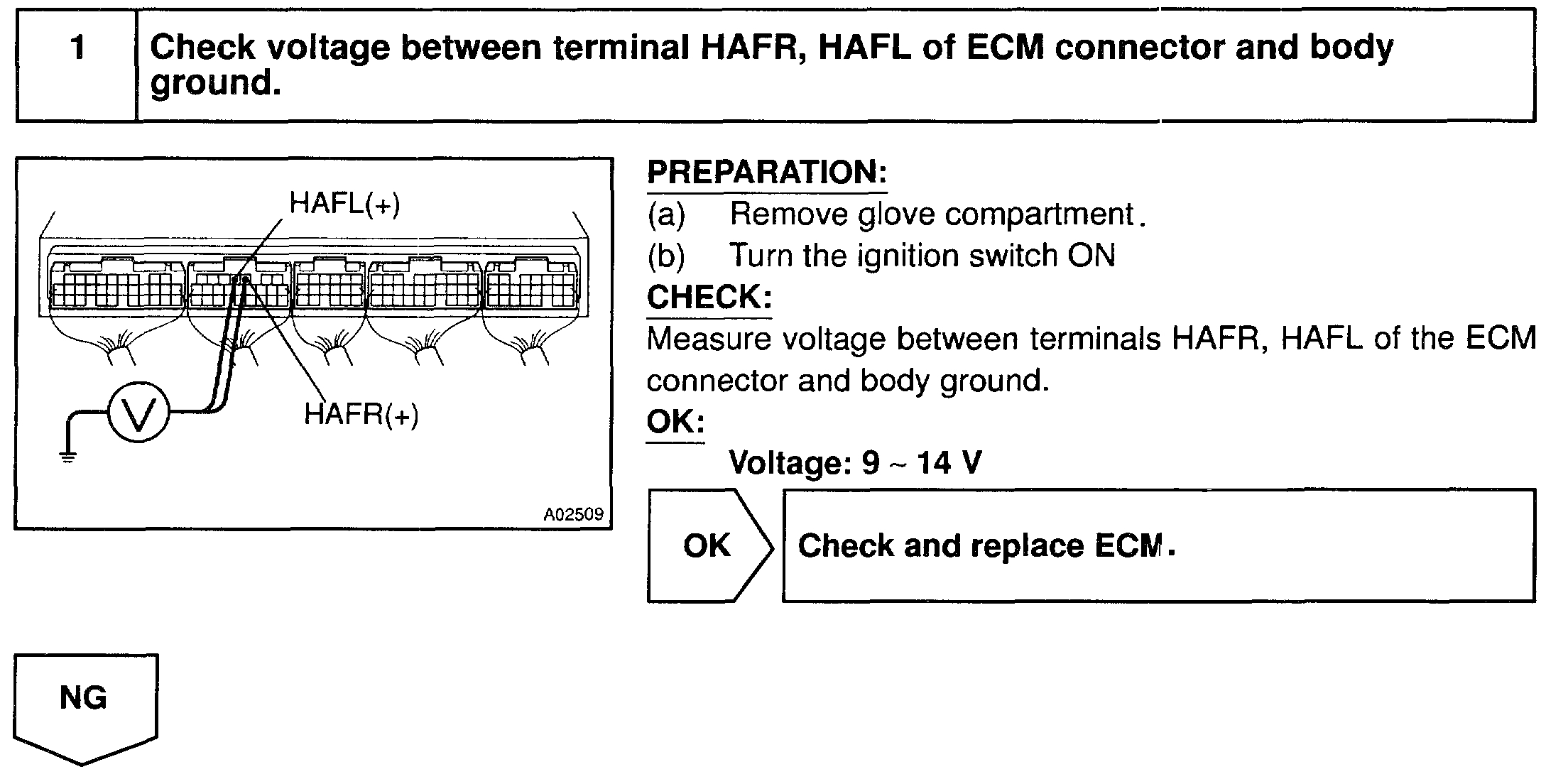

The sensor is most likely the cause. However, wiring issues can cause the code as well. Here are the diagnostic flow charts for this code. Take a look through them and let me know if you have questions.
_____________________________
DTC P1135 A/F Sensor Heater Circuit Malfunction (Bank 1 Sensor 1)
DTC P1155 A/F Sensor Heater Circuit Malfunction (Bank 2 Sensor 1)
picture 1

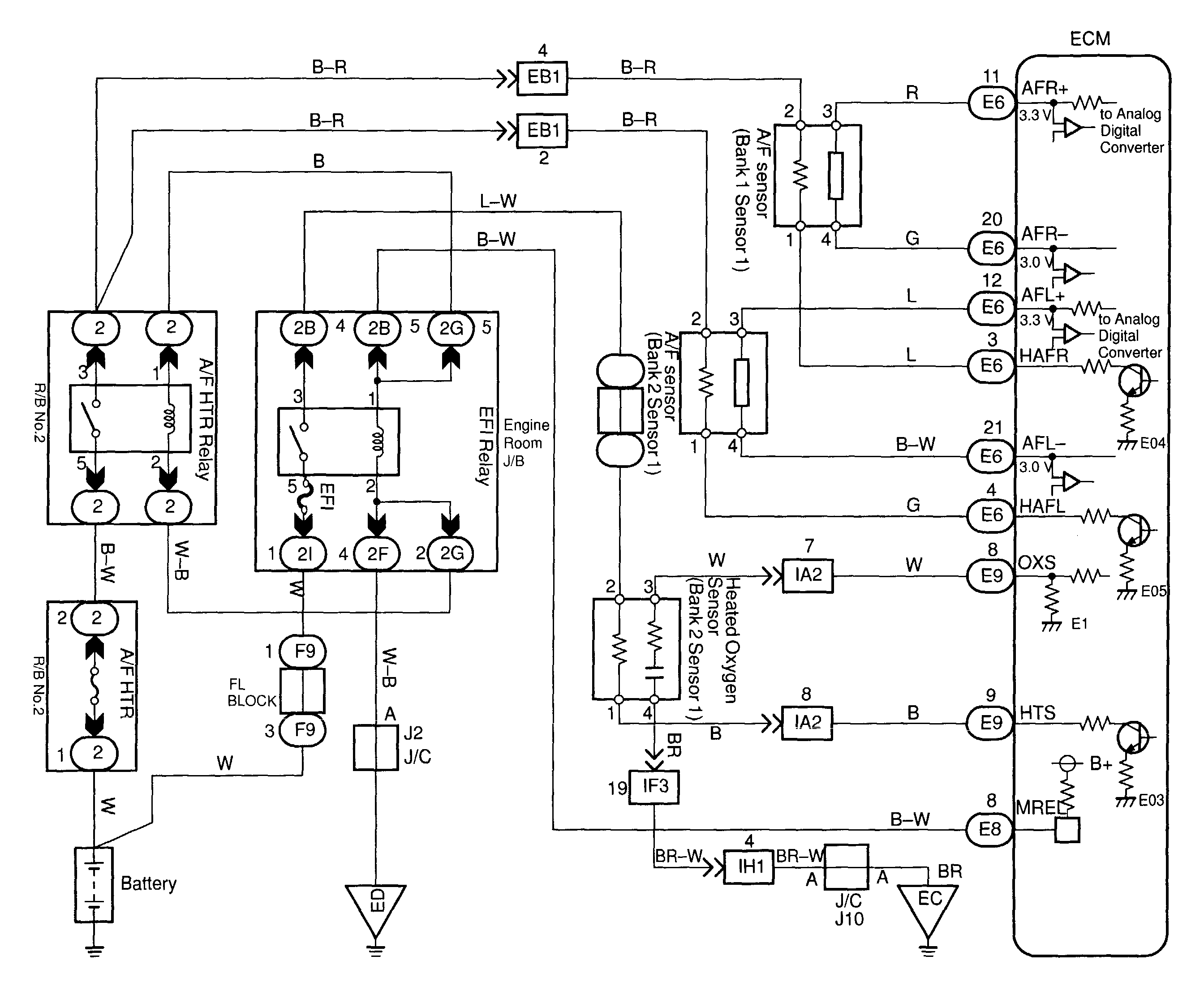

CIRCUIT DESCRIPTION
To obtain a high purification rate for the CO, HC and NOx components of the exhaust gas, a three-way catalytic converter is used, but for the most efficient use of the three-way catalytic converter, the air-fuel ratio must be precisely controlled so that it is always close to the stoichiometric air-fuel ratio.
The A/F sensor has the characteristic that provides output voltage* approximately proportional to the existing air-fuel ratio. The A/F sensor output voltage* is used to provide feedback for the ECM to control the air-fuel ratio.
By the A/F sensor output, the ECM can determine the deviation amount from the stoichiometric air-fuel ratio and control the proper injection time immediately. If the A/F sensor is malfunctioning, ECM is unable to perform accurate air-fuel ratio control.
The A/F sensor is equipped with a heater which heats the zirconia element. The heater is controlled by the ECM. When the intake air volume is low (the temp. of the exhaust gas is low), current flows to the heater to heat the sensor for accurate oxygen concentration detection.
*: The voltage value changes at the inside of the ECM only.
picture 2

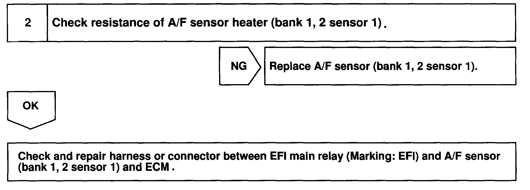

DETECTING CONDITION
picture 3

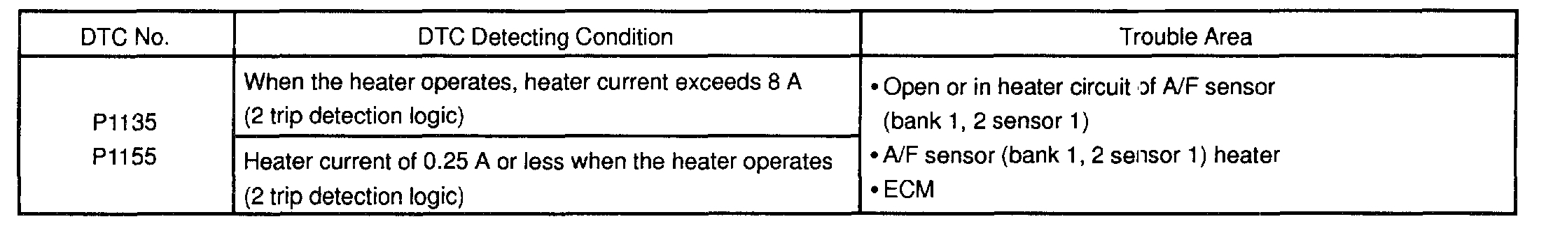

WIRING DIAGRAM
Step 1
picture 4

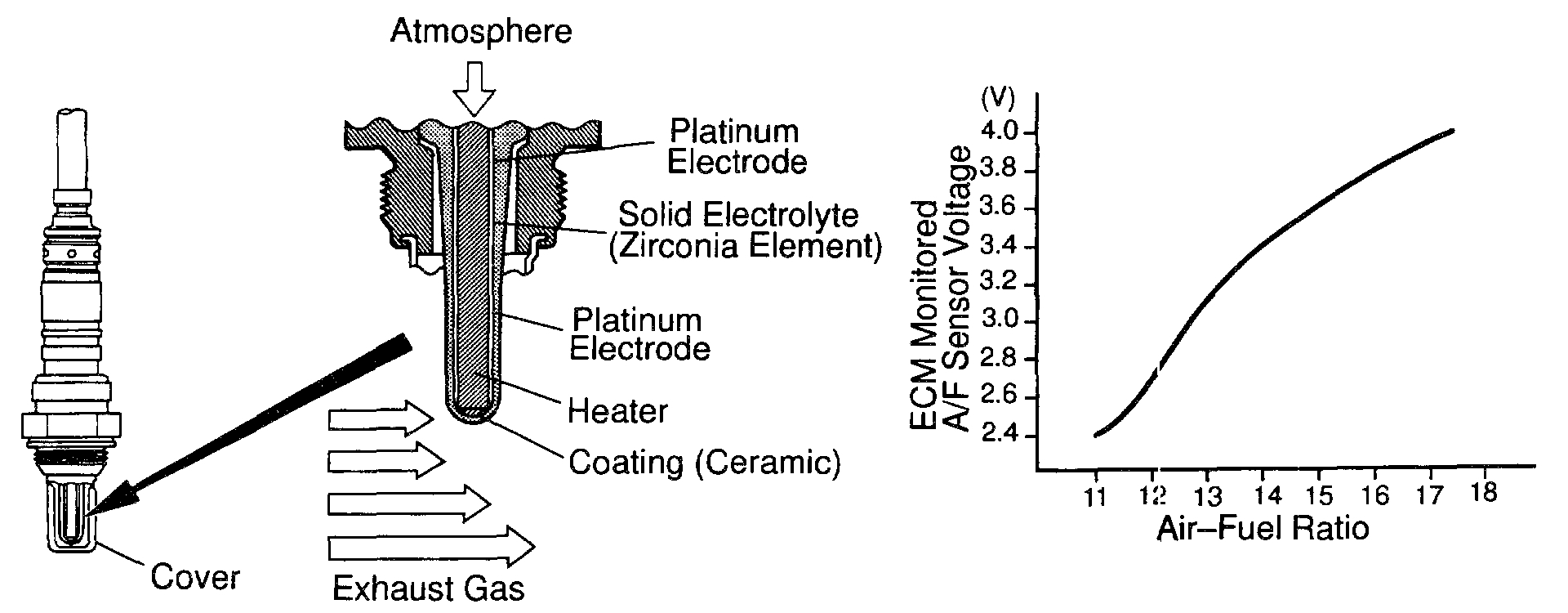

Step 2
picture 5
INSPECTION PROCEDURE
HINT: Read freeze frame data using LEXUS hand-held tester or OBD II scan tool. Because freeze frame records the engine conditions when the malfunction is detected, when troubleshooting it is useful for determining whether the vehicle was running or stopped, the engine warmed up or not, the air-fuel ratio lean or rich, etc. at the time of the malfunction.
