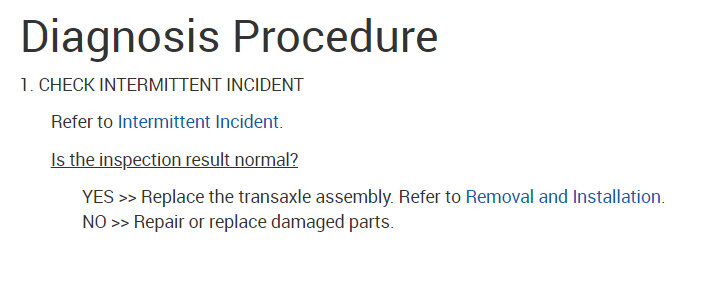

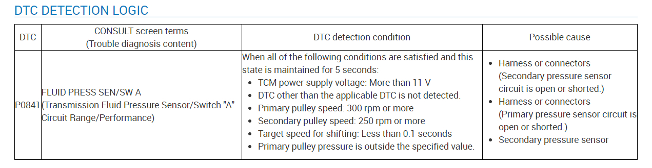

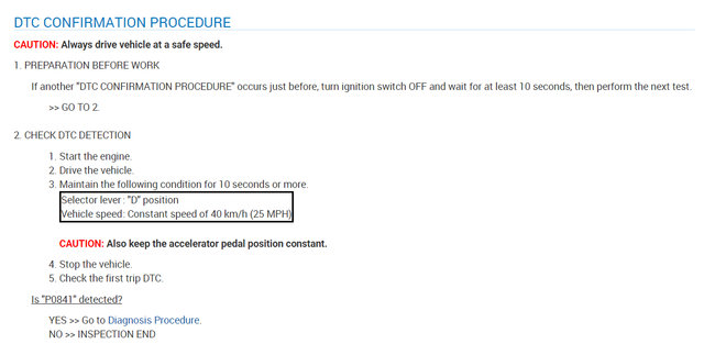

Good morning,
I attached the possible issues for you for the code.
https://www.2carpros.com/articles/automatic-transmission-problems
They show no procedure for the pressure switch at all. Since this is a CVT transmission, they recommend replacing the entire transaxle assembly for this code.
https://www.2carpros.com/articles/transmission-replacement-removal-manual
I attached a YouTube video of the procedure for you.
