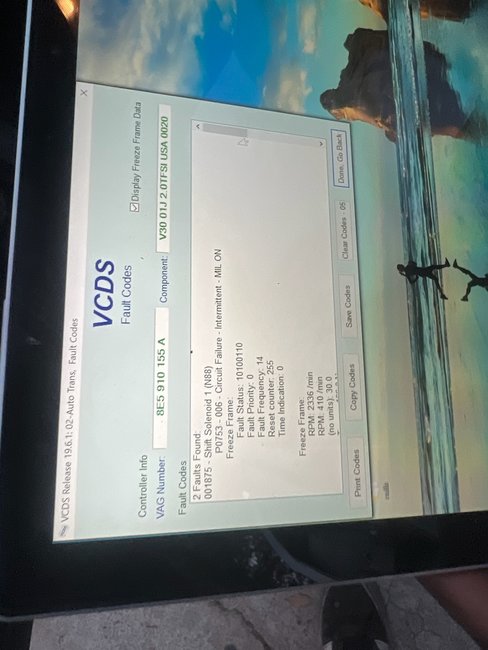

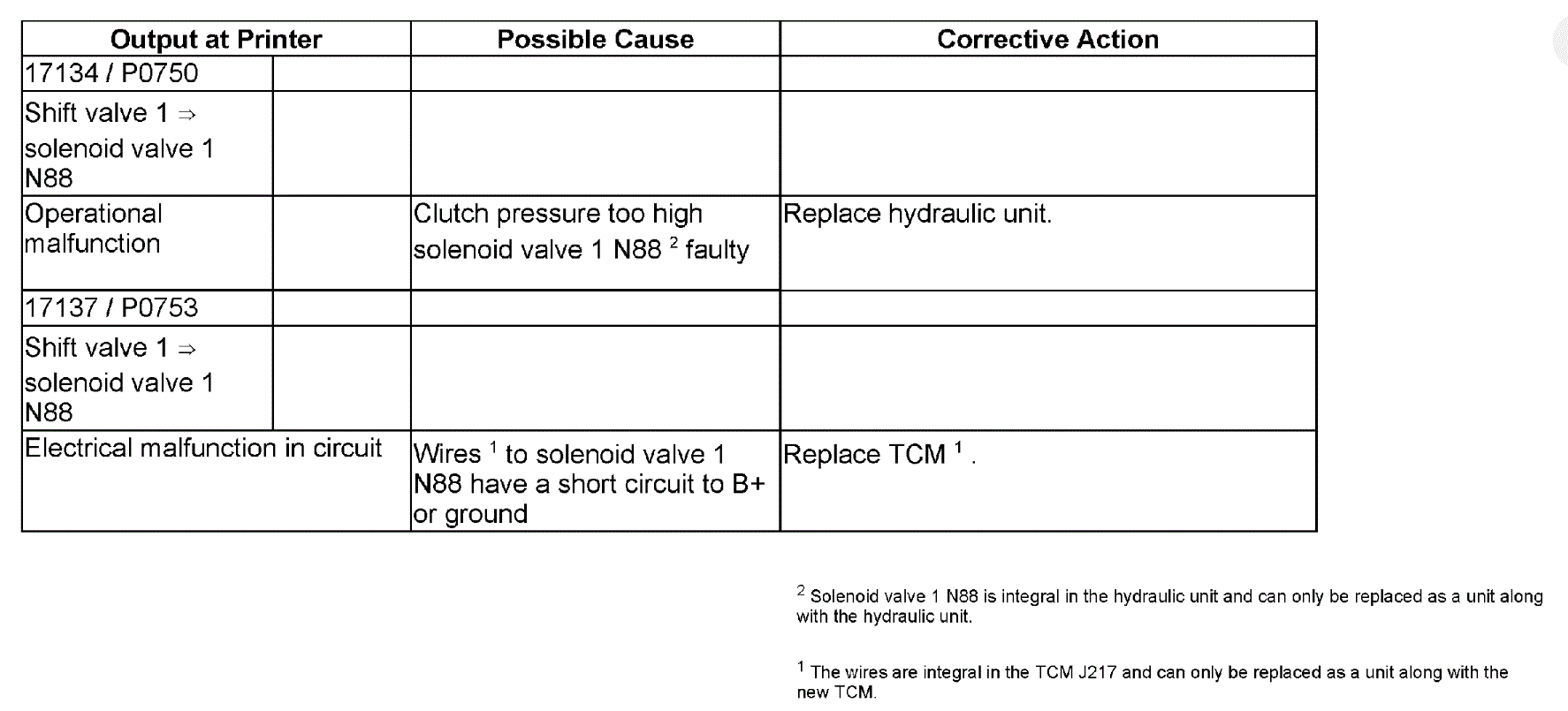

If you send your PCM out for repair, make sure they are aware of the code you have. Also, there are online places that sell remanufactured ones for good prices. I know because I was in the same situation. LOL And it was plug and play.

And yes, the CVTs on any vehicle are known for having problems. The purpose? To meet the constantly increasing federal emission requirements. The CVT helps prevent the engine from revving too high.
