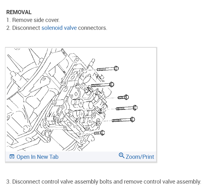

The P0750 code is a diagnostic trouble code (DTC) that indicates a problem with the Shift Solenoid "A" circuit in an automatic transmission.

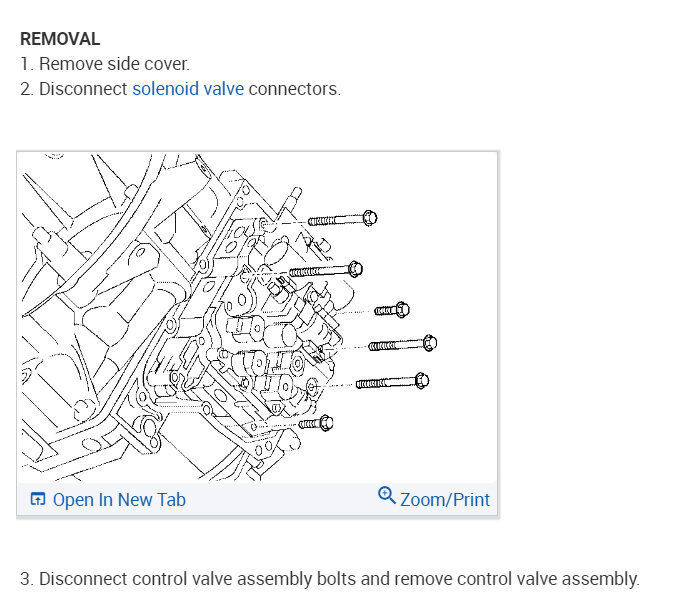

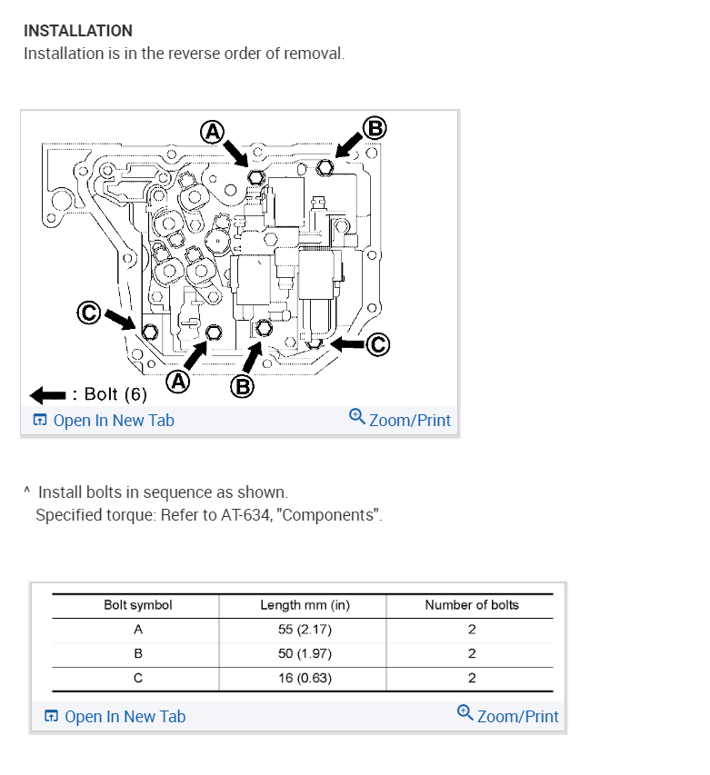

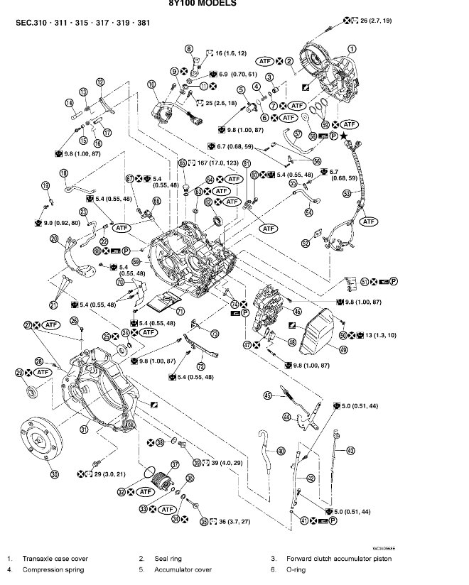

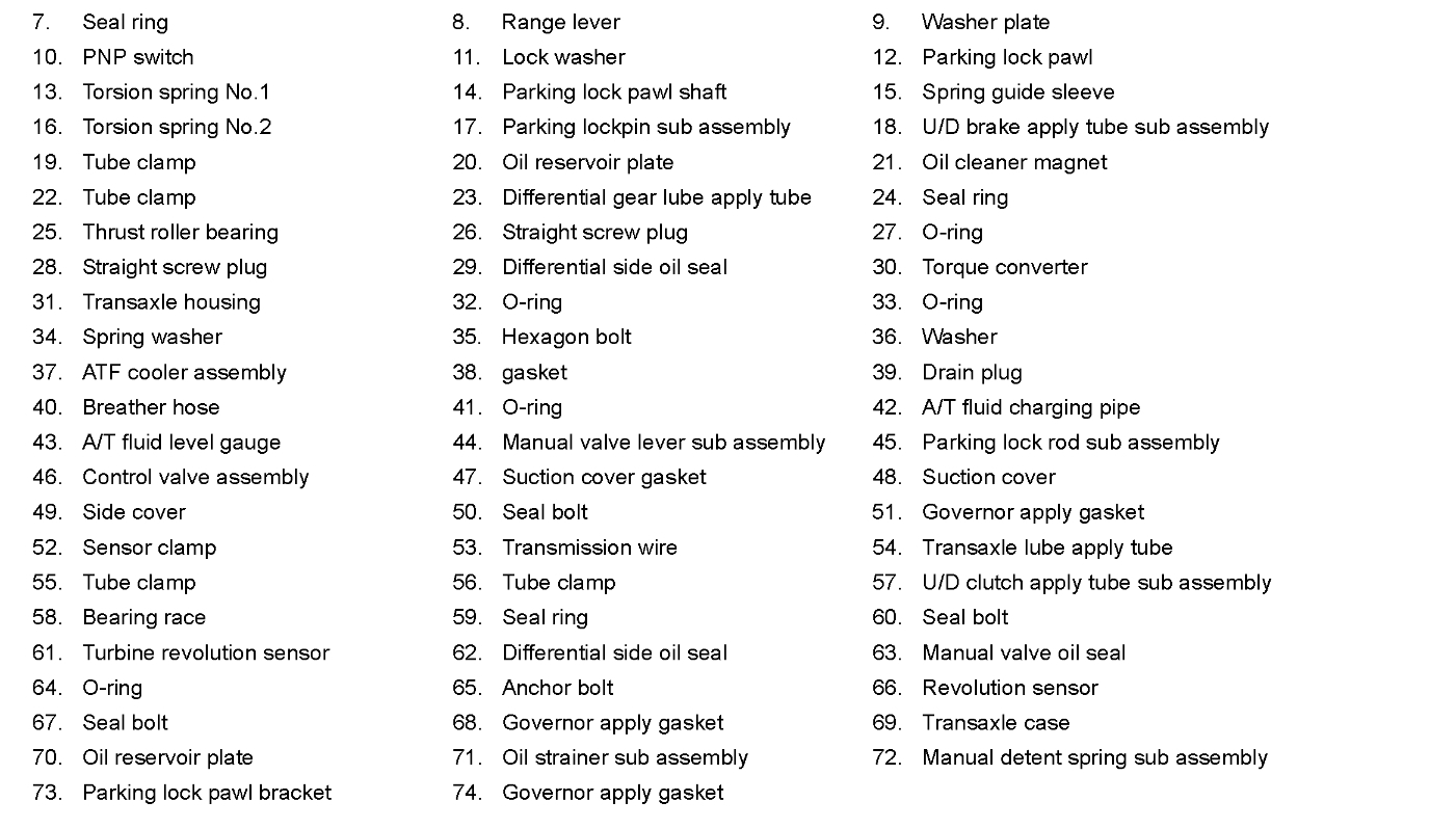

They recommend you replace the valve body with a rebuilt unit which you can find by searching eBay. Please check out how to change the valve body out in the images below. Please let us know if you need anything else to get the problem fixed.

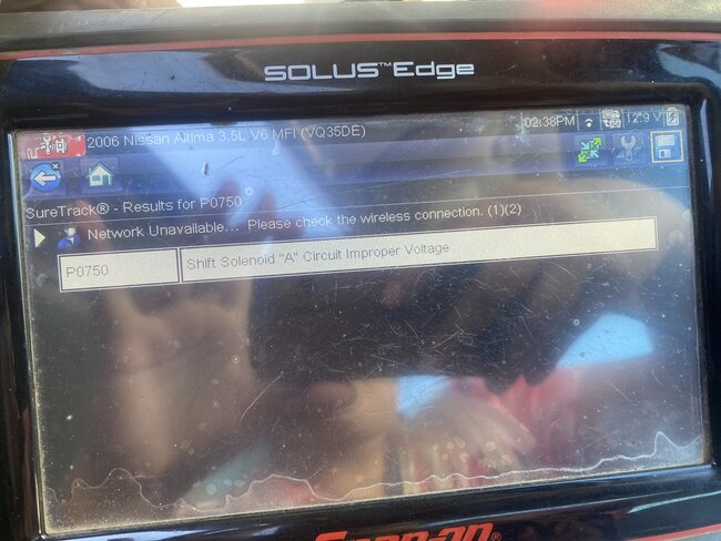

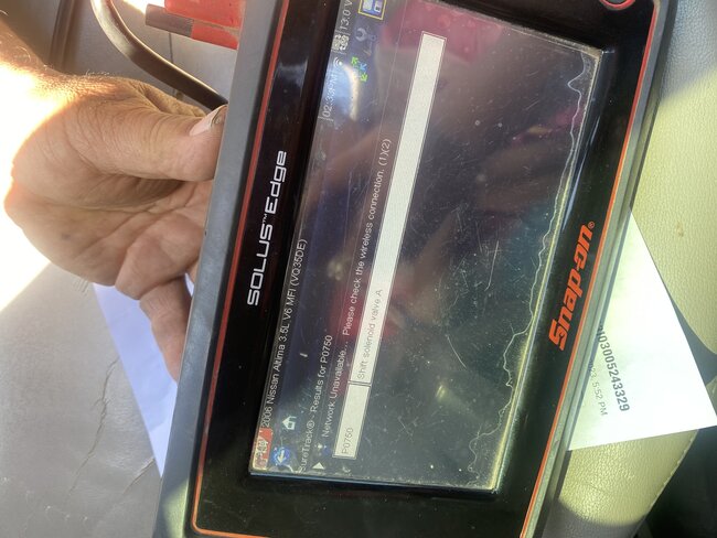

Also, here is what the scanner says, would the valve body still need to be replaced? Or just a solenoid?
