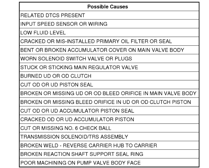

It sounds like you have an internal issue with the transmission. I attached possible causes below as well as a flow chart that someone needs to follow to find the failure.
Most of the time, gear ratio codes are internal failures in the transmission.

17. LIST OF POSSIBLE CAUSES
If any other DTCs set during the road test, refer to the appropriate procedure in the Transmission category.
If no other DTCs set during the road test, below is a list of possible causes, but not strictly limited to those.
Check for:
- Excessive debris in the Transmission Oil pan, plugged, cracked, or mis-installed Primary Transmission Oil Filter and/or seal.
- Cut or missing No. 6 check ball in the main valve body.
- OD and UD accumulator pistons and seals and bleed orifices, and the Solenoid Switch Valve and Plugs in the main valve body.
- OD and UD clutch piston seals, reaction shaft support seal rings and dribbler assemblies, and the flatness of the pump valve body and pump housing faces.
- Main regulator valve for sticking in its bore.
