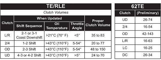

This is typical of a slipping clutch pack. There's two common causes of that. The first is a cut rubber lip seal on the piston. The more common cause of that is worn fiber plates in the clutch pack. The way to identify that is by reading the "clutch volume index", (CVI). I use a Chrysler DRB3 scanner for my vehicles. I suspect other high-end scanners will do that too.
This chart applies to one version of transmission in your van. Pay particular attention to the volumes for the low / reverse clutch and the 2 / 4 clutch. If you find a CVI value close to the maximum listed, it's time for a rebuild.
The CVIs are calculated by watching the input speed sensor and output speed sensor signals to determine when one clutch pack releases and the next one locks up. The time it takes is used to make that calculation. One trick that often works to verify a clutch pack is taking too long to lock up is to accelerate harder than normal to cause a delay in an up-shift, then release the accelerator pedal long enough to let that up-shift occur under low torque. That will reduce the slippage so it won't be detected, and won't go into limp mode. That can allow you to get into the higher gears, but it only delays the inevitable for a few days or weeks. The rebuild is the permanent fix.

What does the "Preliminary" CVI on the 62TE mean? My L/R shows and out of spec 68 CVI when the van is driving. Van drives perfectly.

Thank you for the very detailed explanation. I appreciate that. I will take your advice and post my own question. I am in the early learning stages about automatic transmissions. What limited reading I've done informed me about some of what you covered. I did read about CVIs and I think I have a basic understanding of those. What I didn't, and still don't understand is why the specs for CVI values for the 62TE state "preliminary". Other Chrysler transmission model specs that I've seen just give a low and high range for CVI values. I will include the details in my question, but my van is a 2013 Chrysler Town and Country with ~ 150000 kms on it, 3.6L Pentastar engine. I bought it about a month and a half ago. Since acquiring the van I have replaced all of the fluids including extracting 4L of ATF+4 and replacing, a week later dropping the pan and replacing the filter and pan with a drain plug (added ~5.5L, ATF+4). I have the temp/level chart and I am just shy of the max range. The van drives perfectly with smooth shifting. I was just trying to figure out why my L/R CVI seemed out of spec. All other CVIs are within range and line pressure (desired and actual) are always in agreement. I am aware of some of the potential issues with the 62TE and have watched all of Gary Ferraro's youtube vids on the transmission. Once again, thank you for the detailed summary. I learned a lot from it.

I too have never seen the designation, "preliminary" What I can share is any time the battery is disconnected, those learned CVI values are lost. The computer reverts back to the initial starting values programmed in at the factory, then it could shift like a race car for the next two miles or dozen shift cycles until it relearns that data.
