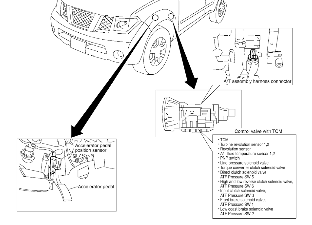

We handle one problem per thread so this thread will will fix the P0717

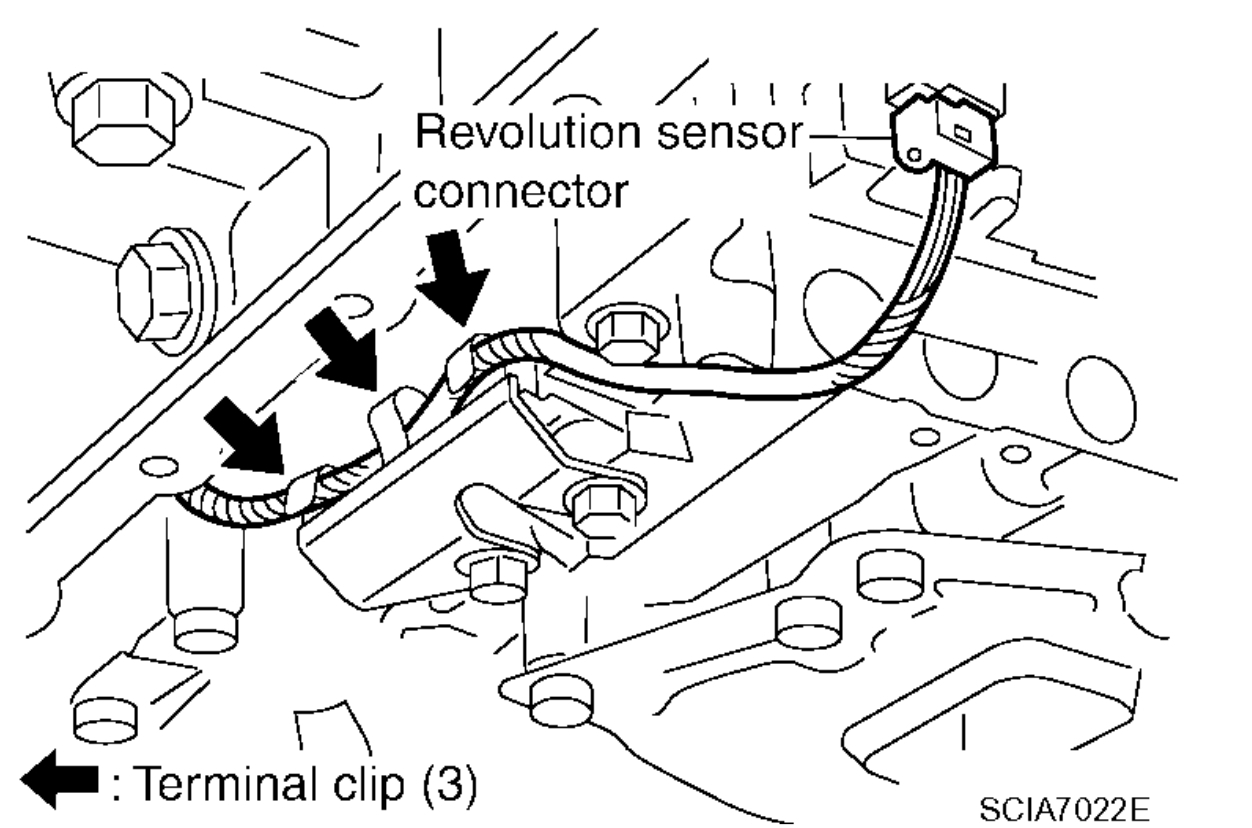

Here is the location so you can check it out. I would check the condition of the wiring as well. Check out the images (Below). Please let us know what happens.

Unfortunately, I replaced the output revolution sensor in the diagram and the TCM module which has the input turbine speed sensor on it. I still have the same issue. Any other suggestions?
