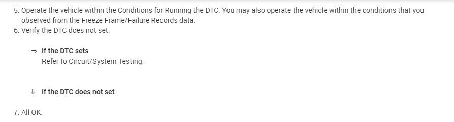

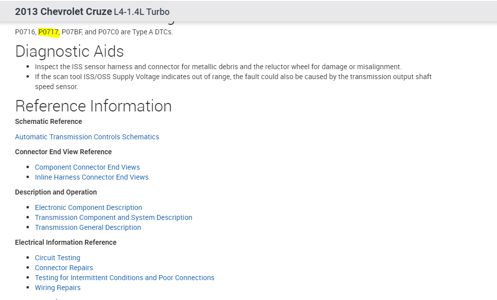

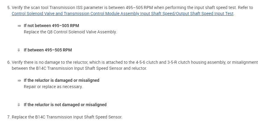

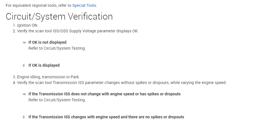

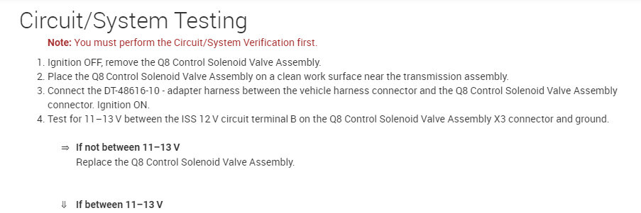

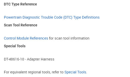

The issue could be a wiring problem, the toner ring that the sensor uses may be faulty, there could be a voltage related, and so on.
I attached the diagnostics below for the code. Take a look through them and let me know if you are comfortable performing them.
See pics below.

Hi Joe,
Thank you for the guidance! My ISS voltage is not showing any change/reading. How would I preform the circuit/system testing?
Nov 2, 2023 at 11:41 AM
Were you able to check the voltage to the sensor? Do you have a scan tool that can do what is listed in the above tests?

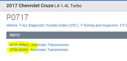

I tried going through schematics but found there are two possible transmissions. See pic below.
By chance do you know which one you have?
See pic below.

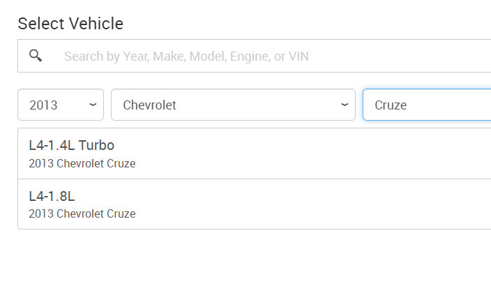

Now I'm confused. LOL They didn't offer the 1.4L as a non-turbo. See pic below.
Is it possible that you have a 1.8L?

Oh lord, that's my fault lol! Yes, it's a 1.8L!
And to add, I ended up taking it back apart yesterday to check the solenoids with a multimeter the solenoids were all within range. I cleaned the connectors again and I put it all back together- it did get to operating temperature and the light/code did not go back on. My scanner does not read the ISS or OSS (I was misreading it). Giving it a test drive today after a warmup and hoping for the best. Will keep you posted!
