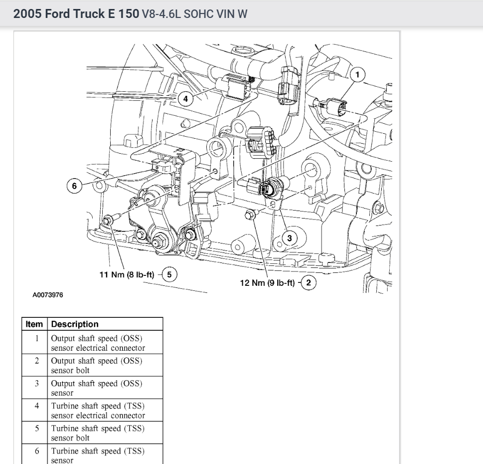

I wanted to know the location of the output speed sensor , (and input just for reference) I replaced the input speed sensor but want to make sure it was the right one . Seeing as how the new one was black and the original was white .

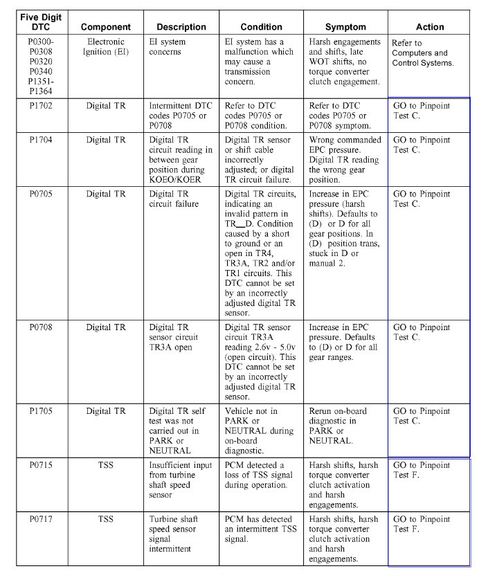

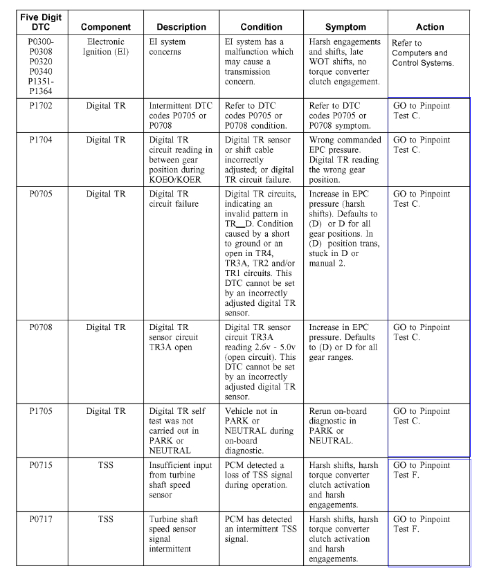

This code sets when the sensor goes out and when the transmission torque converter is getting weak and the lock up clutches inside the converter are slipping, is the transmission original? Is the replacement sensor an OEM Ford unit? Here is the testing procedure for the P0715 code in the diagrams below.

Ken, I wanted to thank you , the first diagram you sent me really helped me to identify the sensor causing the problem , after I replaced both sensors to cancel them out , I replaced the wiring harness for the Turbine Speed Sensor , now the Blinking Overdrive Light and DTC P0715 Is resolved!
