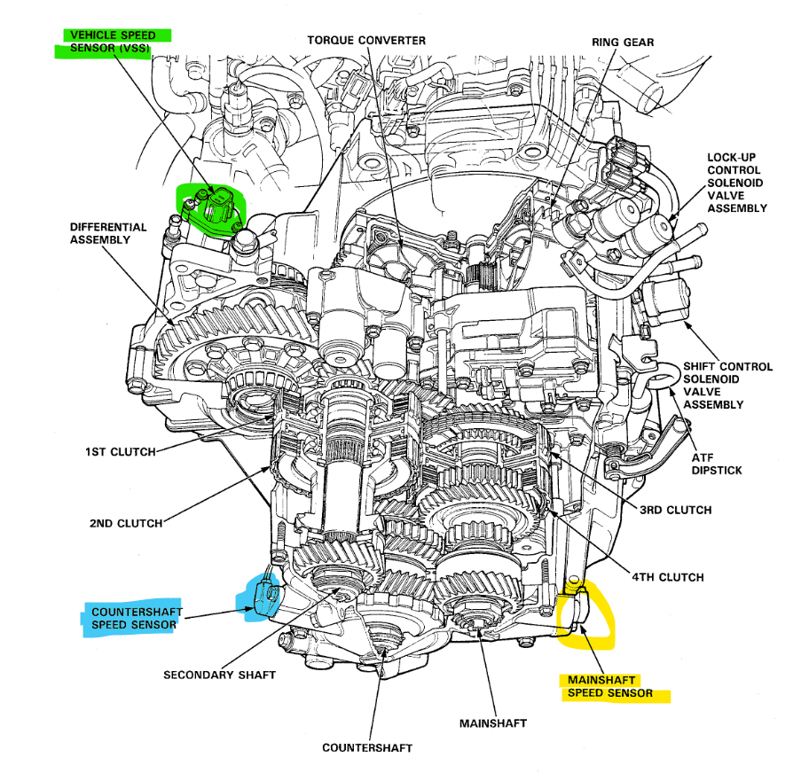

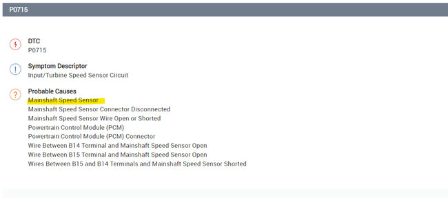

The car is throwing code P0715 for the turbine/input shaft sensor. I want to change both the input and output but all the pictures I have seen do not help me to find the locations. Could you please provide pictures and directions to where they are so I can change them?
