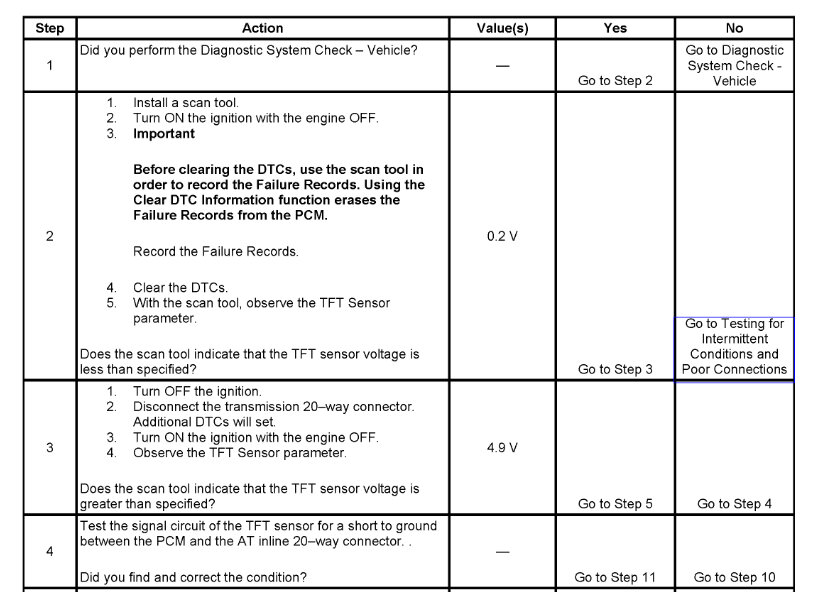

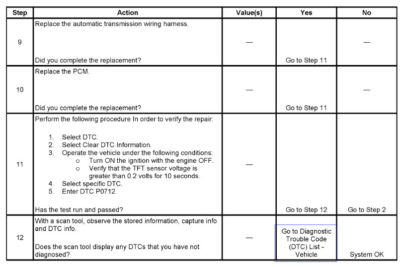

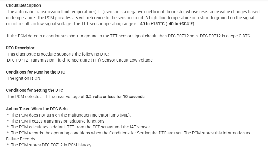

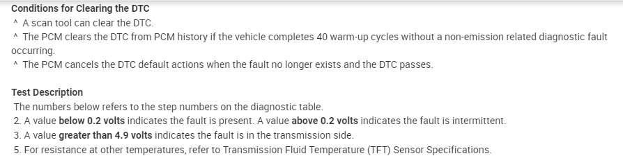

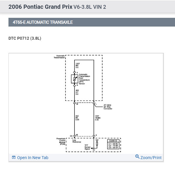

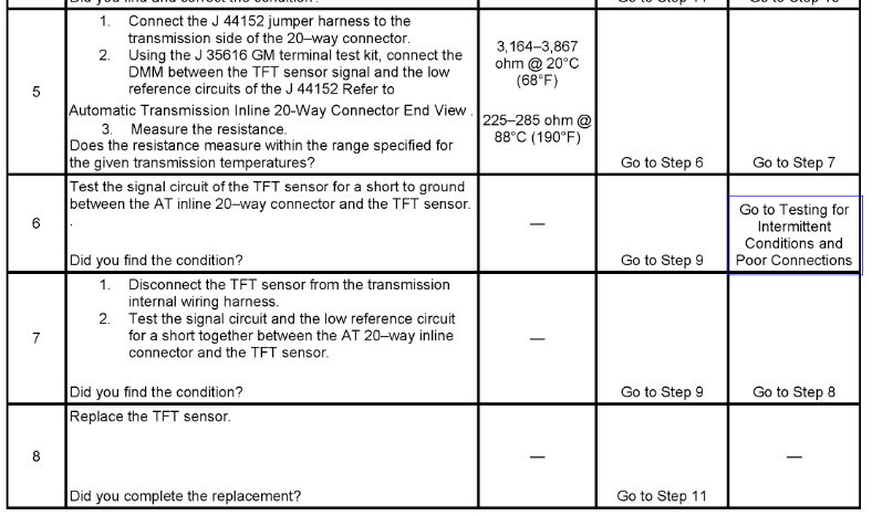

I don't feel the transmission needs to be replaced. Also, the fluid itself isn't the cause. You likely have a short in the wiring harness to the transmission.
I attached diagnostics below for you. Take a look through them and let me know if you are comfortable performing them.
See pics below.
