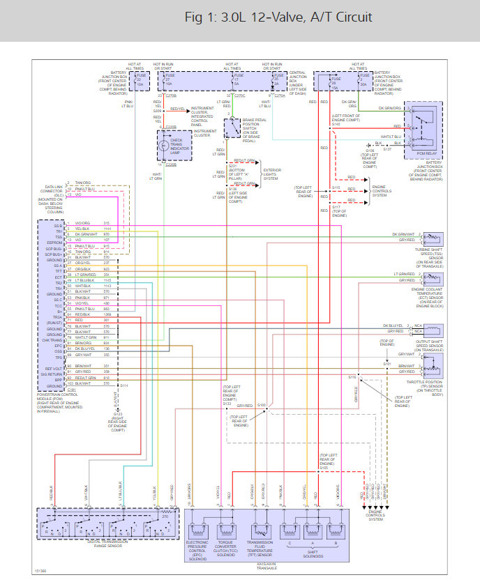

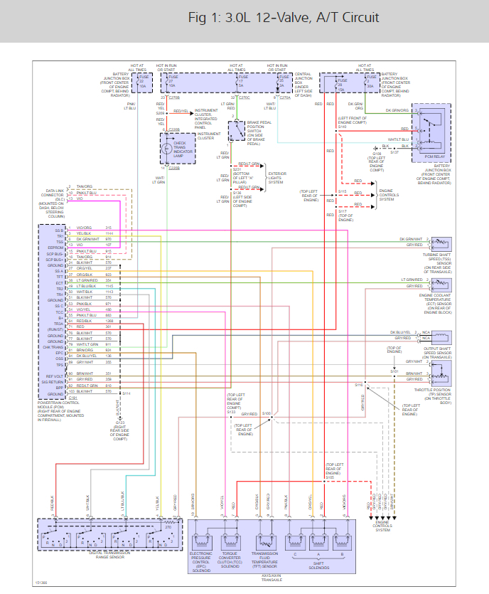

It sounds like you have a bad connection between the PCM and the range sensor. Here is a guide to help you check the connections:
Here are the wiring diagrams for your transmission.
Check out the diagrams (below).
Please run this test and get back to us.
