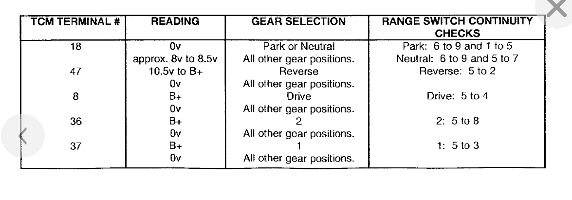

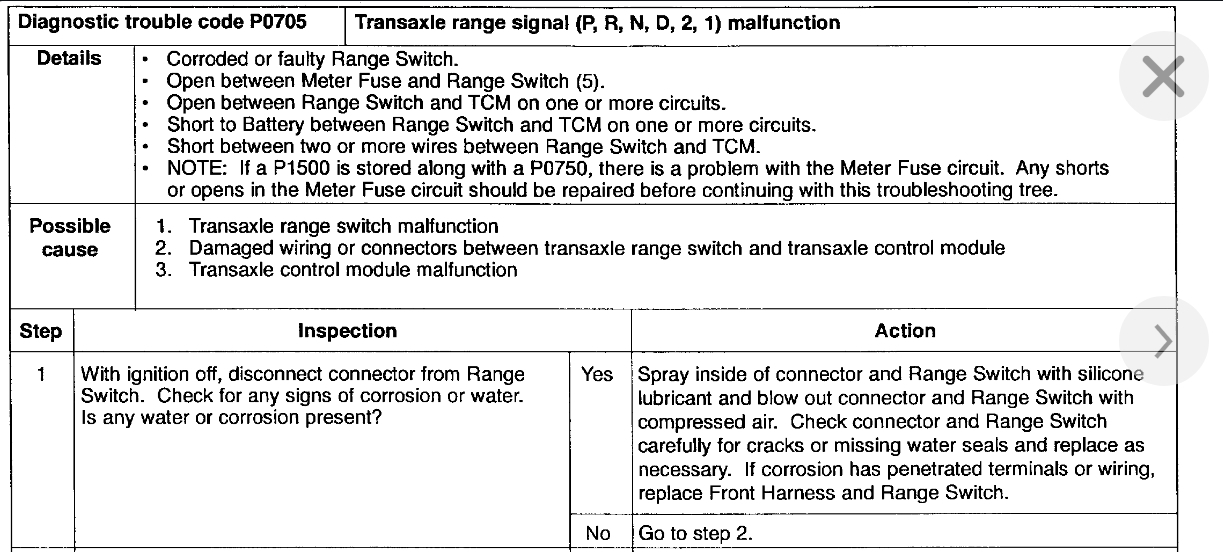

What is the procedure for testing to narrow down to the problem?
Jul 24, 2019 at 5:02 PM
SCGRANTURISMO
  • 4,897 POSTS

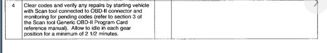

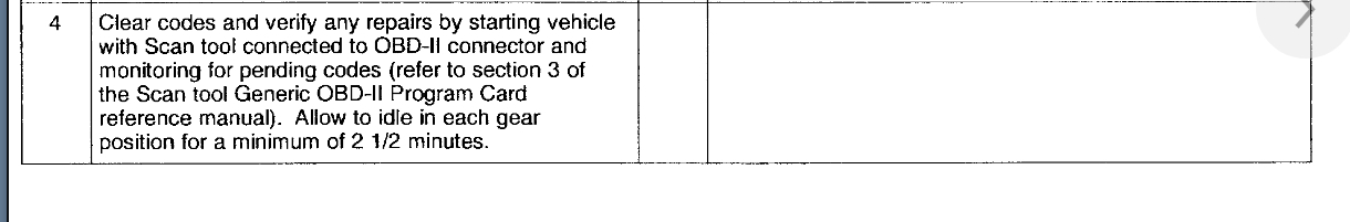

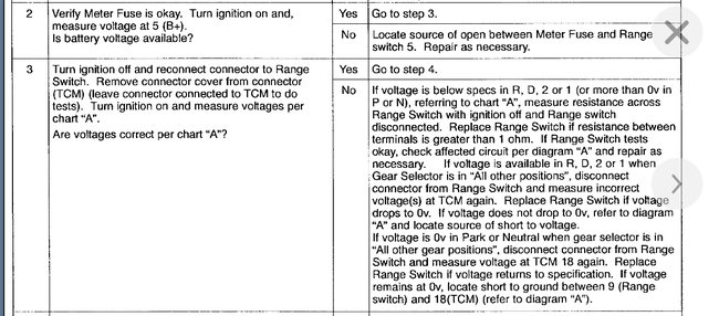

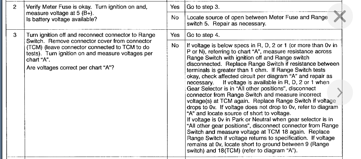

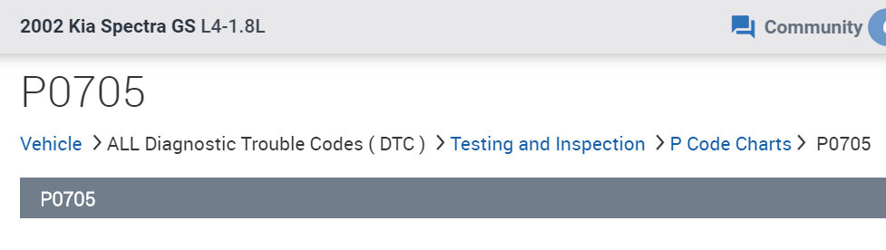

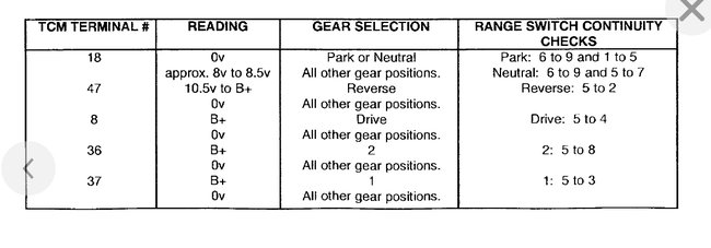

In the diagrams down below I have included the Kia factory diagnostic, troubleshooting guide for Direct Trouble Code (DTC) P0705 for your vehicle. It will require you to use a multi-meter, so I have included this link below for how to use a multi-meter if you are unfamiliar with how to use one.
Please use these guides, if necessary, and get back to use with what you are able to find out.
