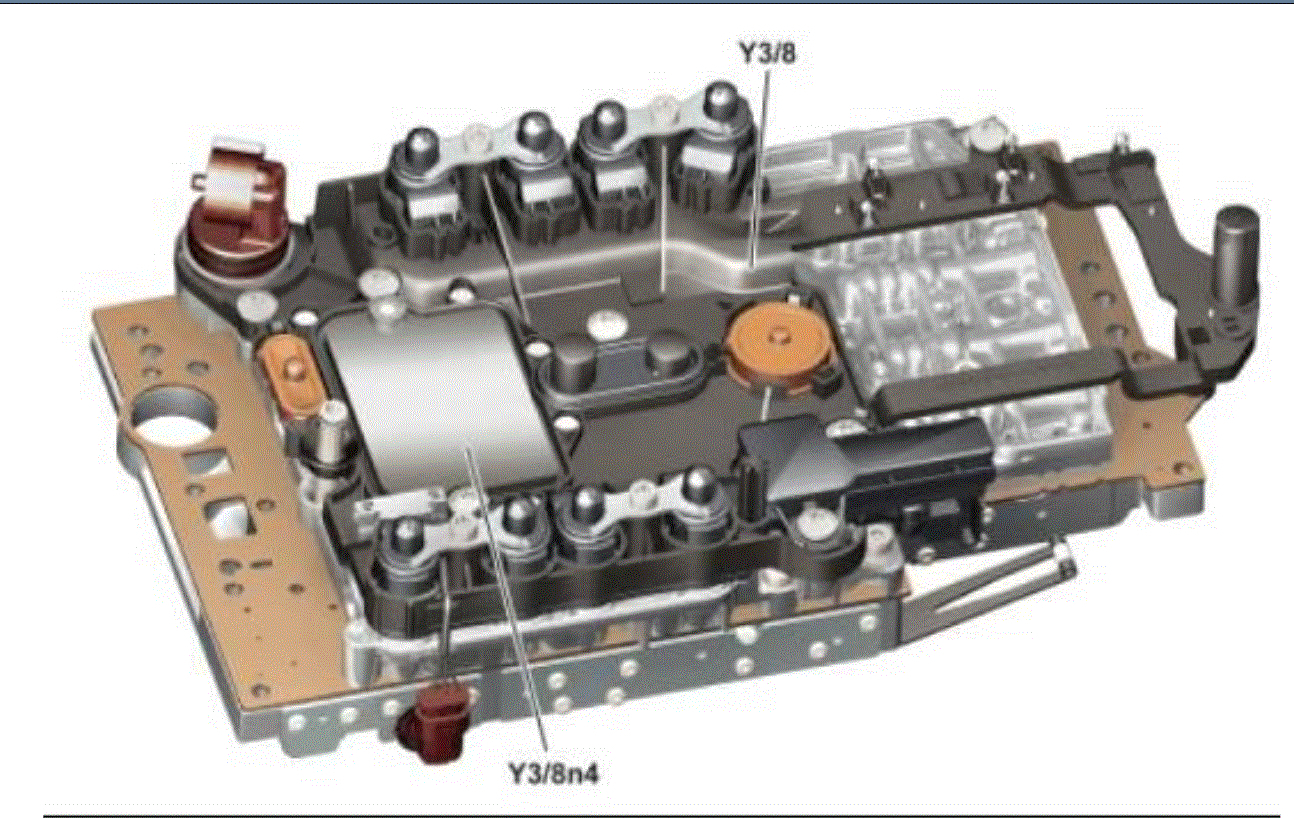

This vehicle has a fully integrated transmission control unit. It is in the transmission. It isn't something you want to try and find it isn't the problem. It isn't cheap. I attached a pic of it.

The idea that it jumps to neutral is certainly a concern and understand why you want it repaired. I have a feeling it could be related to the sensor I mentioned or even the the control module. Both of these will require extensive diagnostics.
