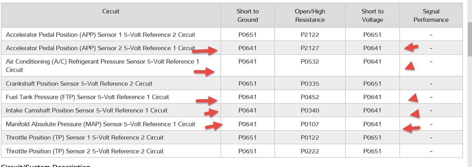

this is a can/bus problem where voltage is sent to 5 different sensors it can be a harness problem short to ground or other voltage things. the app sensor along with map is one of those if all 5 are disconnected and code still shows then it's a harness problem....try the app and see if it cures it if not then more searching will be involved.

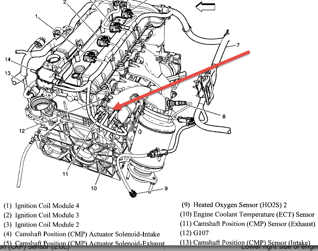

a related side question. I replaced the camshaft position sensor. According to the wiring diagram there is a camshaft position sensor on the intake and the exhaust side. I replaced what I believe is the intake and I can't locate where the exhaust one is at. According to the wiring diagram that I have and the guy at the part shop, there is one somewhere.

for some reason we don't list the 2.2L at all, but it's pretty much same as 2.4L see picture and 641 is intake not exhaust.
