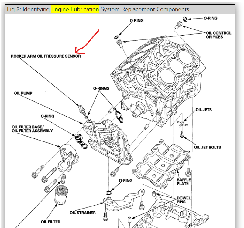

Is this the one on front of the head, or the one in back or the one by filter housing? Replaced the one on front of head made no difference.
Apr 12, 2023 at 3:24 PM

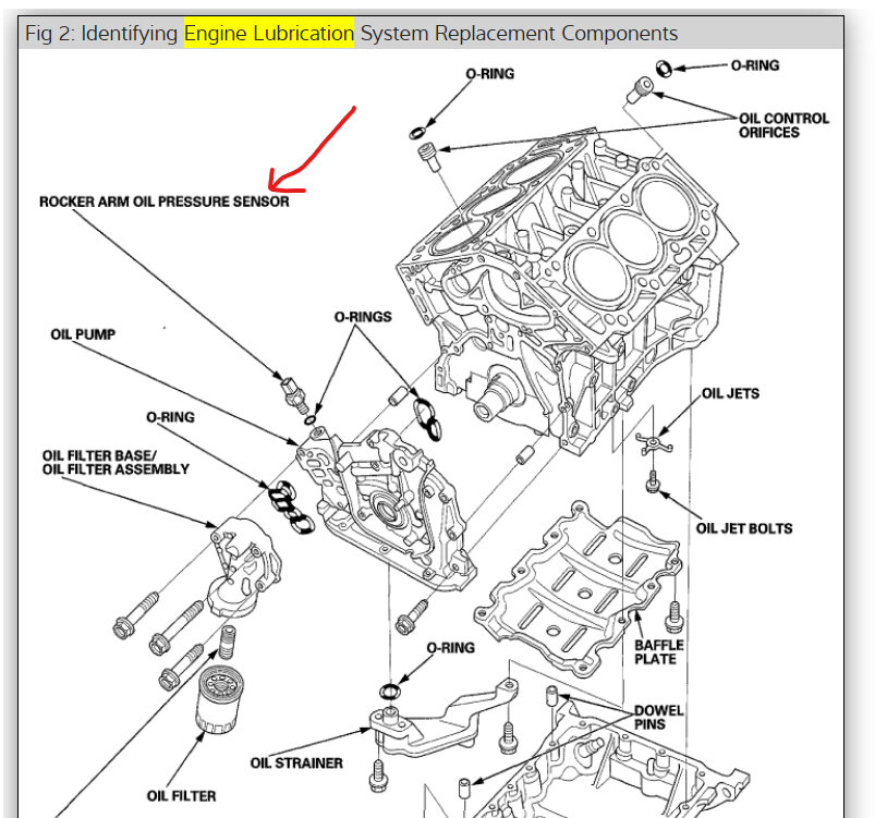

The code P0522 indicates that there is a problem with the engine oil pressure sensor or the oil pressure sensor circuit. I would start by checking the connection at the sensor and then inspect the wiring harness for damage. Here is the location of the pressure sensor. Check out the images (below). Please let us know what happens.
Apr 13, 2023 at 10:48 AM

I checked connection on all 3 sensors, 2 on head and one by oil filter.

Got it fixed. Went and cleaned the connection by the oil filter again with electric spray, and when it clipped it did so differently, so all good.
