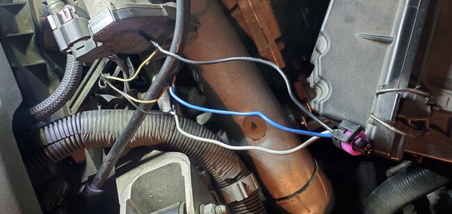

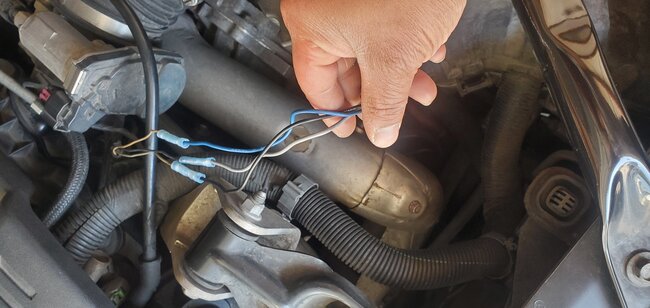

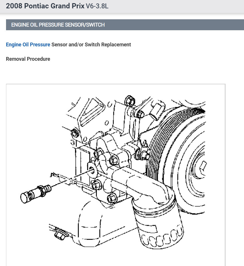

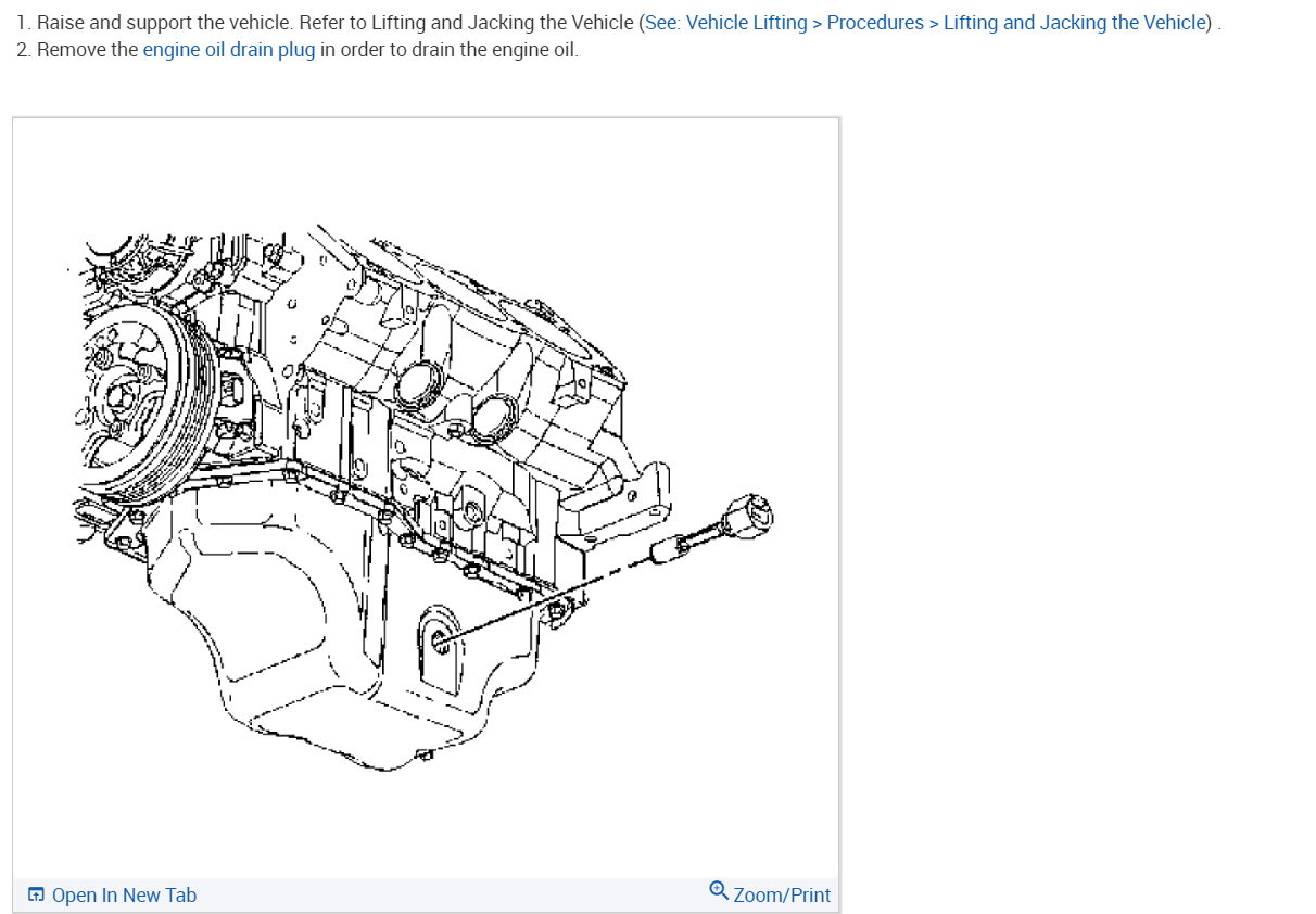

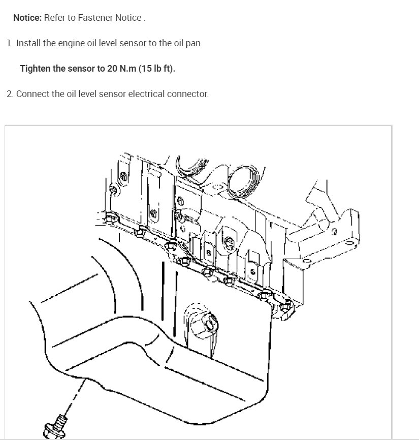

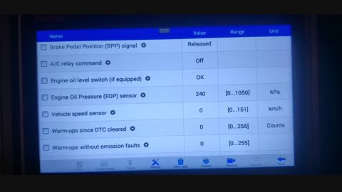

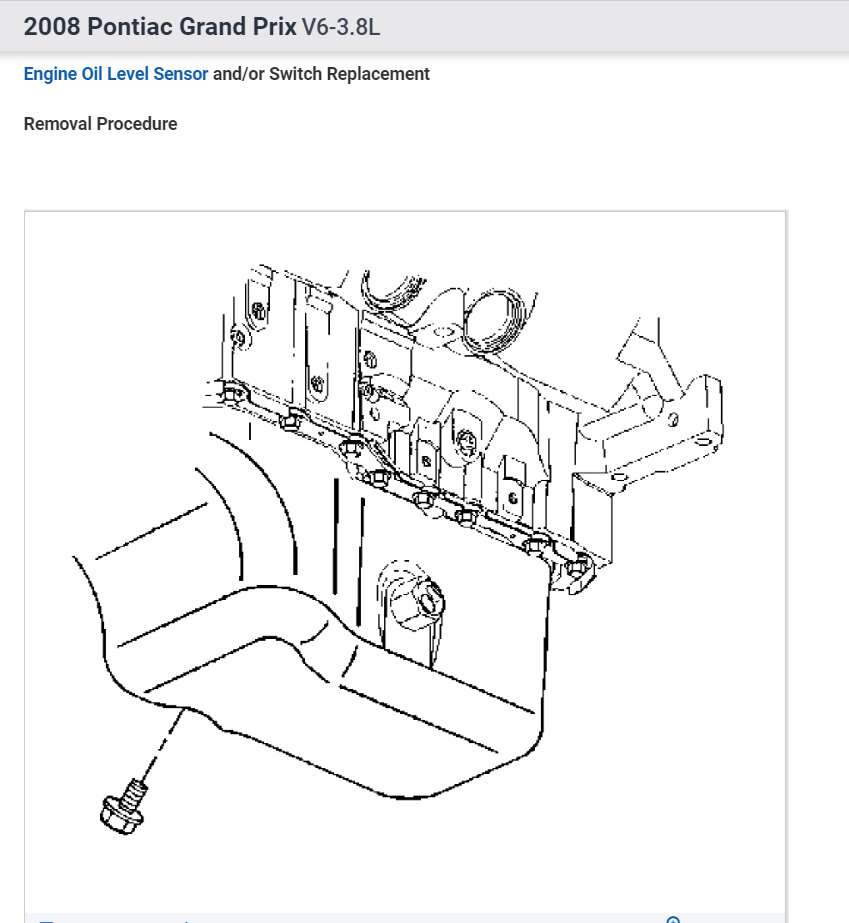

Hello, I changed out my oil with fresh oil change and also replaced the connector pigtail over the oil pressure sensor with ACDelco. Then I brought another oil pressure sensor AutoZone, but when I start car only the check light comes on, I don't get any other sounds like chimes from the dash or other blinking light just check light only. I checked for leaks no leaks and also, I checked the oil pressure sensor plus screen it's all good, but this code is bothering me because I keep replacing everything and it only comes on when I start the car. Where is the oil level sensor located on this car? I will probably replace that ASAP too.
