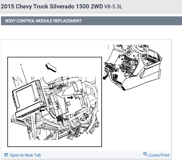

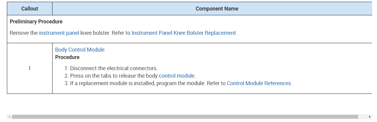

Here is how to change the BCM out, you can get a preprogrammed unit by searching Google or Ebay.
