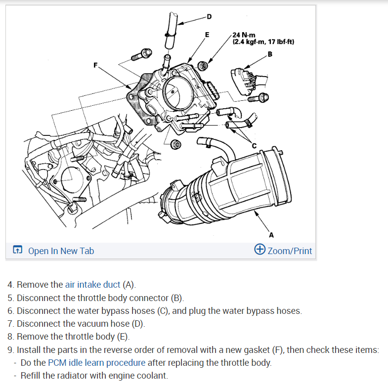

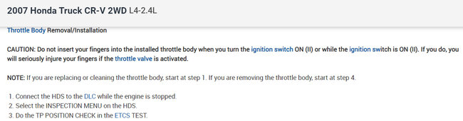

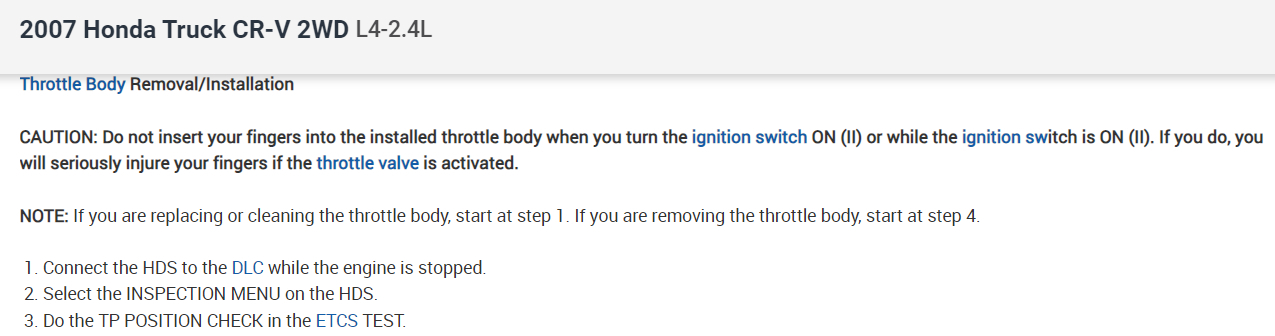

Here is how the job is done on your car. Check out the images (below). Please upload pictures or videos in your response to the problem so we can see what's going on.
