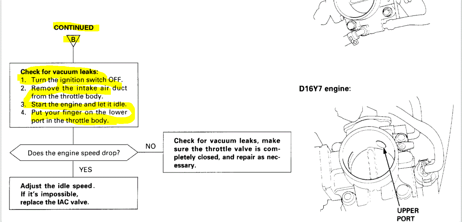

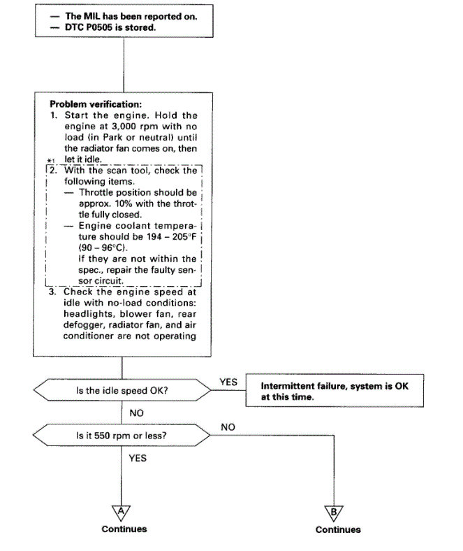

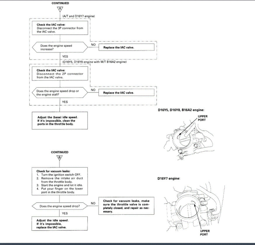

The code indicates an issue with the idle control system. This could be the result of a faulty IAC (which you replaced), a throttle position sensor, or even an engine coolant temperature sensor.
If you look at the three pics below, I attached the diagnostics. It will walk you through the different things to check.
Let me know I this helps or if you have other questions.
See pics below.

It has to be something electrical. When the idle is high, check the throttle position sensor angle. It should be approximately 10%. This should be done with the engine at operating temperature. However, I would like you to do it when cold as well, when the idle speed is too high.

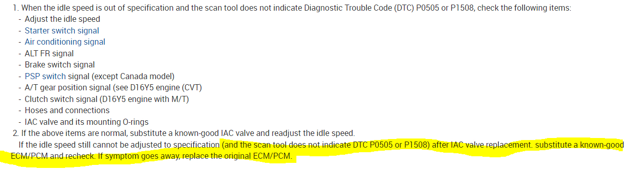

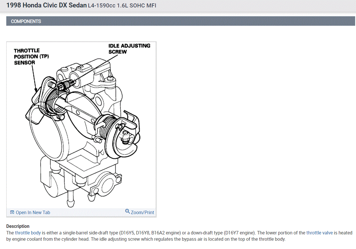

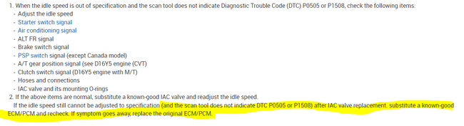

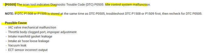

I didn't realize these were the same type of symptoms you had with the old motor. With that in mind, certainly, it could be what you're thinking. Or a problem with the wiring.

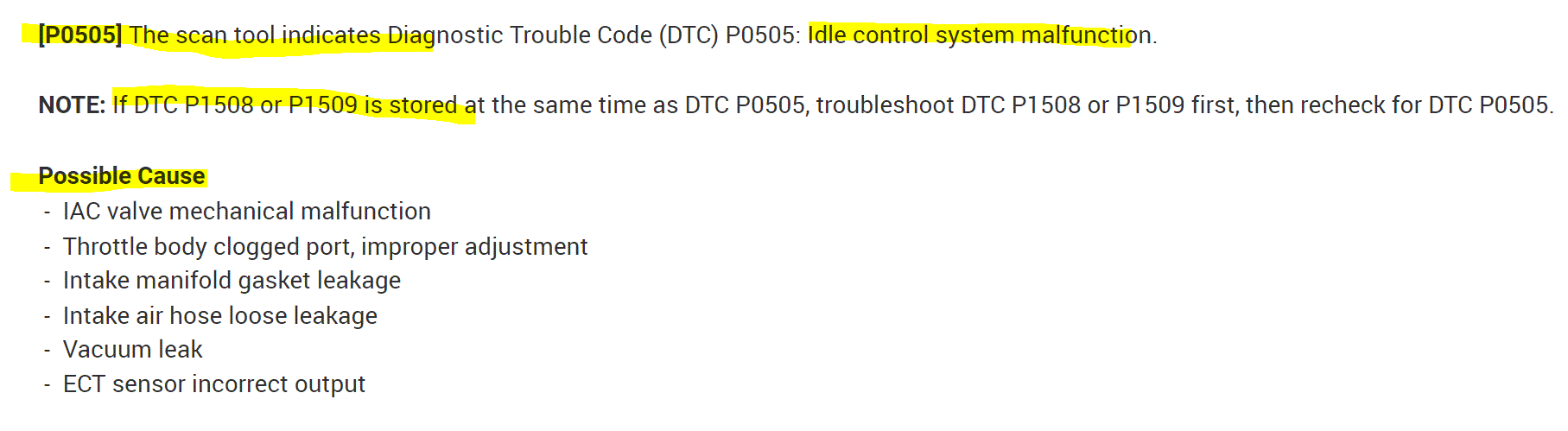

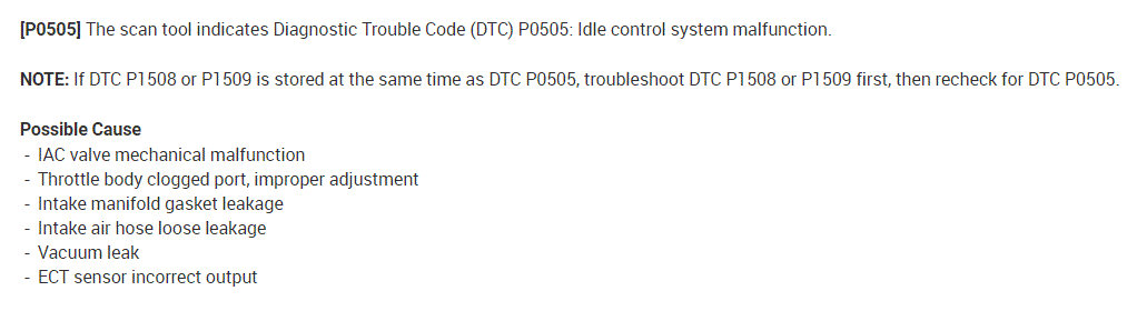

However, this is where the manuals are conflicting. If the code is present, according to the manual, it's related to a faulty IAC valve, vacuum leak, coolant temperature sensor, or clogged port in the throttle body.
The only way I find anything on a possible PCM/ECM issue, is if P0505 is not present. When the code is present, the manual identifies specific possible causes.
Take a look at the two pics I attached and let me know your thoughts. Also, let me know if you cleaned the ports on the TB, confirmed the ECT signal is within spec, and if you are using the original throttle body.
See pics 1 and 2 below.
Oct 5, 2021 at 6:39 PM

The idea that it is the same is likely indicating the problem part was never changed. I don't like to say it's the PCM, but that is what is left. The manual is saying no, but if everything other is good, it is pointing in that direction.
The noise you hear from the exhaust, could it be a backfire? Also, by any chance can you get a substitute PCM to try?

Are you certain the throttle plate is fully closing and there are no vacuum leaks? I know you indicated checking, but I want to confirm.
Also, if you perform the portion of the test I highlighted below, what happens?
Oct 12, 2021 at 5:22 PM

Okay, I erased the p0505 code yesterday and today I plugged/covered the lower port hole on throttle body and the idle went down but it did not stall/shut off when I covered it. After like 10ish minutes the code p0505 popped up again and this was the freeze frame

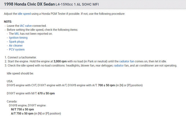

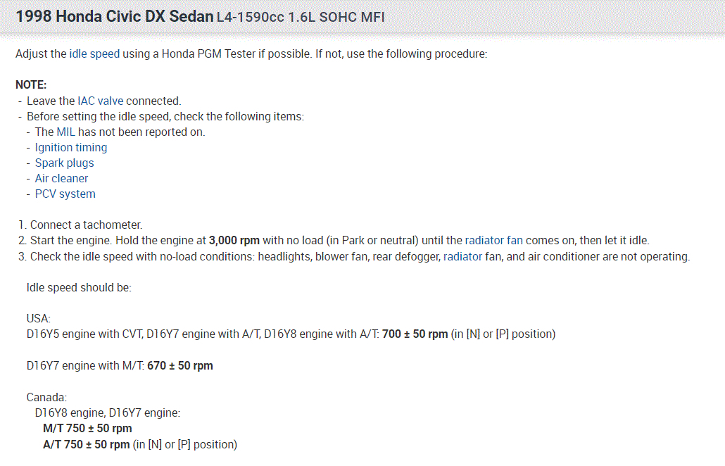

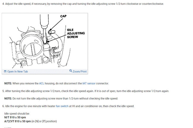

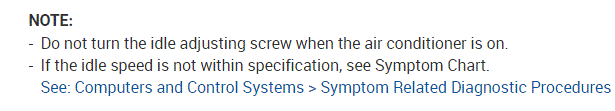

If the idle dropped, the next thing is in the procedure is to set the idle speed. Have you tried this? See pic below.
Oct 13, 2021 at 5:46 PM
LUIS MEDINA
  • 27 POSTS

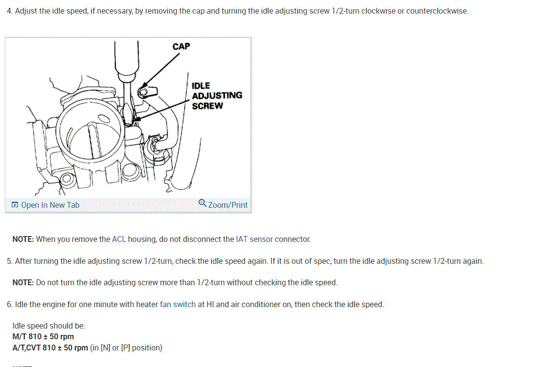

I moved that screw before but don't know how to adjust accordingly to manufacture specification.
Oct 13, 2021 at 6:01 PM

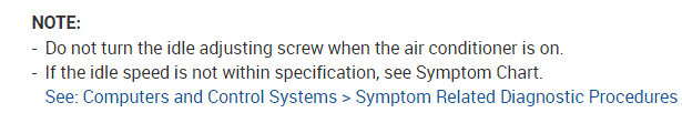

Take a look at the pics below and let me know if that helps.
See pics below.
Oct 13, 2021 at 6:21 PM

Went to the junkyard again and got a OEM distributor because I currently had a aftermarket one which I replaced two times in the past and as soon as I installed the OEM one it didn't misfire on all cylinders like before. I'm hoping that was the problem as for the idle it stays at 1,500 RPMs and drops down slowly as the engine is warming up and idles 1,000 or slightly below 1,000 the screw didn't really do anything. also, when I shift to drive or reverse it drops to like around 750-800ish.
Oct 14, 2021 at 4:25 PM
Has the code (P0505) returned? This is good news! The idle can be lowered with the screw I mentioned. That determines how much air is allowed past the IAC valve. See if you can adjust it more now that it's running properly.
However, what you indicated the idle speed to be really doesn't sound too bad. A little high, but not bad at all.
