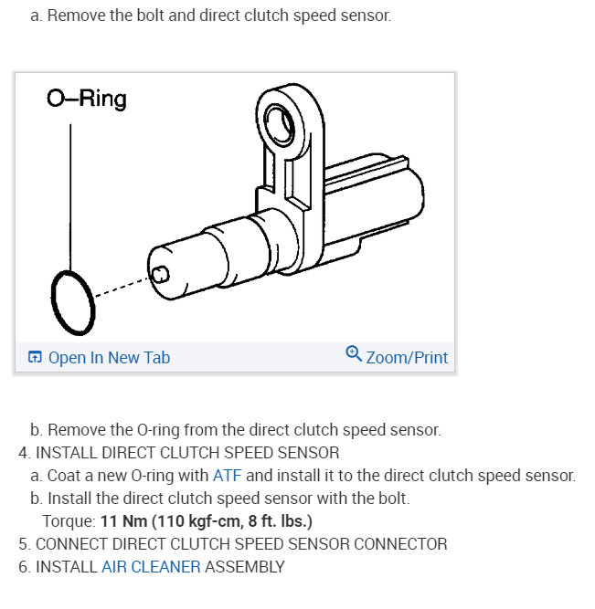

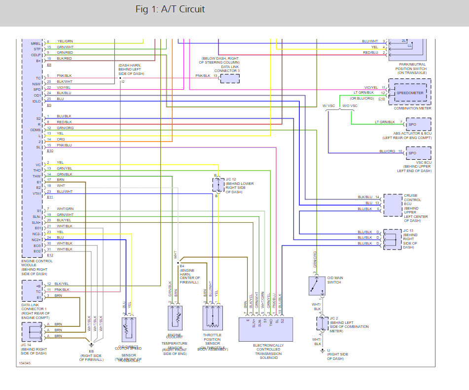

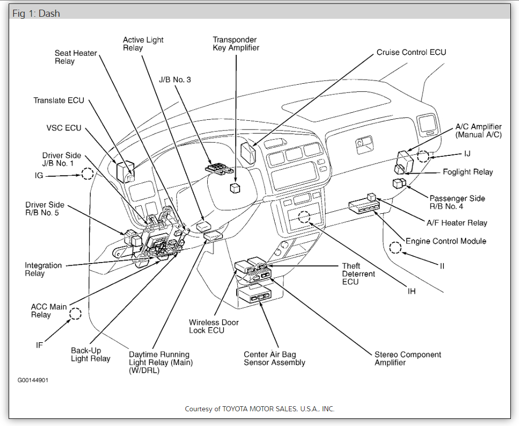

Hello, my name is Frank. I took my van for emissions and it failed p0500 code. Which is a speed sensor. I changed the sensor twice and it still failed. How many speed sensors does the van have? The cruise control is not working, odometer is not working.
