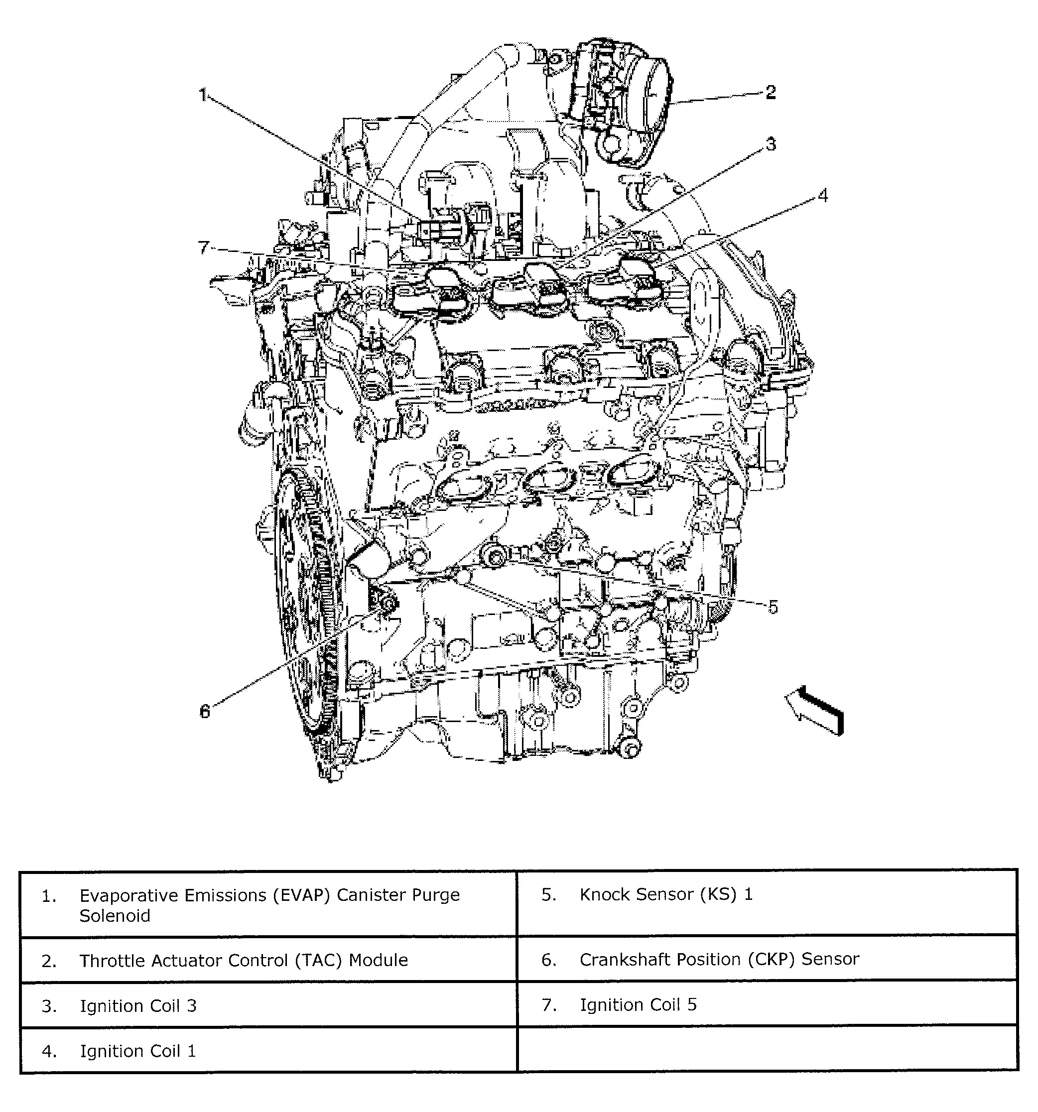

Where is the Purge Valve Solenoid located on the 2008 XL-7?

It's on the top of the intake. See pic attached.
