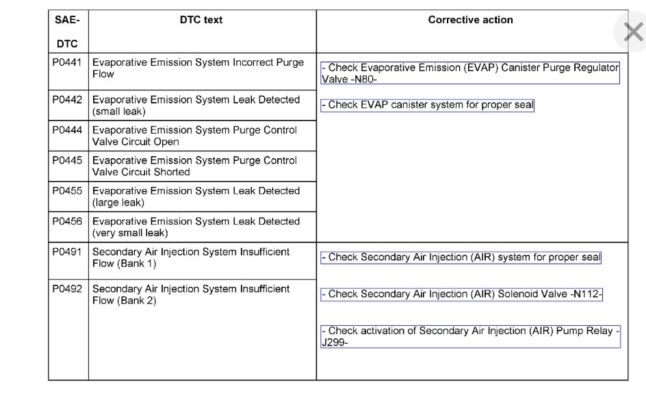

What is the problem with this car and are they related?
Feb 29, 2020 at 11:16 PM
CERTIFIED EXPERT
52,796 POSTS
Good morning,

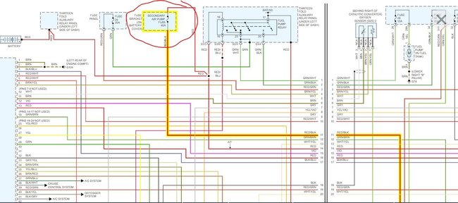

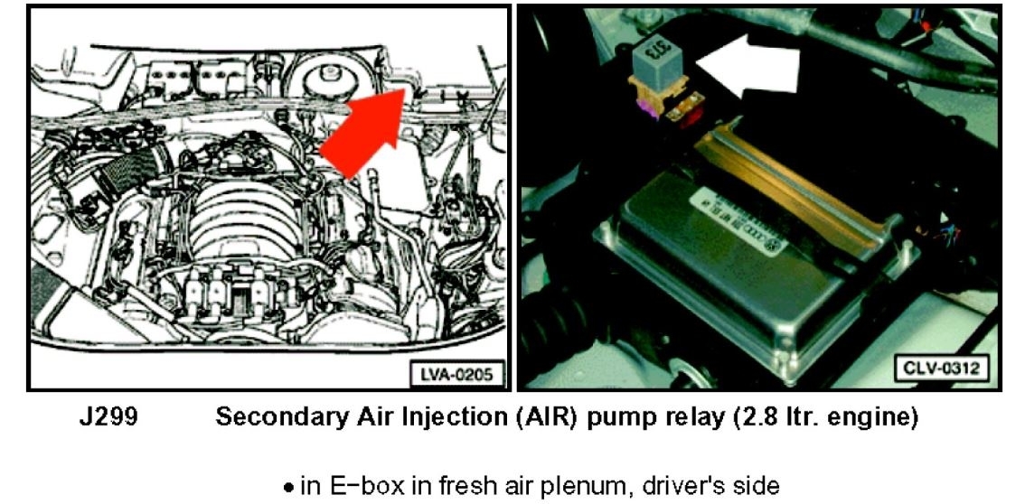

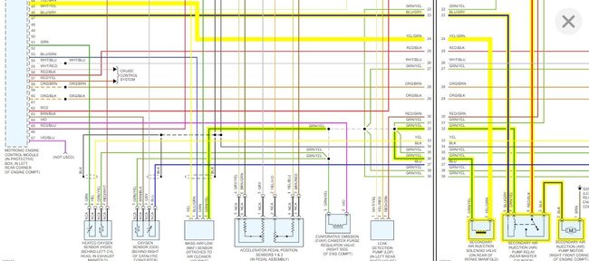

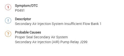

491 and 492 are for the secondary air injection system. It could be the relay or the solenoid. There are also cases that have the passages clogged with carbon. It is difficult to get to the passages as they are at the back of the motor.
the 456 is for an emission leak in the evap system. The system needs to be smoke tested to find the leak.
