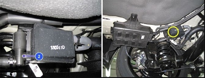

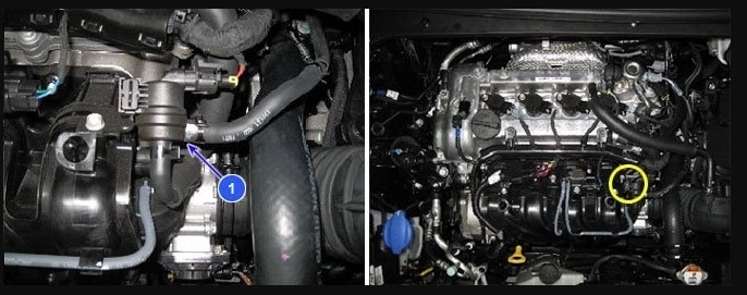

A P0455 is a large EVAP leak. You don't really need a better scan, just the tools to find the leak. The first thing I would do is check the purge solenoid on the engine end ( image 1), if it's stuck open you can get this code, but usually that one will also make the engine hard to start when you fill up with gas. Testing is simple, one hose goes to the intake manifold for vacuum. The other goes to the fuel tank. Remove the second line and start the engine. Hear a vacuum leak? Put your finger over the hose fitting, feel vacuum? Unplug the electrical connector, if you hear or feel vacuum, it's stuck and needs to be replaced. Next test, go under the vehicle and locate the charcoal canister and its vent valve (image 2). It should be open, but if you unplug it and apply battery power to the two pins it should click shut. With it shut it should not pass air. If it's stuck open it will cause a large leak and that is the common failure mode with those valves. If your tool can read any live data and one of the pids is fuel tank pressure or pressure sensor voltage, you can test this by applying voltage to the solenoid in the rear and in the front. That would be the same as the purge & seal test the OE tool does, if the pressure sensor, then shows a drop as the vacuum pulls the tank clean, you then disconnect the power to the front valve. It should hold the vacuum for a long while, if not you have a leak. Clamp off the line coming from the tank valve to its vent and test again. If it holds now the vent solenoid is leaking. If you have access to a smoke machine or similar you can also use it to find leaks in the lines and hoses.
