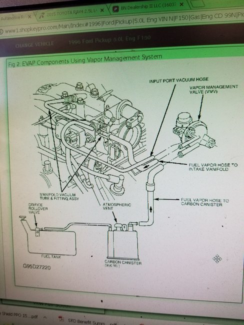

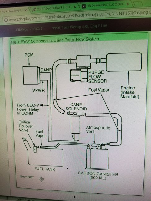

I posted a diagram of where it is.

This truck does not have one at this location. I have seen this diagram before and none of the vacuum hoses match. The truck has no pressure sensors in the gas tanks or a purge valve on the canister. The system looks like what ford calls a probe system but it has no purge valve on the charcoal canister. I replaced the vacuum control valve now the problem is intermittent, but I still get a p0443 code.

That is from the wiring diagram for your truck it is called a vapor management valve in the wiring diagram.

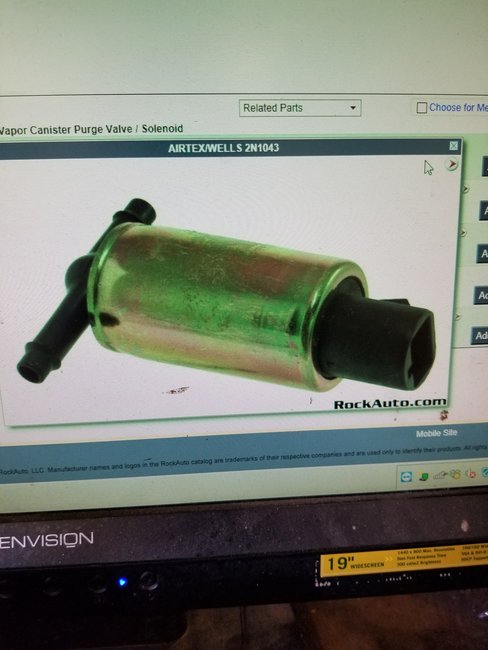

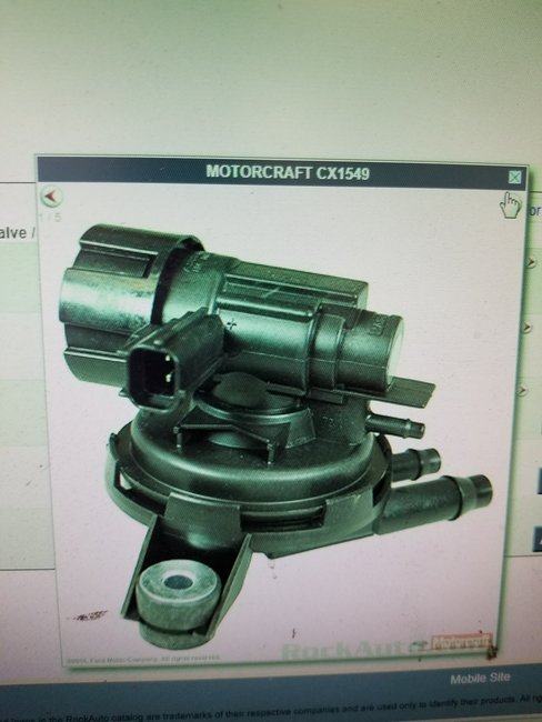

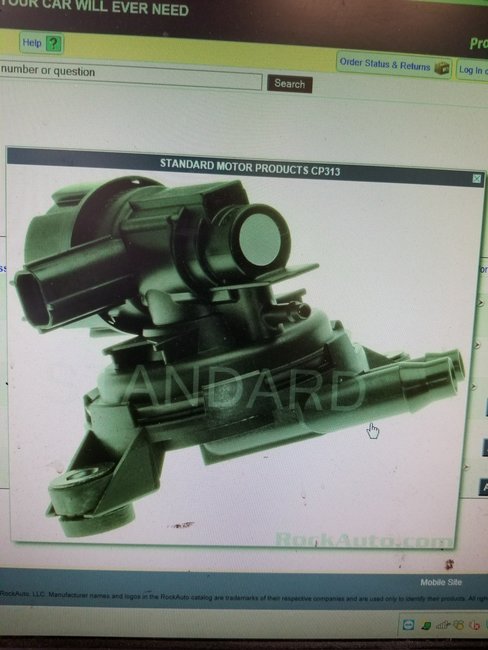

I posted the three types of valves they use on your truck.

That is what i replaced the vapor management valve. Could i have a vacuum leak with this code? i cannot find a canister purge valve. Thank you
Oct 24, 2017 at 1:38 PM
SATURNTECH9
  • 30,869 POSTS

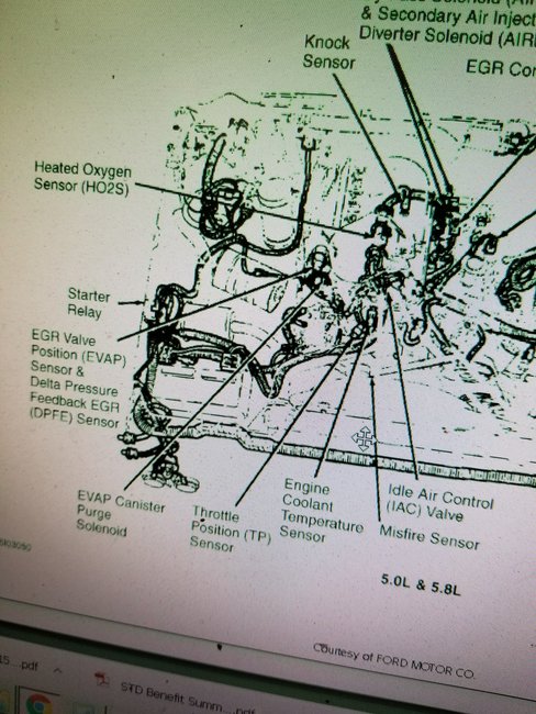

Yes, you might have a leak. I posted a couple more diagrams that will be helpful I would say the management valve would be the equivalent to the canister purge valve.
Oct 24, 2017 at 1:50 PM
FREDNAN
  • 4 POSTS
The diagrams are what i have. I am searching for leaks now. Thanks for the help. You confirmed that there is no separate vent purge on this truck. Thanks again.
