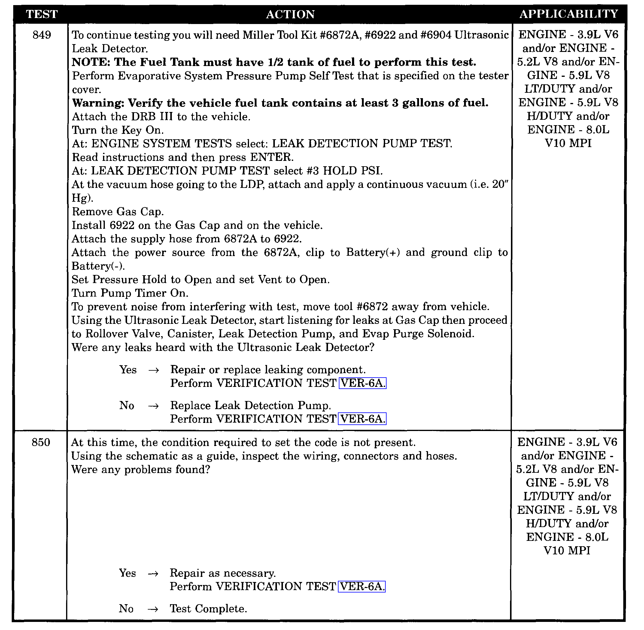

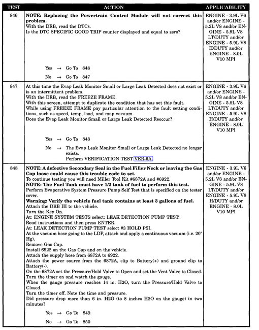

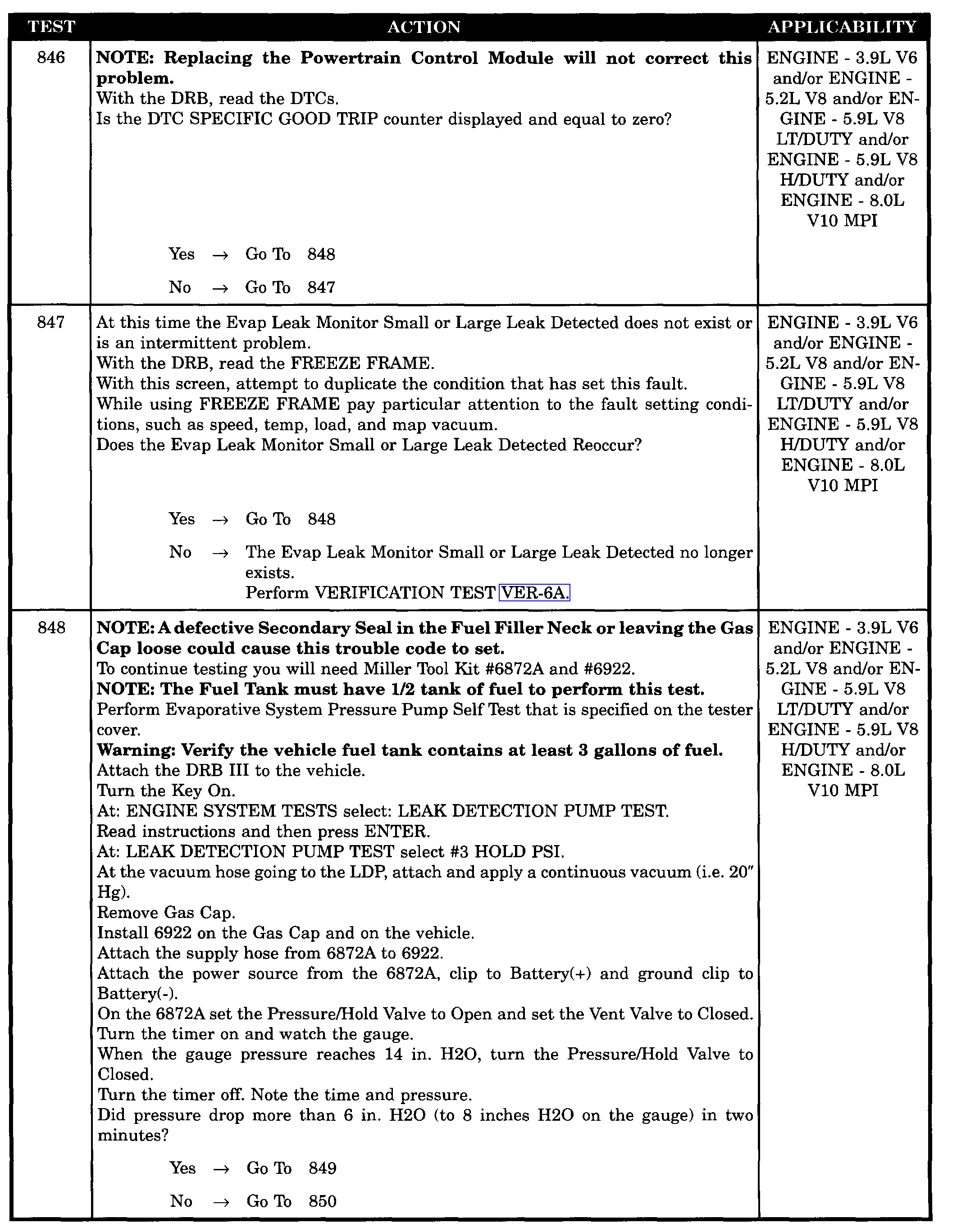

Here is the diagnostic flow chart for the code. It does require a scan tool that can actuate components. The attached pics correlate with these directions.
_____________________
1999 Dodge or Ram Truck RAM 1500 Truck 4WD V8-5.9L VIN Z LDC
P0442
Vehicle ALL Diagnostic Trouble Codes ( DTC ) Testing and Inspection P Code Charts P0442
P0442
Tests 846 - 848
see pic 1
Tests 849 - 850
see pic 2
SYMPTOM
P-0442 EVAP LEAK MONITOR SMALL LEAK DETECTED
WHEN MONITORED
Immediately after a cold start, with ambient temperature between 40 degrees F and 90 degrees F and coolant temperature within 10 degrees F of ambient temperature.
SET CONDITION
If there is a leak larger than 0.040" and smaller than 0.080" in the evaporative system.
POSSIBLE CAUSES
- Evap system hoses or wiring damaged
- Evap system component leaking
- Leak detection pump leaking
- Evap leak monitor small or large does not reoccur

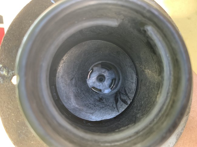

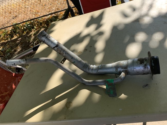

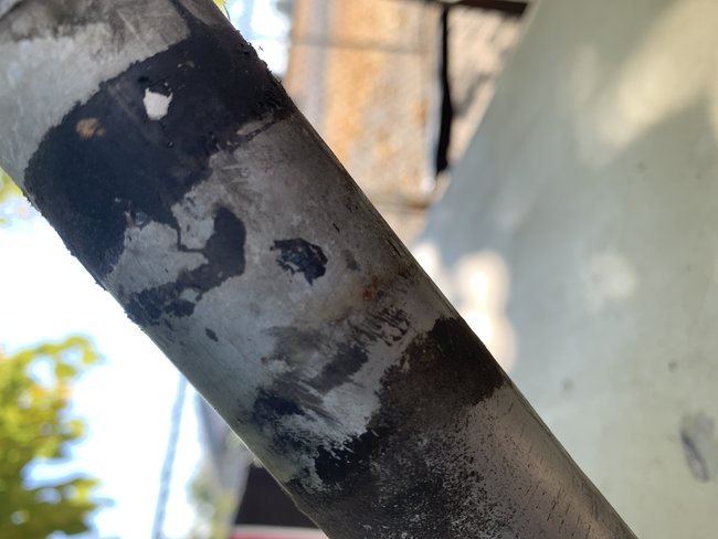

So I looked and I didn’t see any rust or damage, I also checked the hose but it looks in good condition as well. I was taking pictures to show and while doing so noticed that there is a small amount of rust. Do you think it’s enough to cause a code to pop up?

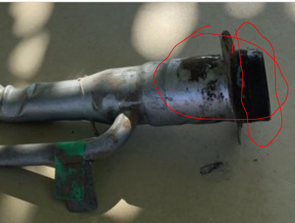

I copied one of your pics and circled an area of concern. Check that area for pin holes.
Nov 2, 2020 at 6:05 PM
Sorry, but for some reason, my pic didn't attach. Take a look below.
Let me know how things are going.
