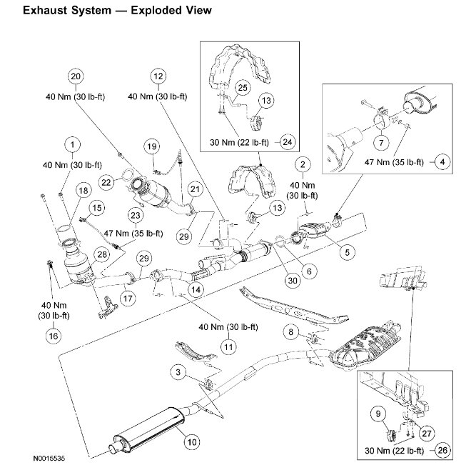

Catalytic system efficiency below threshold, can I get a diagram listing the bank 1 and 2 location. Can’t remember off the top of my head.

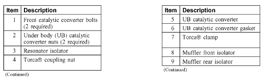

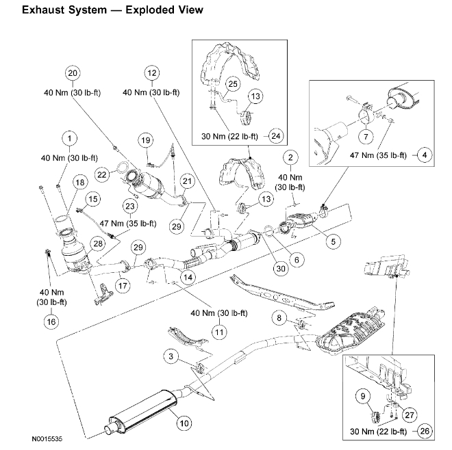

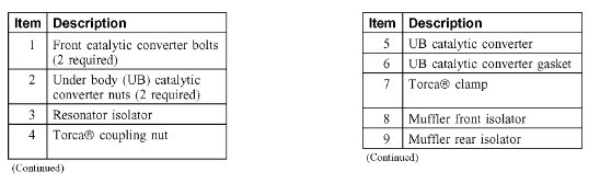

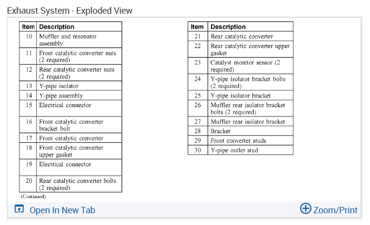

Sure, here is the bank1 and bank2 catalytic converter locations. Check out the images (below). Let us know if you need anything else.
