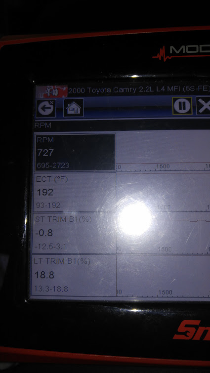

LTFT remains above 15%, although before the above items found leaking during smoke test, it was above 18%

I'd like to explore all avenues (as it may have been misdiagnosed to begin with) before I condemn a second cat. It appears they're working and doing their jobs on these o2 graphs.
Does anyone have thoughts or advice on this high fuel trim? Are there places to check that may not have shown up on the smoke test? Anything I can smoke individually?
