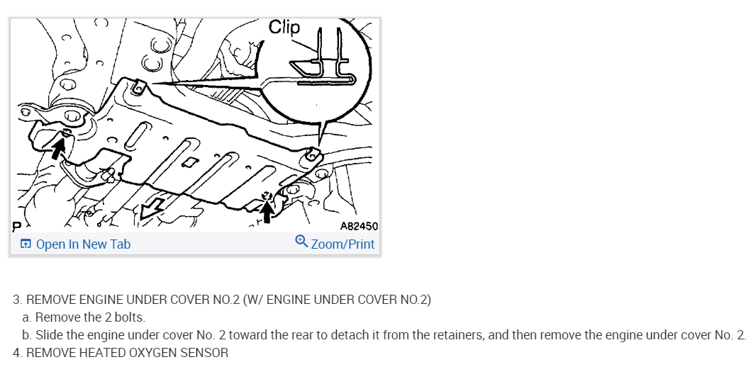

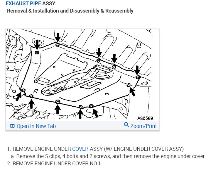

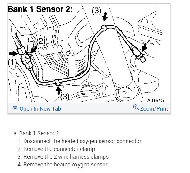

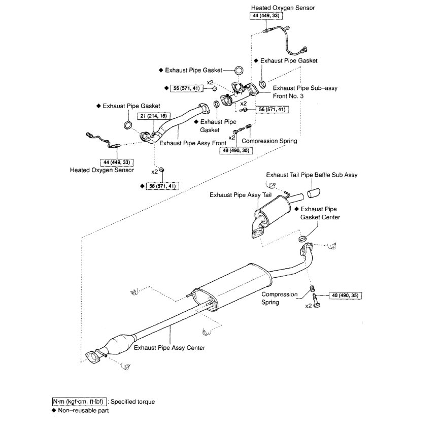

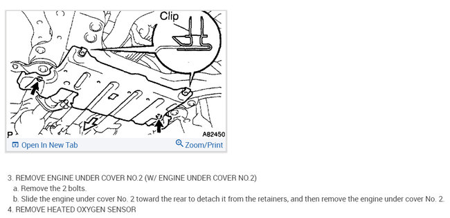

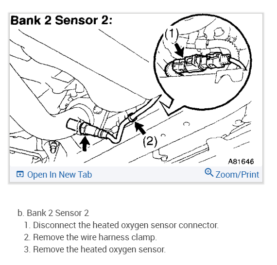

I agree with Danny it will not hurt the car. Here is a step by step guide on how to replace it with diagrams below to show you how on your car:
https://www.2carpros.com/articles/catalytic-converter-replacement
Check out the diagrams (below). Please let us know if you need anything else to get the problem fixed. Clear the codes once you are done.
