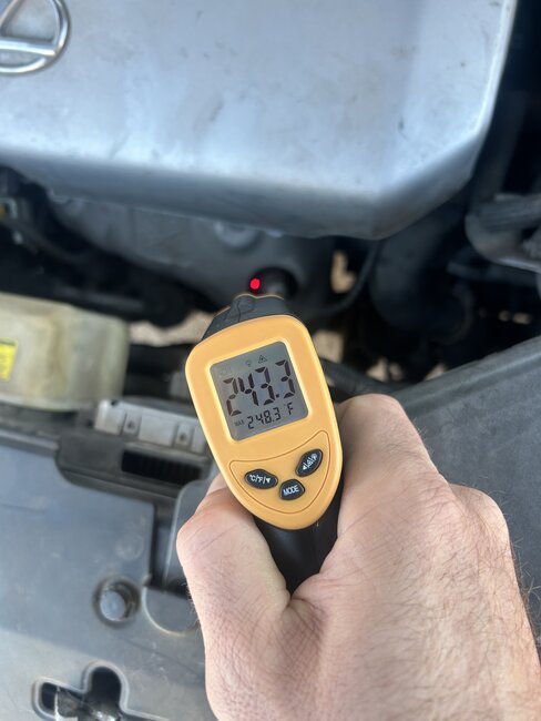

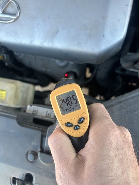

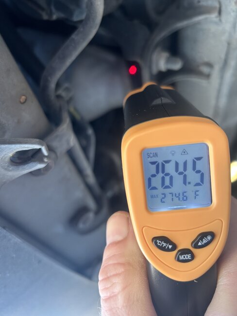

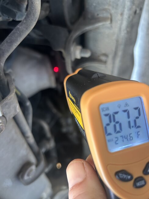

Hey Joe, here are my results. The temp would fluctuate at the inlet and outlet of the cat, both higher and lower than the temps i was able to capture. What do you think? Is it shot? Or do you think it’s still good? Thank you!
Jan 13, 2026 at 6:30 AM
Yep, thanks for the images, that catalytic converter seems no good, I would remove the exhaust manifold and inspect the honey come inside. It is probably melted inside. Let us know, Ken

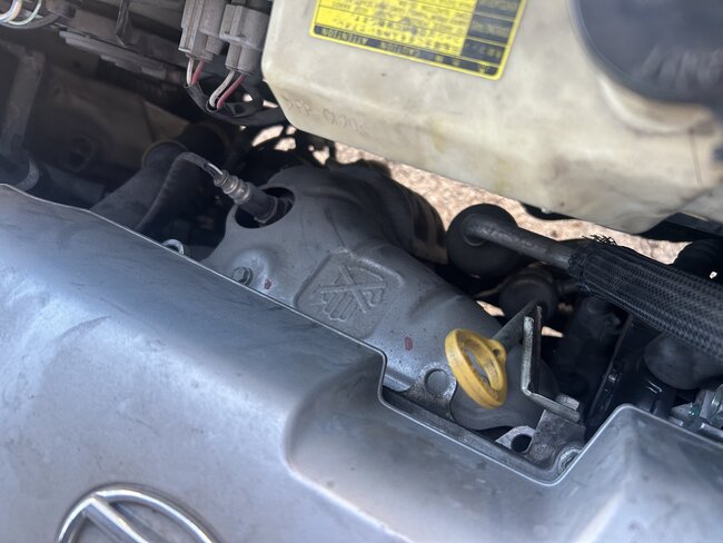

Hello, when I first made this post, I had cleared the code so that the check engine light isn’t on. It came on again yesterday and so I went to go clear it, and when I pulled up the code, it was P0420 of course but what I didn’t realize the first time is that it said bank one. The code said something like catalyst efficiency on Bank one below threshold. So I am writing to you guys to confirm that the rear side of the engine (2009 lexus rx350 v6) closest to the firewall is bank one, correct?
And if you scroll up in my previous messages, you’ll see that when I did the test on the catalytic converter at the front of the engine, that was bank two, correct?
Do you see where im getting at?
Jan 17, 2026 at 6:40 AM
Yep, I would check them both, but start with bank one which is near the fire wall.
