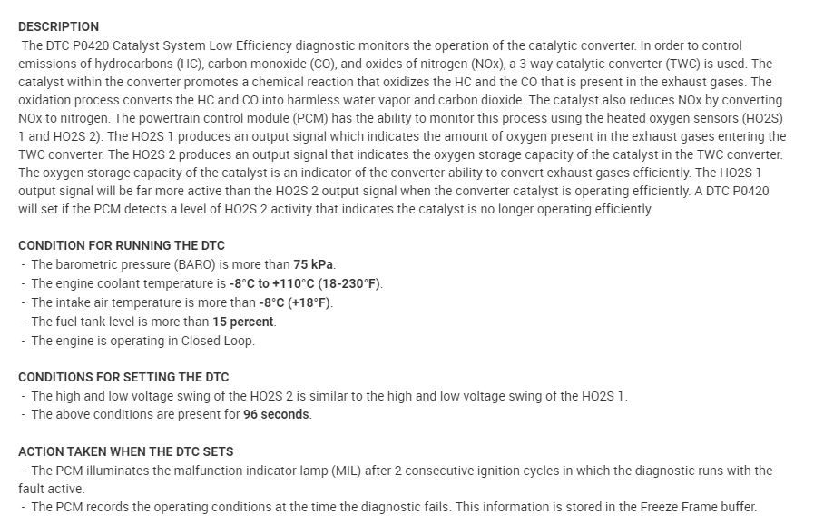

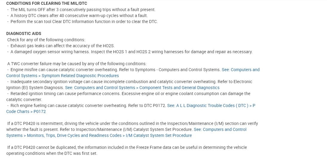

I took my son's car to O'Riellys for a diagnostic because the check engine came on and one of the codes that came up was P0420. Is that the catalytic converter or the O2 sensor? Thanks
