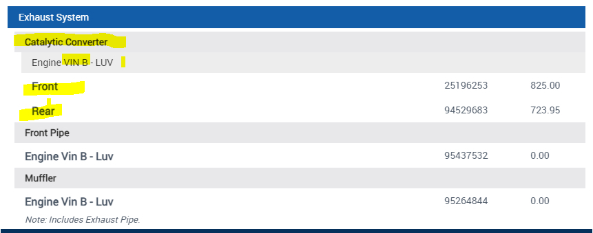

Hello, I have the P0420 code on my car. I have replaced the o2 sensor and have run Cataclean through it and the code has not cleared. When I called my shop, they said I have two catalytic converters, but I thought I only had one exhaust pipe. They asked me if I knew which one was the problem and are trying to get me to replace both. Do I have two? Is there a way I can figure out which of the two is bad?
I don't have symptoms like black smoke, and I don't feel like I have a hard time getting up to speed.
I'm lost and confused, please help.
Aug 2, 2023 at 7:41 AM
I need to know the 8th digit of the VIN number. I believe there are two converters. One is right off the exhaust manifold, and I believe the next is right before the muffler. Take a look and see what you find.
Also, I attached a pic of the parts if the 8th digit of the VIN is B. Note: there is a front and rear.

See pic below.
