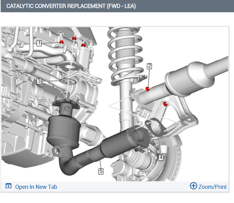

Here is what it looks like. Check out the images (below). Let us know what you find.
