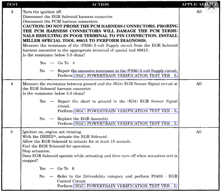

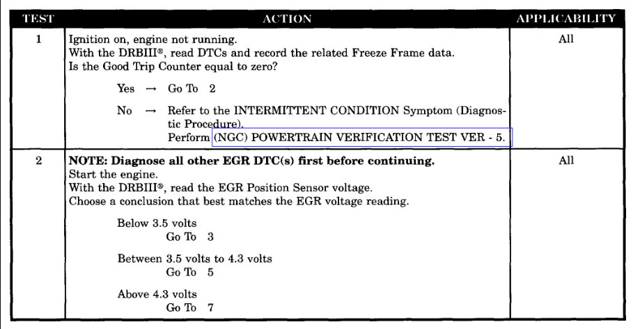

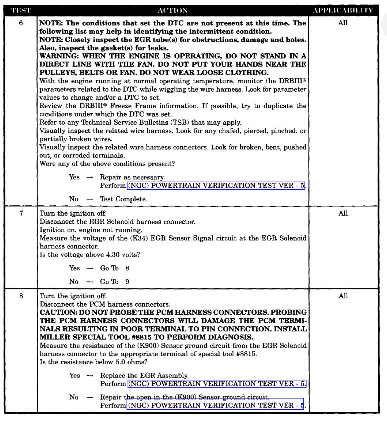

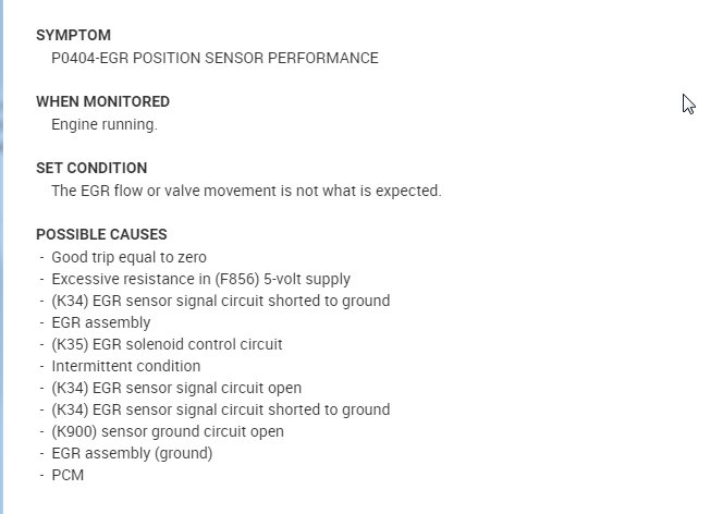

P0404 has come up three times in the last 10 months and has been reset in all cases. Once in Sept of 2019 and twice this past week. When should I become concerned with this code and what would be the best solution to take if the vehicle needs to be worked on. Thanks, Jim Felland
