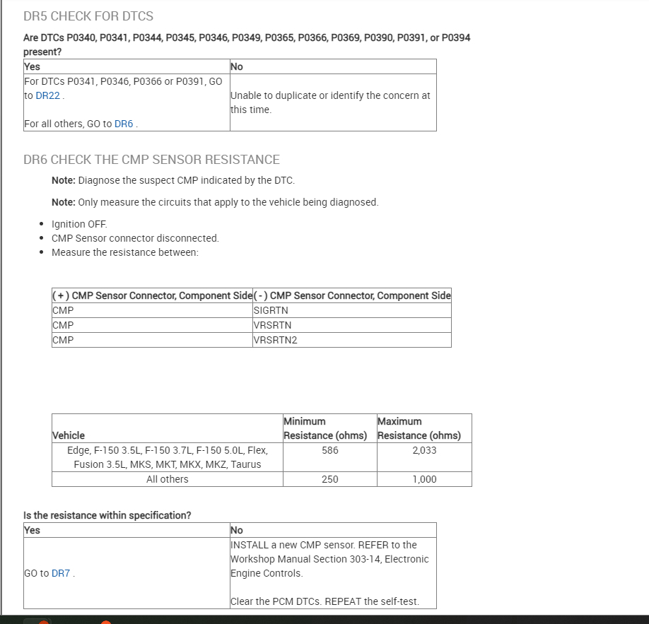

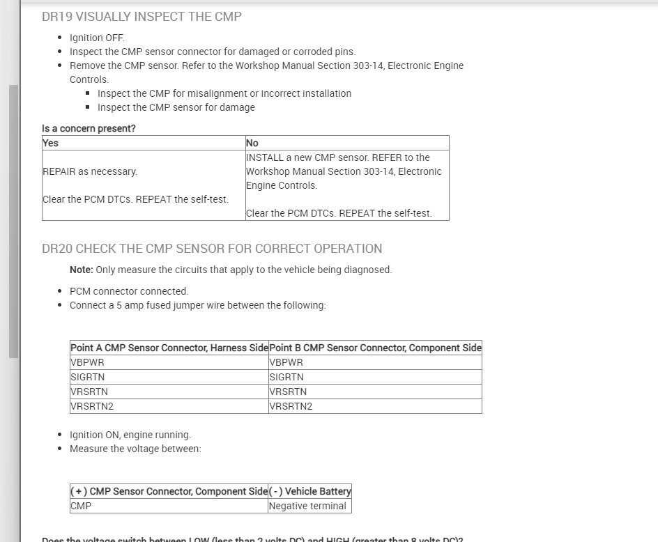

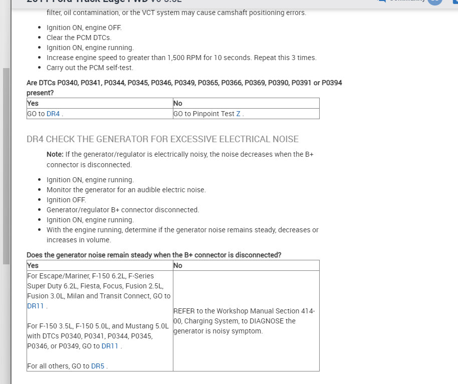

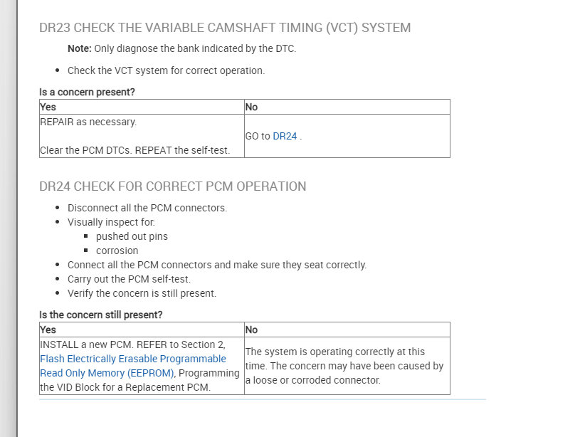

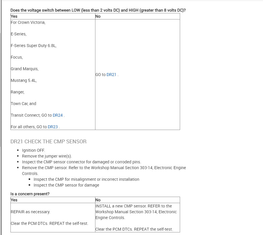

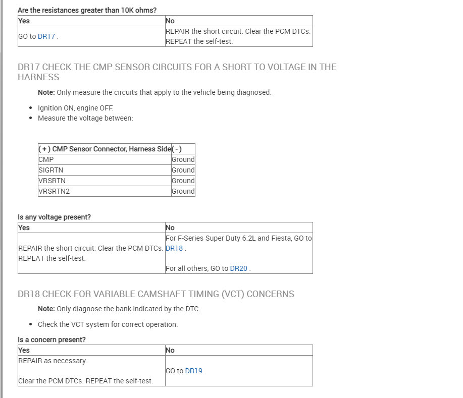

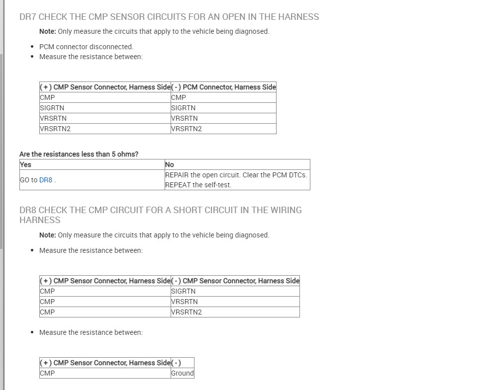

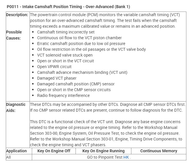

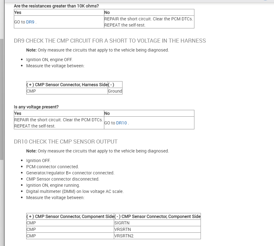

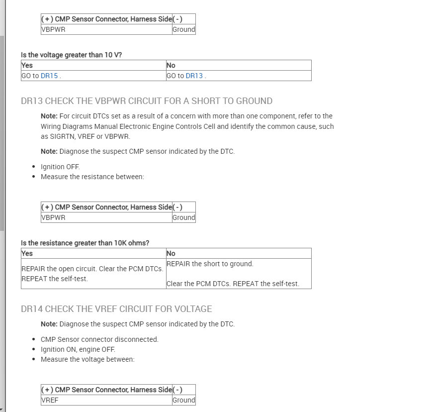

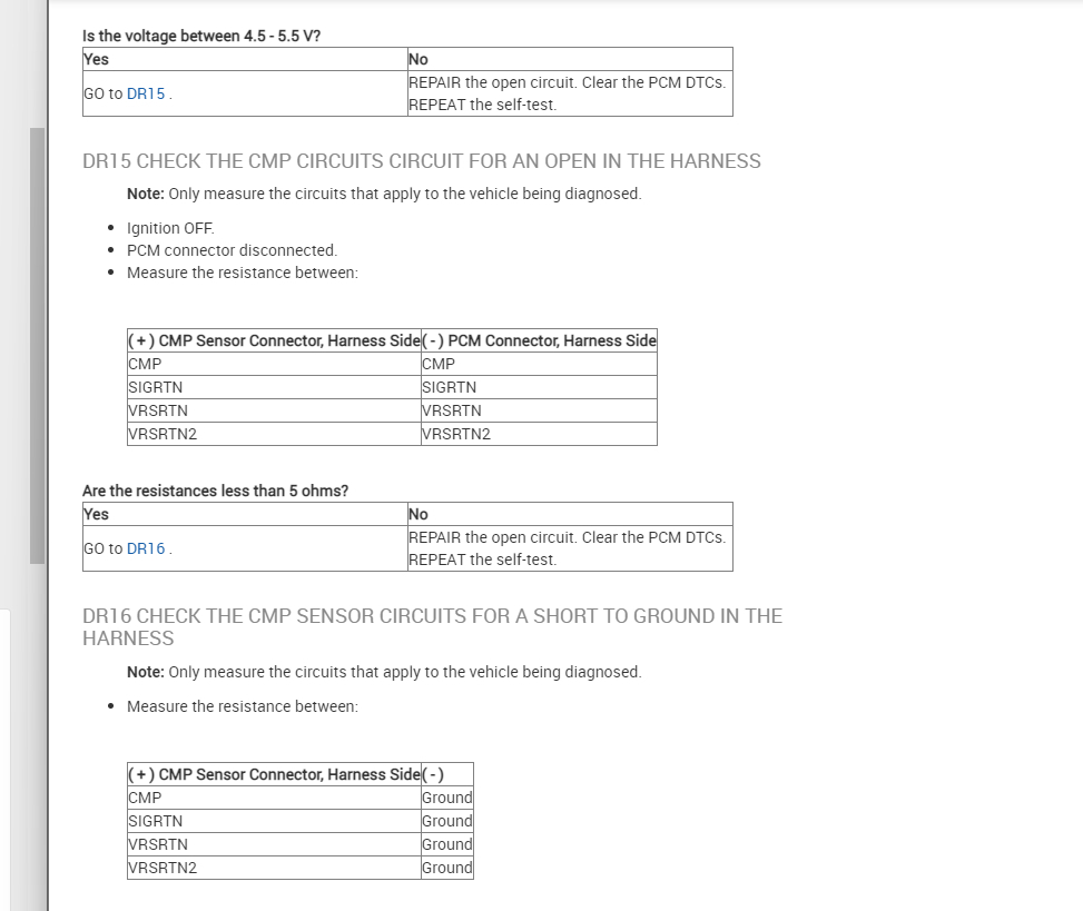

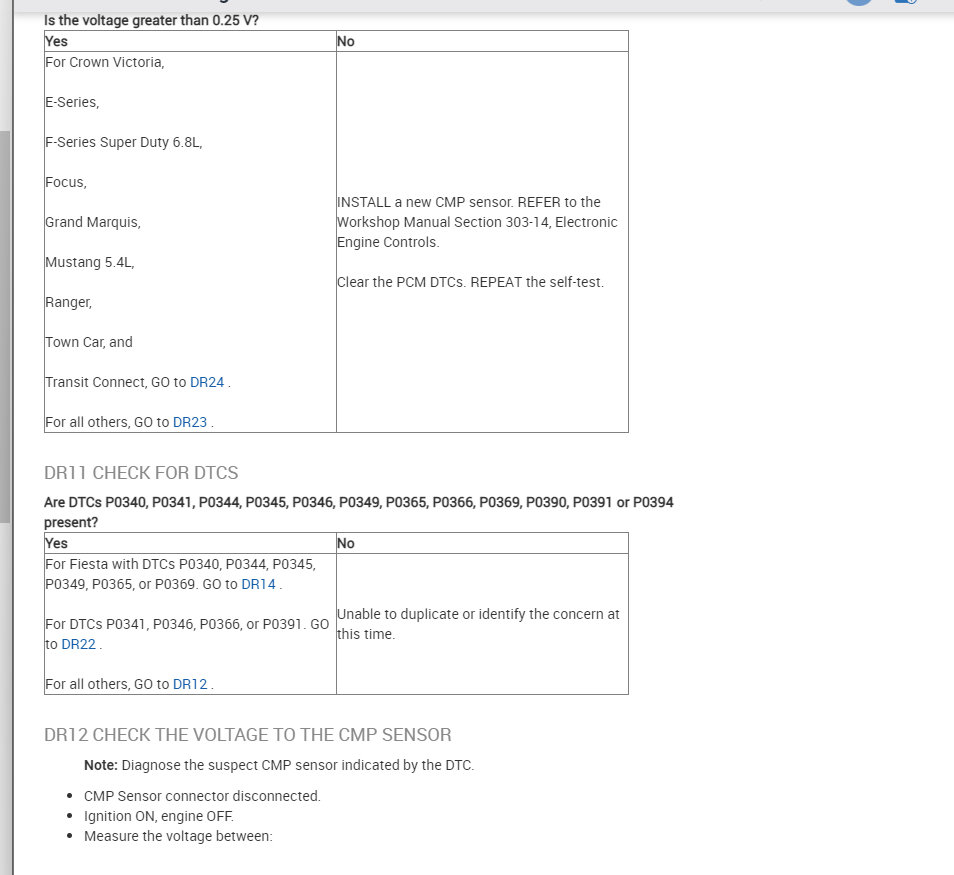

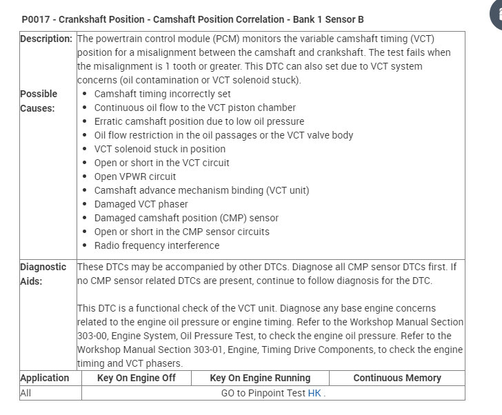

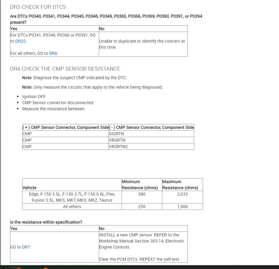

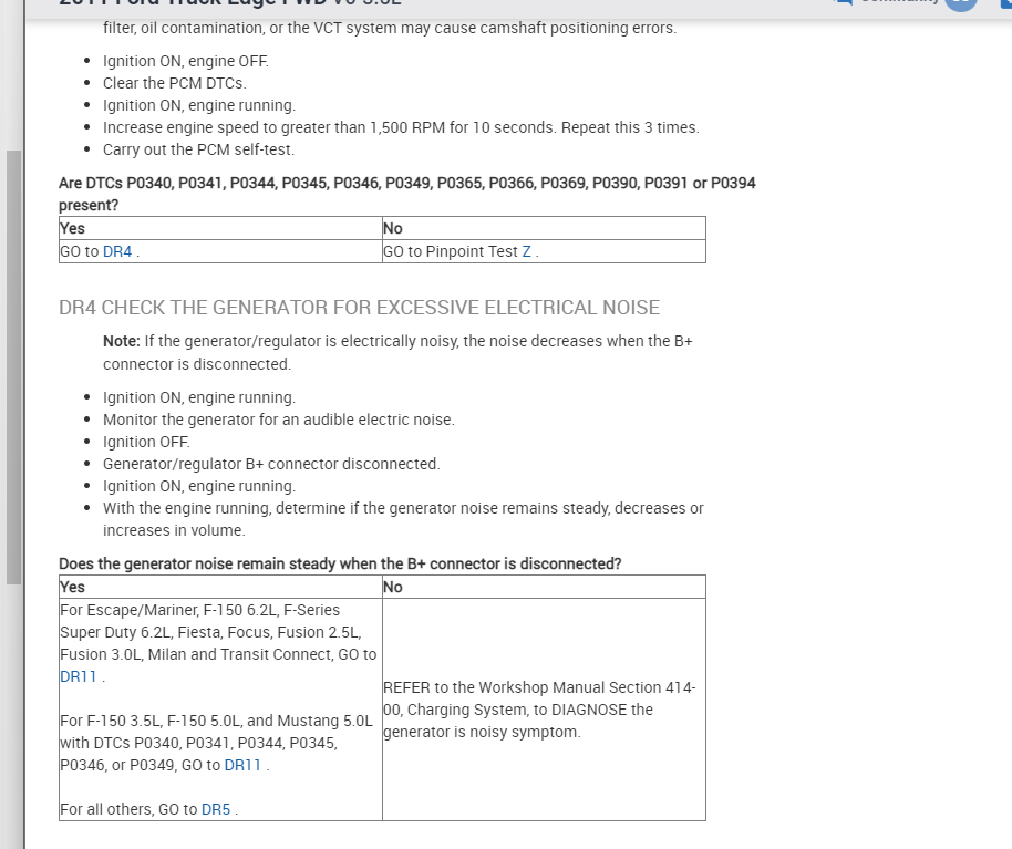

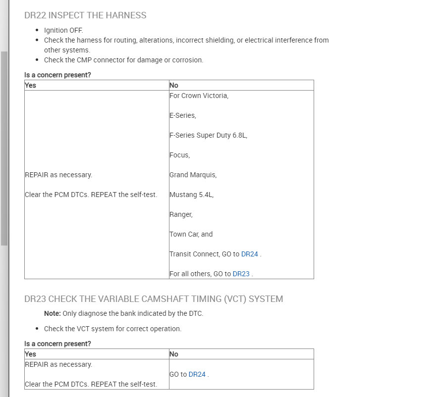

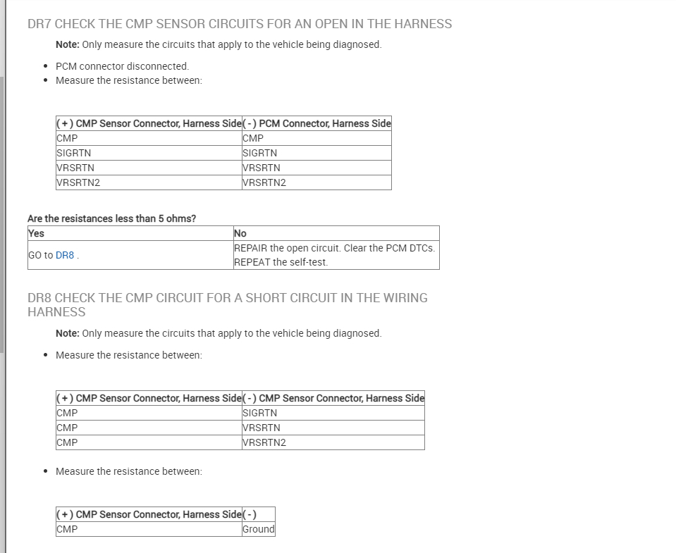

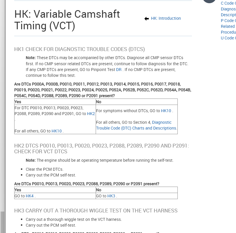

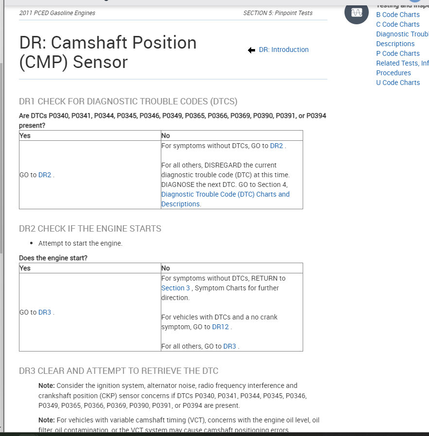

Otherwise, we need to run through the testing for these codes which is the same testing so I would just pick one of them and do this testing.

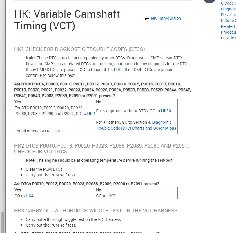

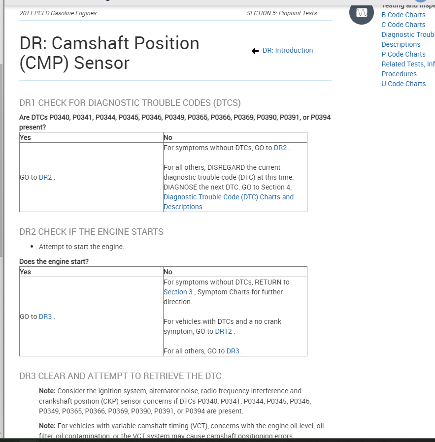

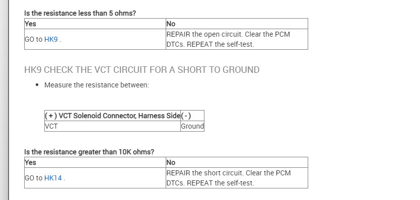

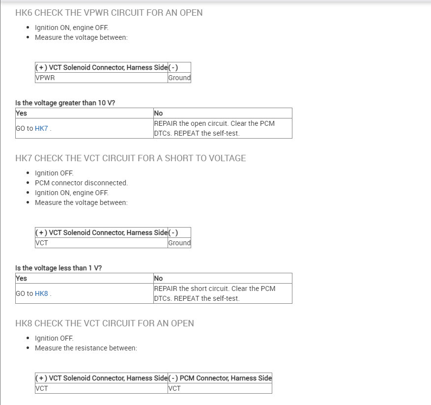

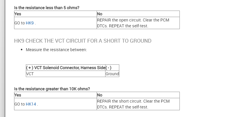

Here is a guide that will help with this type of wire testing:
Please run through this and let me know what you find. Thanks
