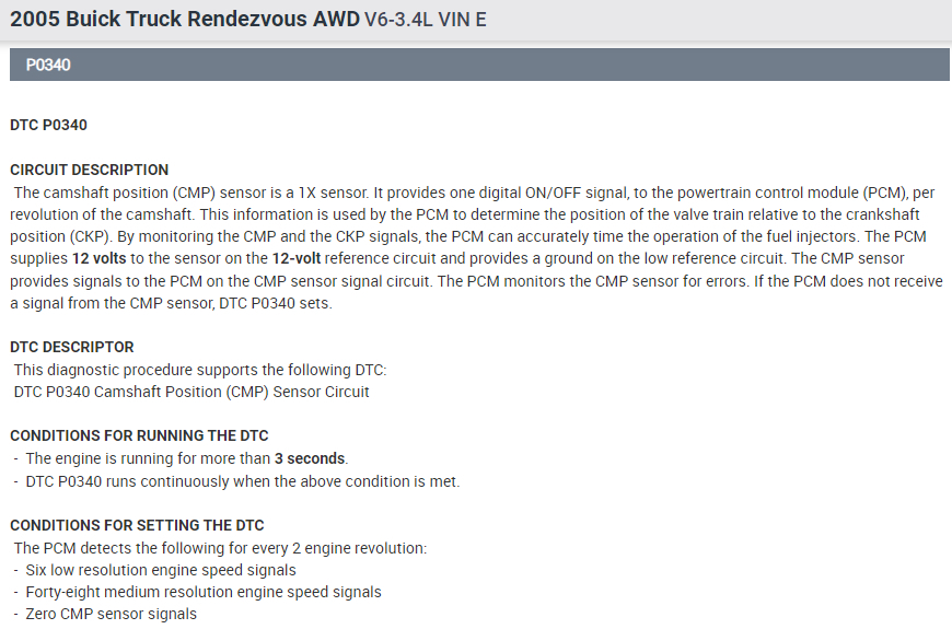

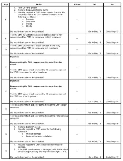

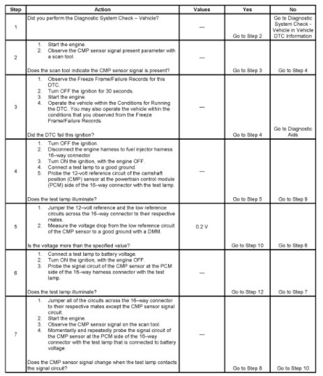

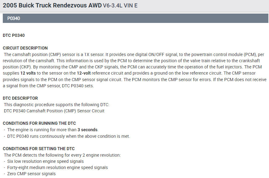

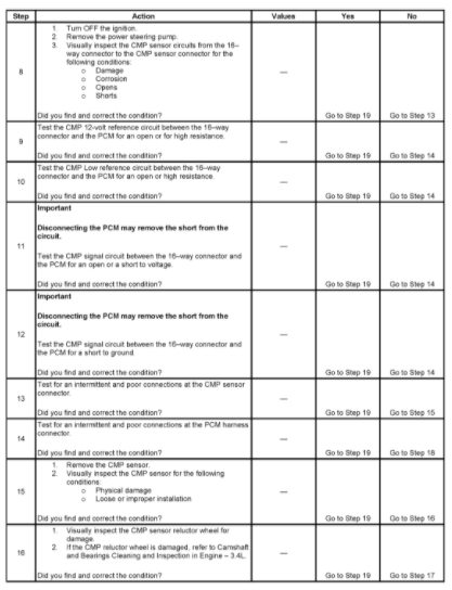

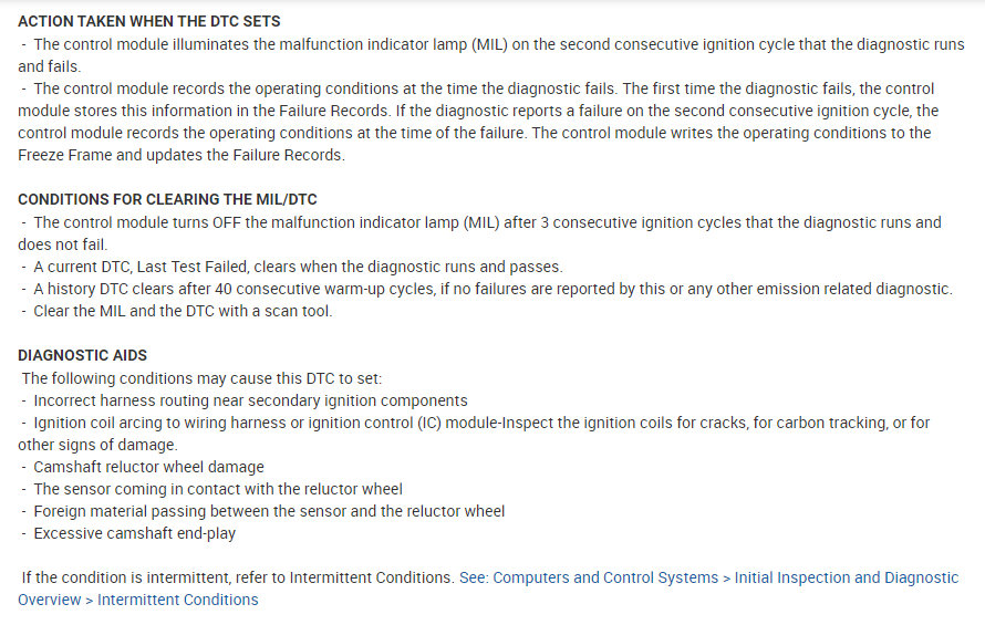

So I changed the cam sensor and pigtail.
it runs well, but I have to get this light off one way or another. any help please?
