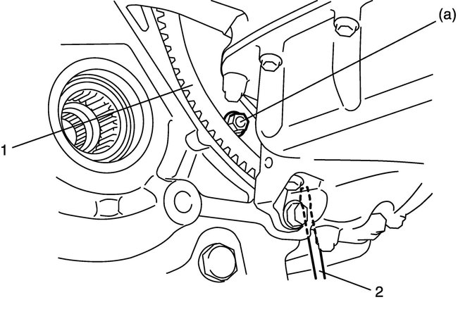

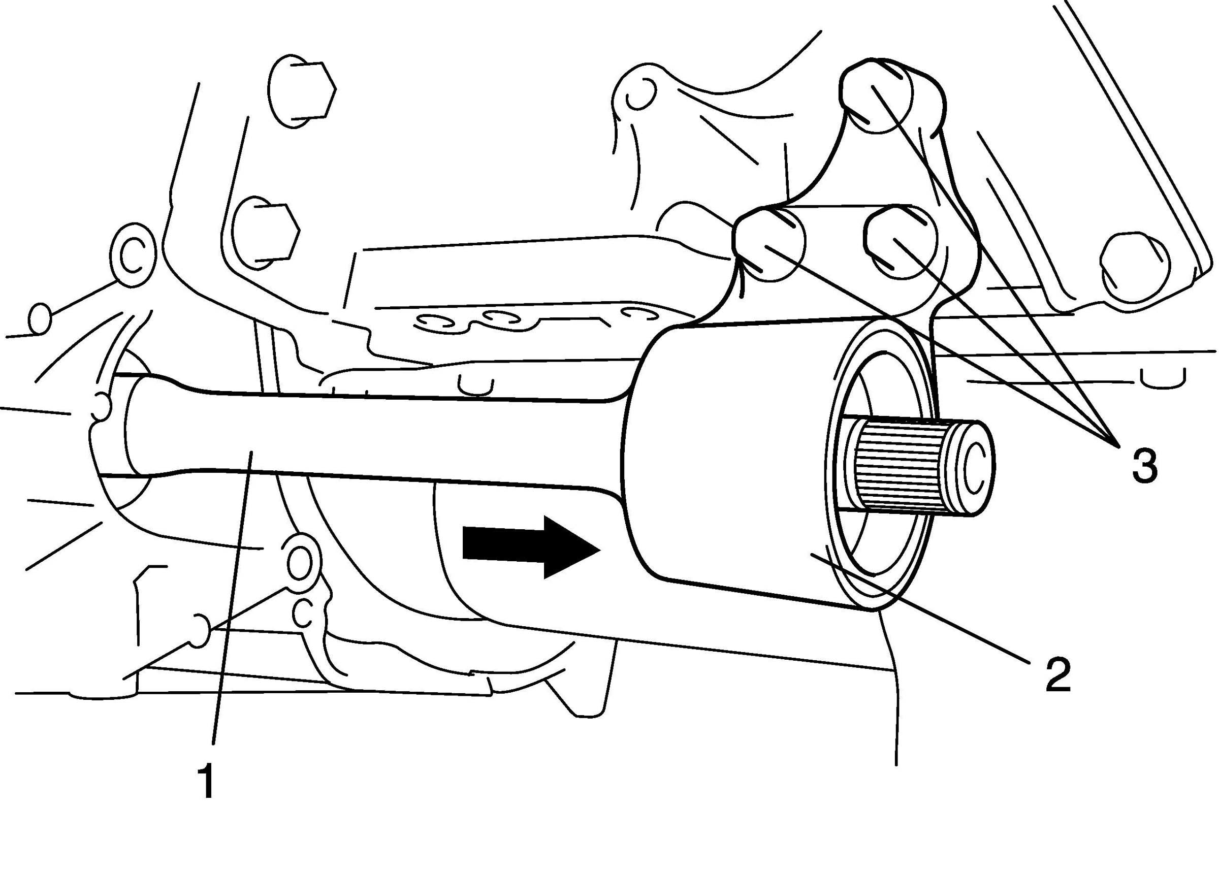

4. Remove center bearing support bolts (3) and remove center bearing support (2) with center shaft (1) from differential side gear (for 2WD vehicle).
pic 2

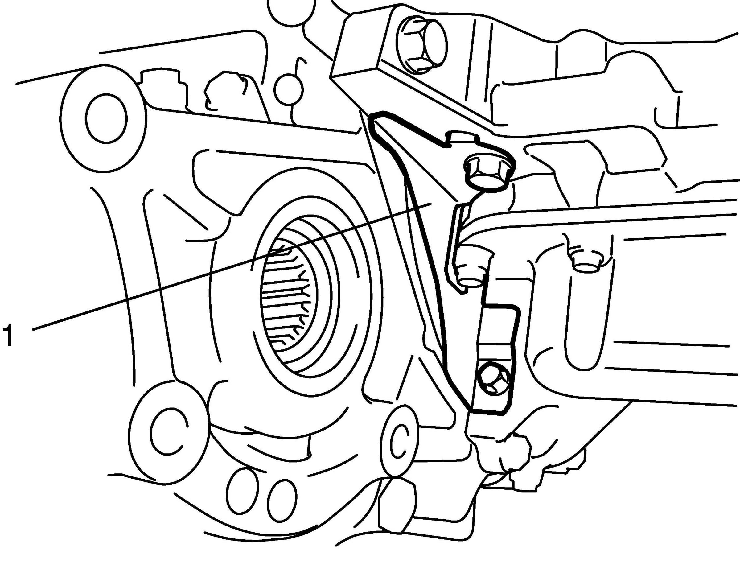

5. Remove clutch housing plate (1).

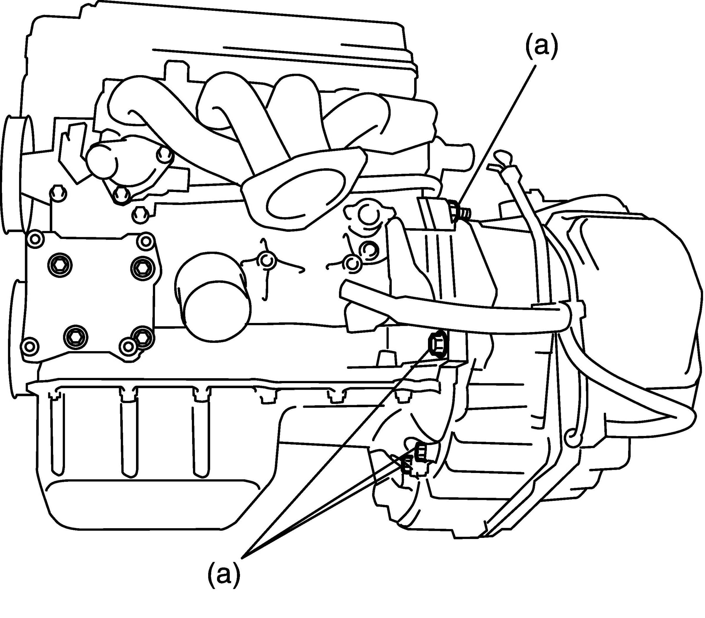

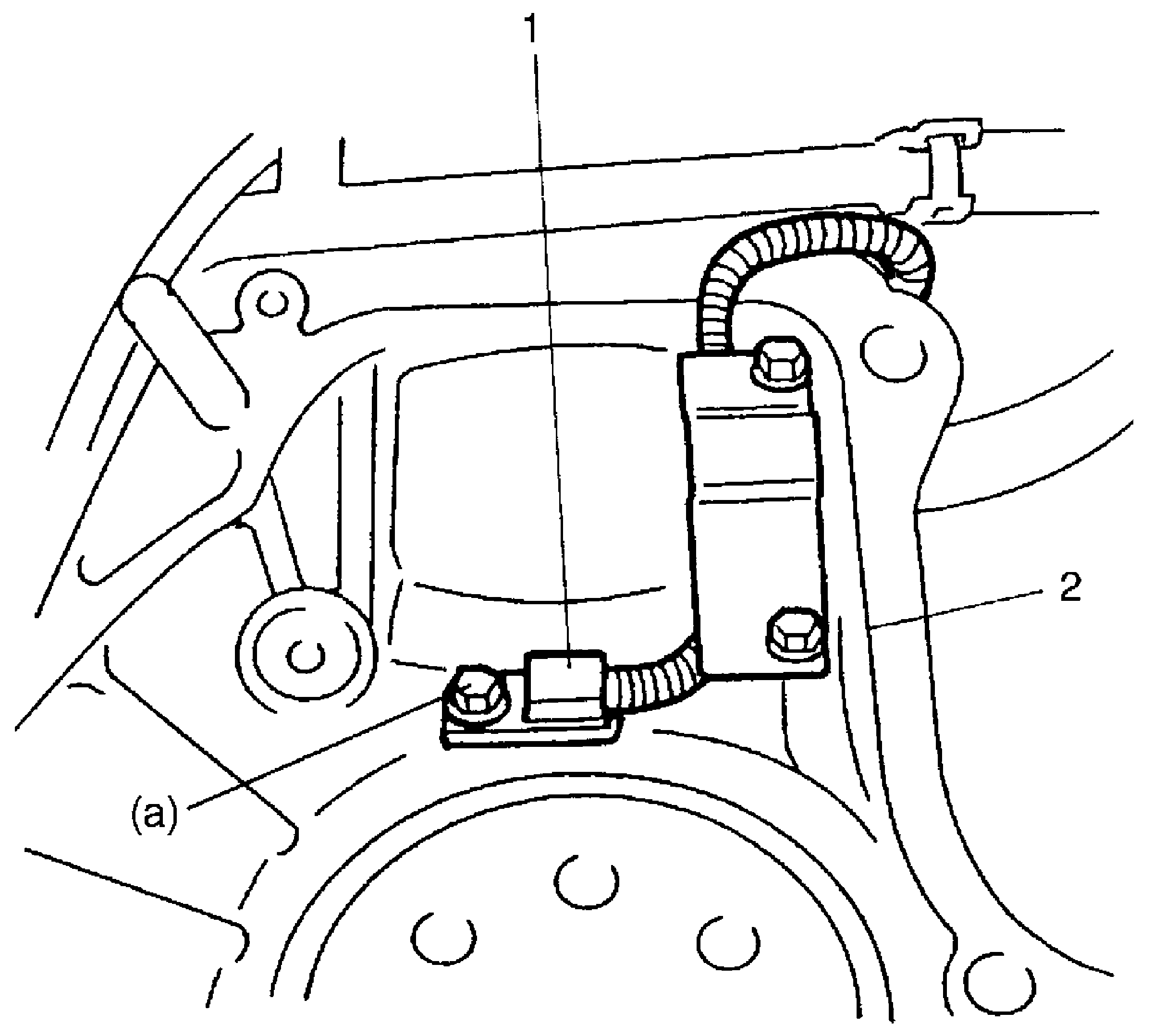

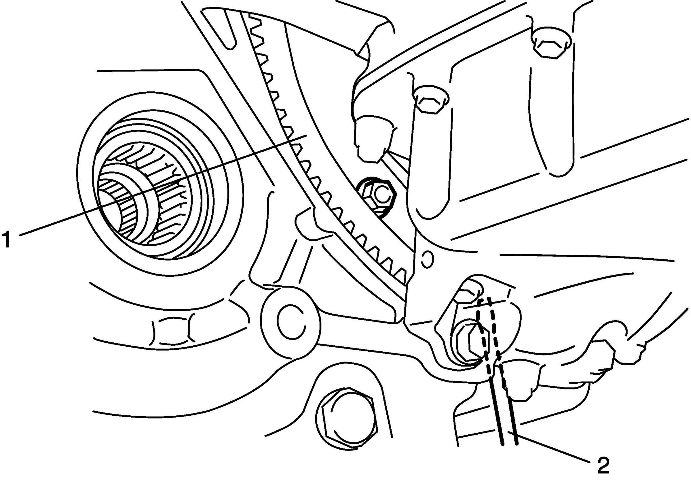

6. Remove torque converter bolts.
To lock drive plate (1), engage a flat head rod or the like (2) with drive plate gear.
pic 4
7. Remove starting motor.
8. Remove bolts and nut fastening engine and trans-axle, then detach trans-axle from engine.
NOTE: When detaching trans-axle from engine, move it in parallel with crankshaft and use care so as not to apply excessive force to drive plate and torque converter.

Tightening torque
Trans-axle to engine bolts and nut a: 85 Nm (8.5 kgf-m, 61.5 ft. lbs.)
WARNING: Be sure to keep trans-axle with torque converter horizontal or facing up throughout the work. Should it be tilted with torque converter down, converter may fall off and cause personal injury.

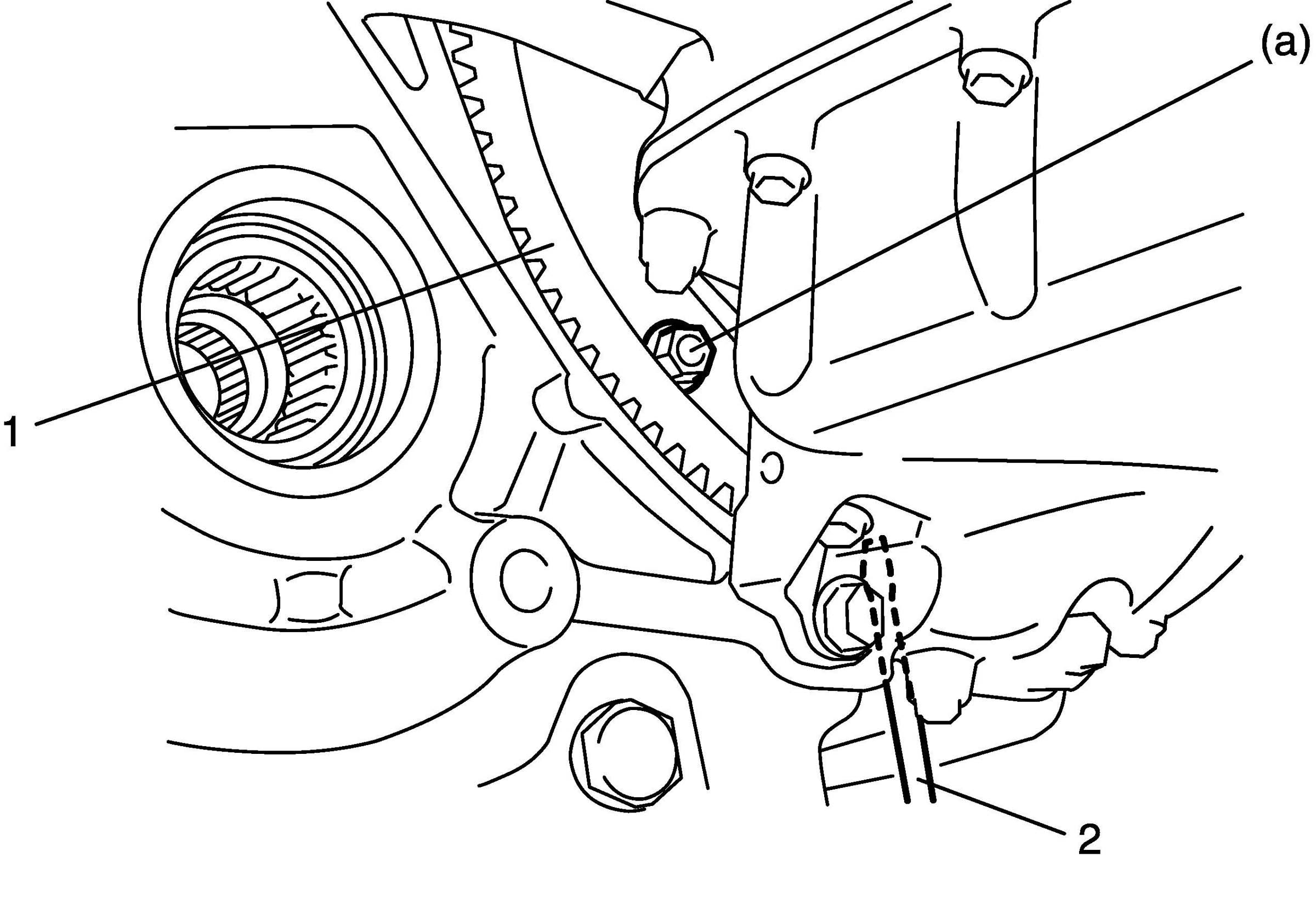

3. Tighten drive plate-torque converter bolts.
Align drive plate bolt hole and torque converter through then tighten bolts through torque converter housing lower plate opening.
Lock drive plate (1) by engaging a flat head rod or the like (2) with drive plate gear.
Tightening torque
Drive plate to torque converter bolts a: 23 Nm (2.3 kgf-m, 16.5 ft. lbs.)

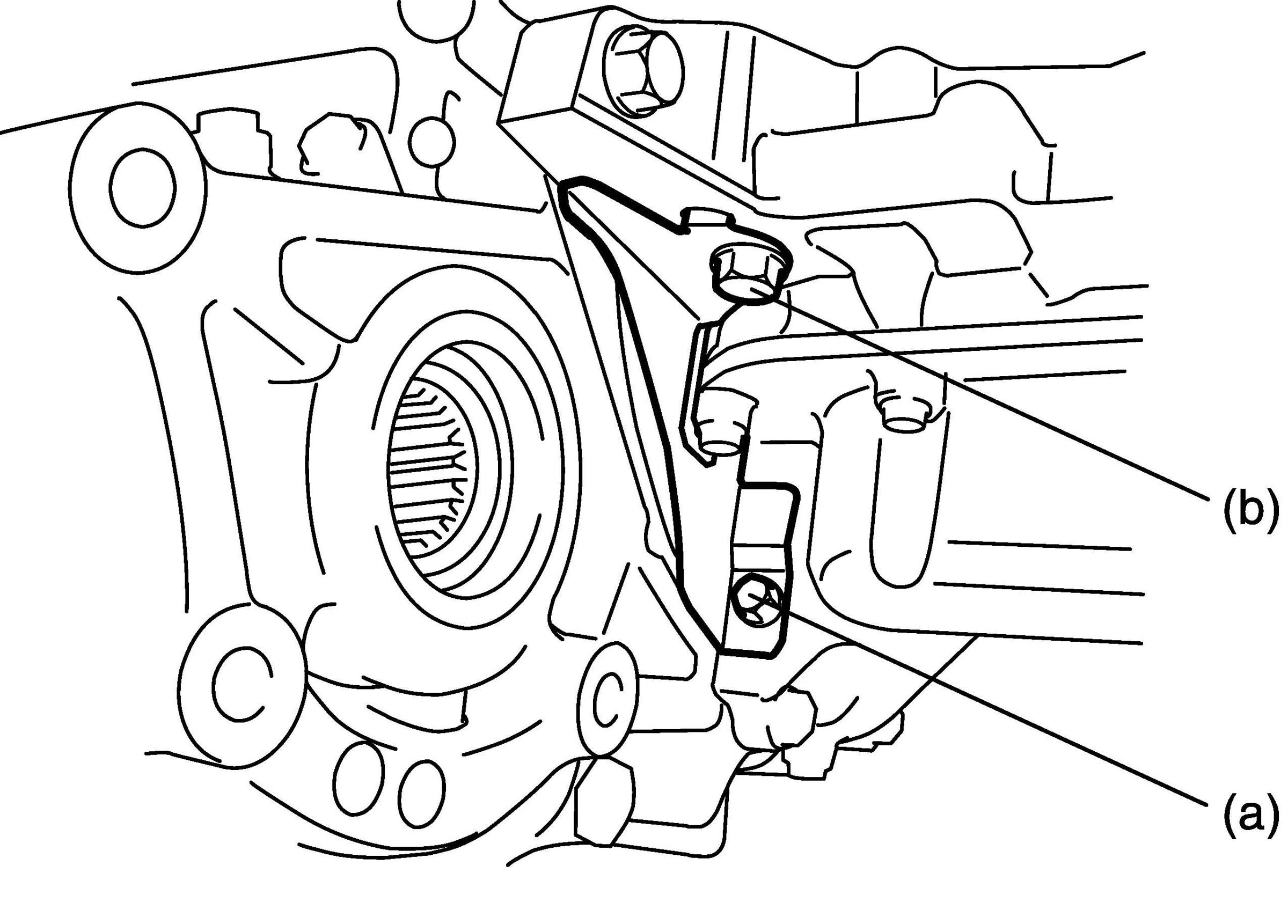

4. Install clutch housing plate.
Tighten clutch housing plate bolts (a) first and next (b) with specified torque.
Tightening torque
Clutch housing plate bolt (M6) a: 11 Nm (1.1 kgf-m, 8.0 ft. lbs.)
Clutch housing plate bolt (M10) b: 30 Nm (3.0 kgf-m, 21.5 ft. lbs.)
pic 7

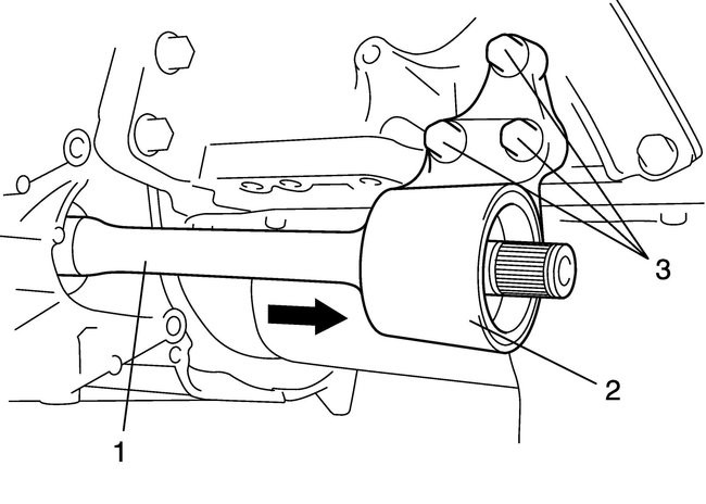

6. Install center shaft (1) to differential gear (for 2WD vehicle). Tighten center bearing support bolts to specified torque.
CAUTION: Be careful not to scratch oil seal lip with center shaft while inserting.
