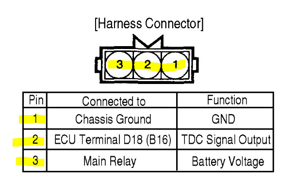

I have setting cam sensor code, checked wired and have ground and 5 and 12 volts, wires was cut when I got car and believe I got them in right ,but confirmation would be great, install new aftermarket cam sensors from different venders and same result, car will start and run for 3 seconds, seen in older post on here someone had same issue and they had to get sensor from dealer, could you confirm wire layout for cam sensor plug ? Any help would be much appreciated. thanks, Tim
