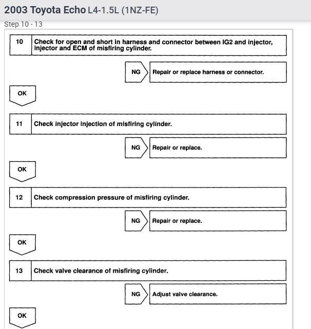

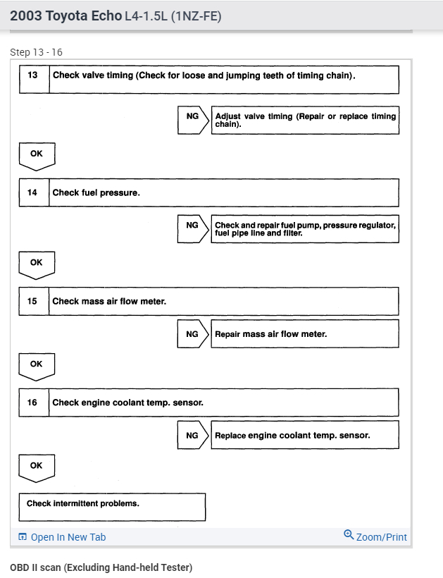

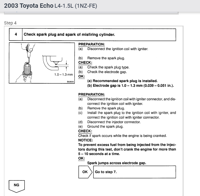

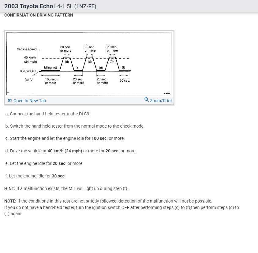

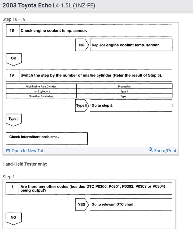

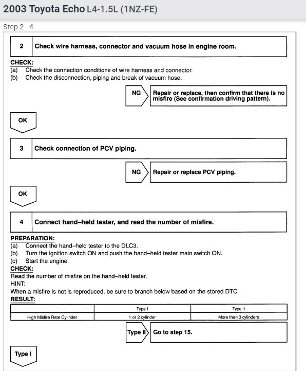

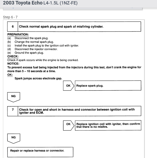

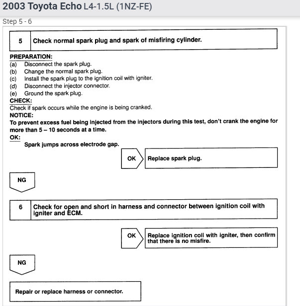

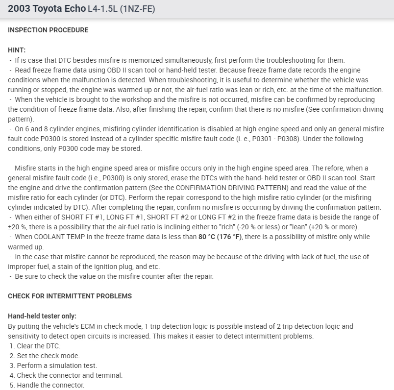

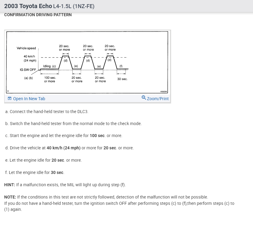

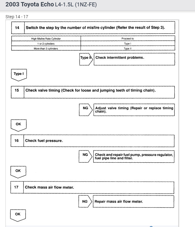

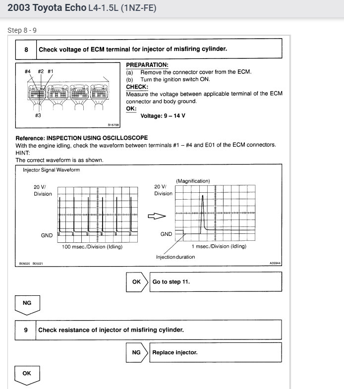

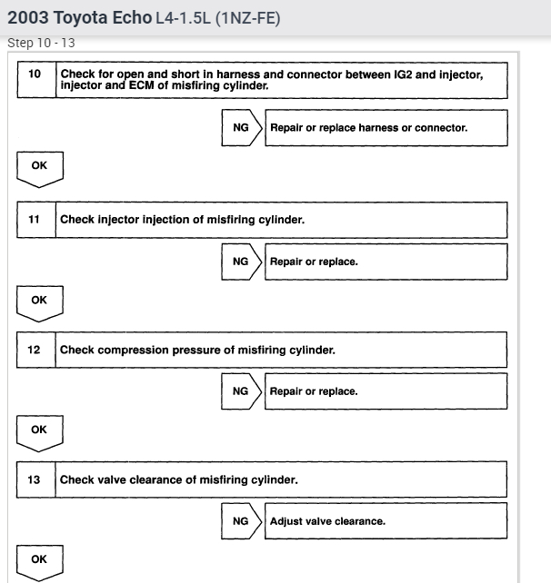

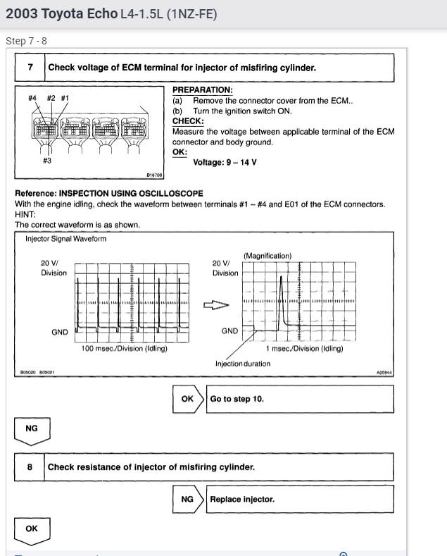

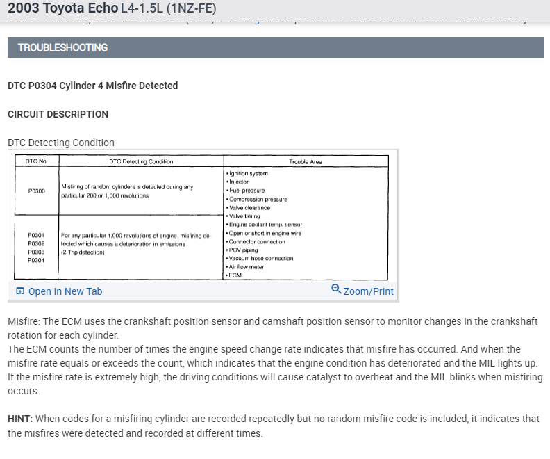

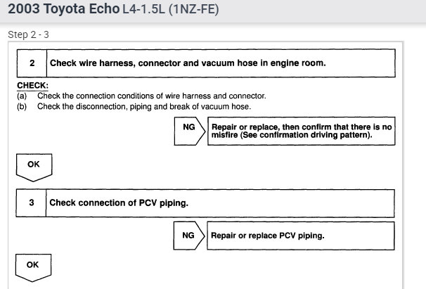

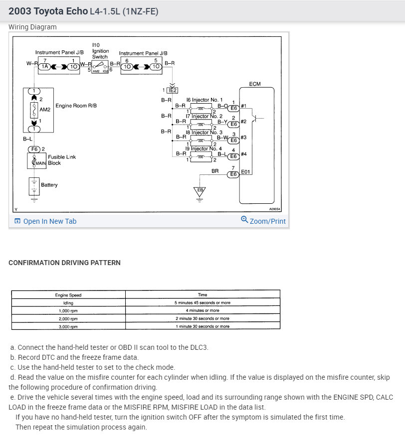

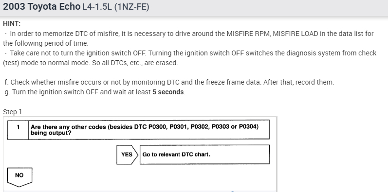

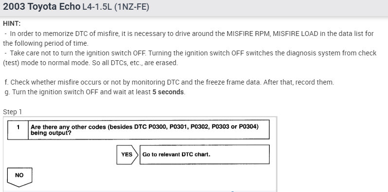

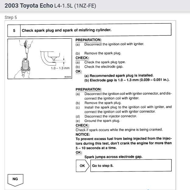

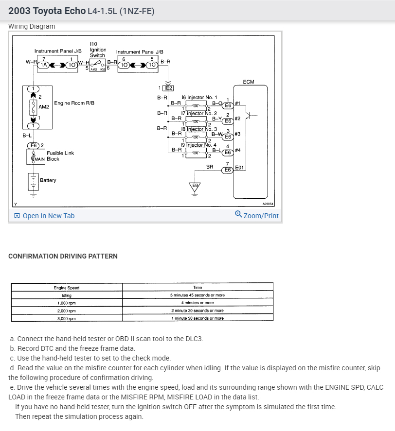

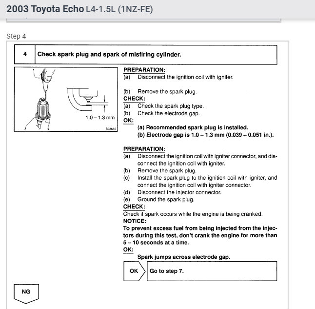

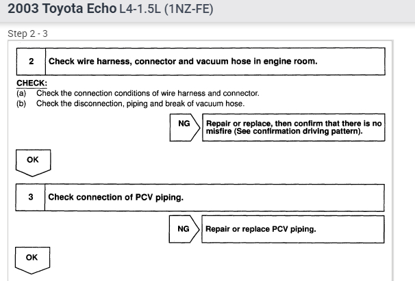

The code P0304 is a misfire code for the cylinder number 4.
This code can get triggered due to a faulty spark plug, improper fuel pressure, vacuum hose issue, bad fuel injector, faulty coolant temperature sensor, it can also be due to the ECM.
I have attached the troubleshooting guide for the code P0304 below. Follow those steps as it can help you determine the issue.
Let me know what you find or if you have any questions.
Thank you.

Thanks for that info. Looks like diagnosing that is going to be a bit above my skill level.
