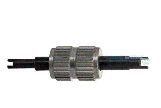

The valve core in the fuel pressure port is similar to the valve core in a tire. There are tools made specifically for them. I attached a pic below, so you have an idea of what it looks like.

See pic below.
